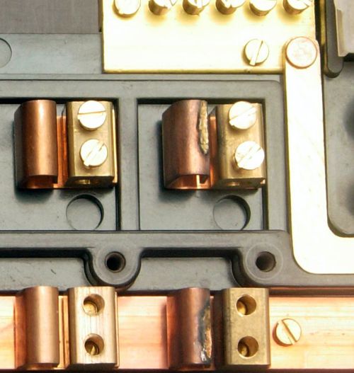

I'm old enough to be familiar with the old Standards that were designed for fuseholders intended for circuits up to 30a, where some of them had an extra-rated position that would accept an oversized 40A fuseholder for a large cooker or electric shower.
I mentioned to someone the other day that the 40A MCB fitted to their Standard in a 30A-max way was incorrect, and was surprised when they they showed me their recent EICR which made no comment on it. There was also no comment on the single 30ma RCD in the tails, which will cut off power to all circuits, including lighting, when it trips.

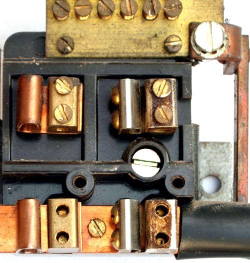

As far as the 32+ breakers/ fuses in 60A Wylex boards go, I have always marked them at risk. The tabs on the shields are there for a reason, either they are fitted and are wonky or the installer has to nibble the tabs off. Either way, they know damn well it's not right!
This is what the high current version looks like - note the cutout next to the top right terminal for the matching tab on the shield, and that the terminals themselves are a different design to the others.
and this is the normal version, maximum 30A, that someone had shoved a 40A or higher into. No cutout for the tab, terminals of the same design as the others, and considerable damage due to the excessive current.

Well I started in the late 60's early 70's and until flame ports post I did not know there was a high current version of the fuse box, however I have never tried to fit a fuse carrier over 30A in that type of fuse box, so never looked at a 40A MCB, in the main old boxes have MCB's replacing the fuse today, so they are not removed under load, so unlikely to arc.

I think the 40 was orange, i recall they even made a Green 45A one.
I vaquely recall they had 60A on the main switch
Doing a lot of old pub work, we often encountered bigger fuses fitted wonky with the Tab still on or with the tab cut off, or a few times with the back shield just left off.
