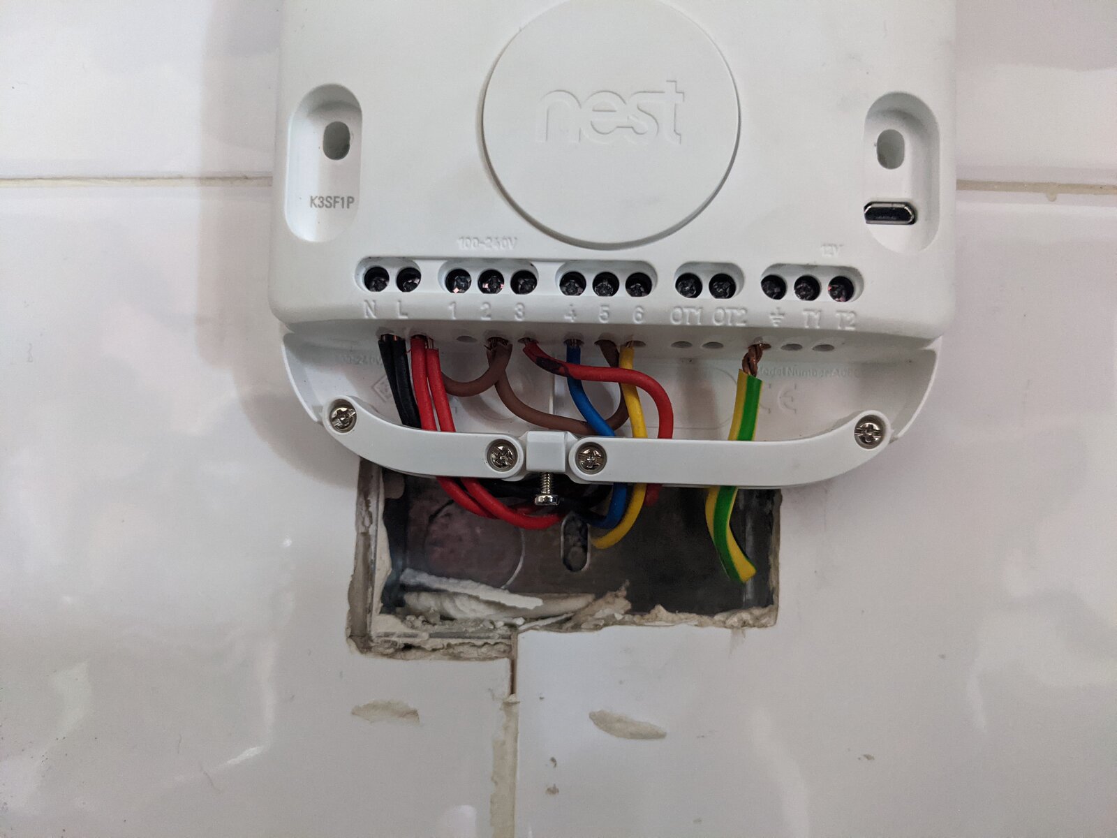

Hey Guys,
Sorry I know there's been lots on here about nest and y plans. I thought I knew what I was doing but seems nothing I do works when it comes to boilers.

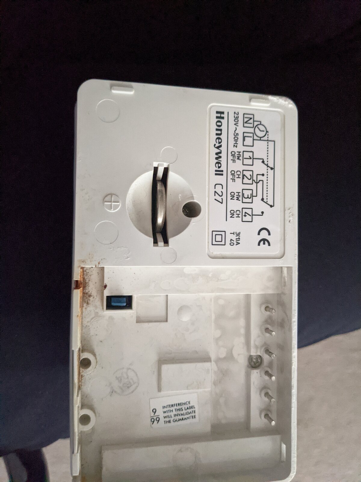

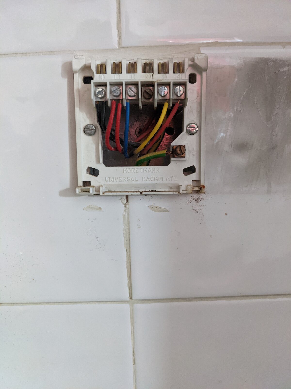

So, I have my third gen with 3 way valve control. My old unit was a c27 Honeywell control.
C27 standard type backplate. Neutral, live, hwoff(1) hwon(3) Chon(4)
On the nest I did the following - moved Chon(3) moved hwoff(4) moved hwon(6) bridged live to port 2 and 5. Added the neutral, live and earth terminals.
I thought great done, setup my nest flicked on hot water yeah it fired (oh no central heating is on) (turning up temp does fire the boiler and put heating on which I expect)
Initially the old thermostat was set to 0 in the hall way and nothing worked, I turned it to max and it kicked in so I thought oh I can blank that in the future (just leave at max for now) and allow nest thermostat to control heating and water.
To summarise I can't have hot water only without the heating and it's driving me nuts. - what does the "hot water control on/off" do in the nest app? I've turned it off.

First of all I think you have your programmer confused. C27 is a Horstmann product not Honeywell. However from your description, and assuming that the 3-port valve is working correctly:
Check you have moved all of the wires correctly and that the conductor (and not the insulation) is securely fixed under the Heat link screw. Heat link terminals can be tricky even for those of us used to them.
C27 N = Nest N
C27 L = Nest L
C27 1 = Nest 4 (Hot Water Satisfied)
C27 3 = Nest 6 (Hot Water Call for Heat)
C27 4 = Nest 3 (Heating Call for Heat)
Link Nest L to the two common terminals 2 & 5
Existing room thermostat set to Maximum.

Thanks! I'll double check wiring when I get home this evening. I know it sounds stupid but the screw on the nest pinches the wire from a bottom up position so just make sure it get pinched in that gap?
Also yeah I thought it was Horstman when I googled it. But the one I have definitely saying Honeywell C27 but it looks pretty much identical to Horstman so not too sure what's going on there.
Looks like I have my cabling correct though!

Added all the pictures below if someone can confirm. My link cables are brown.
Cheers,
Chris

Damn.
Think I have wired wrong due to it being gravity fed which I assumed was Y plan.
Does below look legit? The only bit that doesn't look right is link 3-4 as well. When CH is on HW needs to be on too.
You can do it without a relay if you do the wiring to the nest slightly different.
Connect L and N as normal
Link L to 2 and 6 (instead of 5)
Connect pump to 3
Connect boiler to 5 (instead of 6)
Then also link 3 to 4
This way when you just set heating it will fire the boiler up as well as the pump.

Y-plan has a mid-position 3-port valve, as you've said. When HW is called, the valve closes to the rads and sends hot water to the cylinder coil. When CH is called, it closes to the cylinder and sends hot water to the rads. When both HW and CH are called the valve moves to mid-position so both cylinder and rads get hot water. That's if everything is wired up correctly.
Okay. If that's the case then why would heating come on when I press water. And nothing happens when I turn heating on?
The C27 on the back of it told me which wires went where so I just followed the right instructions.
