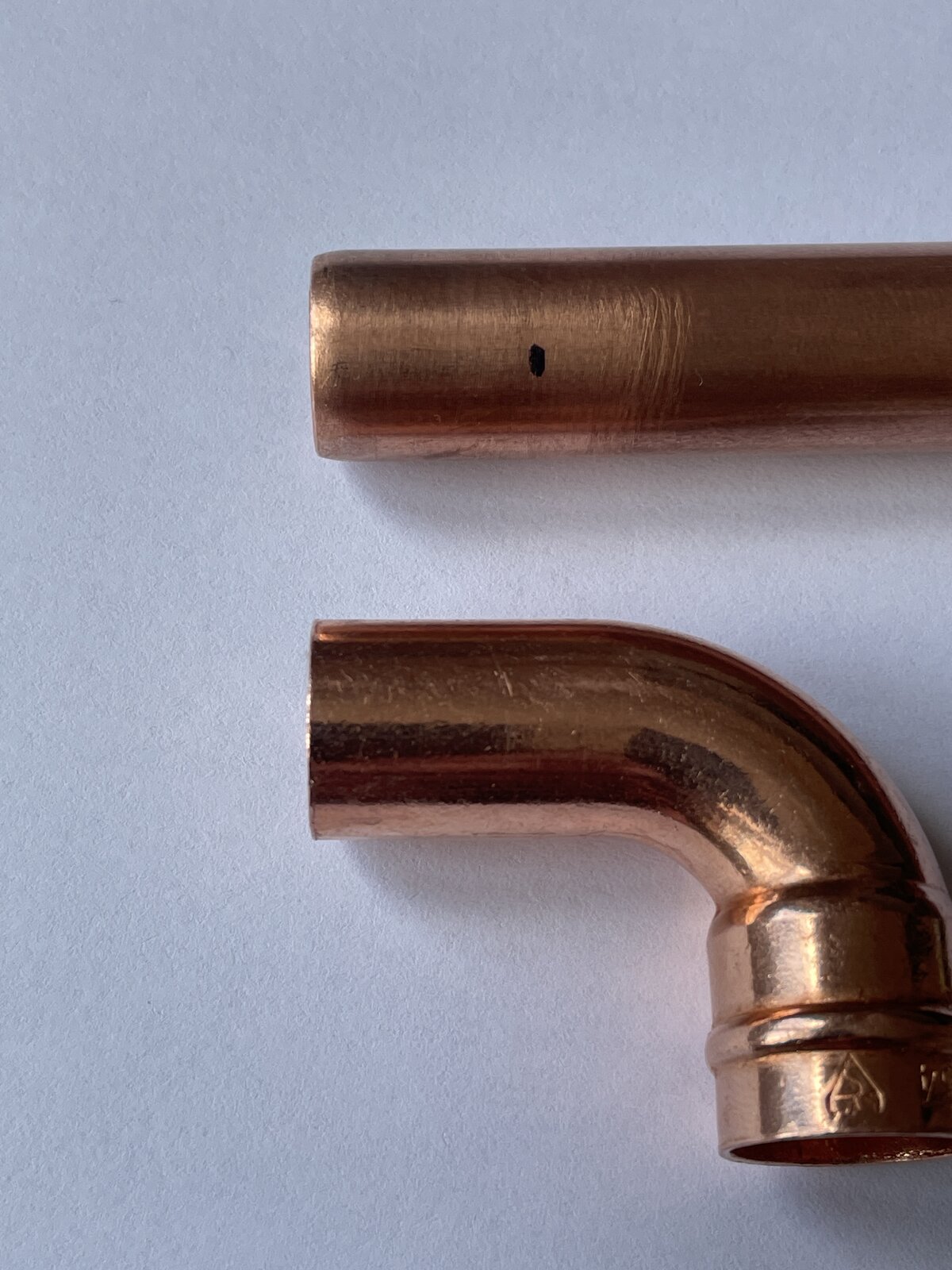

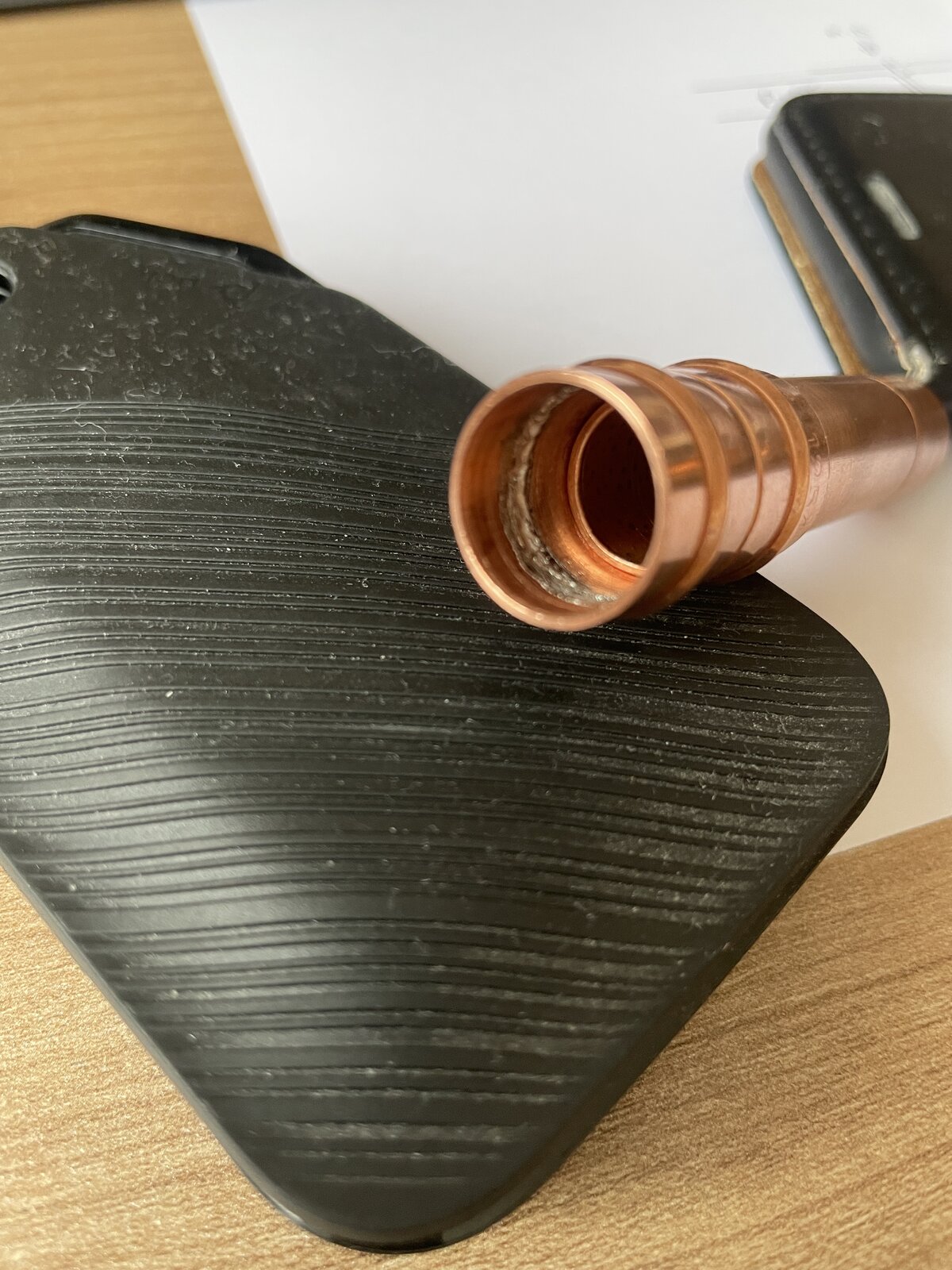

So quick update as I found what the issue is
Simply it seems to be due to the pipe slice that I’ve used
It’s a rothenberger the same as this one :
Pipe cutter
If you can see from the attached photo, it looks like it gives it a very slight chamfer on the end meaning it’s slightly passes the midpoint thus when you’ve done both pieces of pipe with the same cutter there is effectively a dip which is what allows the coupler to move back-and-forth
Considering I’ve used these many many times, it’s the first time I’ve noticed
I guess it’s not a major issue, but frustrating all the same
As you can see from my photo, the street elbow which I purchased has a completely flat cut end and when I put two of these onto the same coupler, it doesn’t move
So my question to you guys is what pipe cutter do you use And does it give you a nice clean cut with no chamfer ?

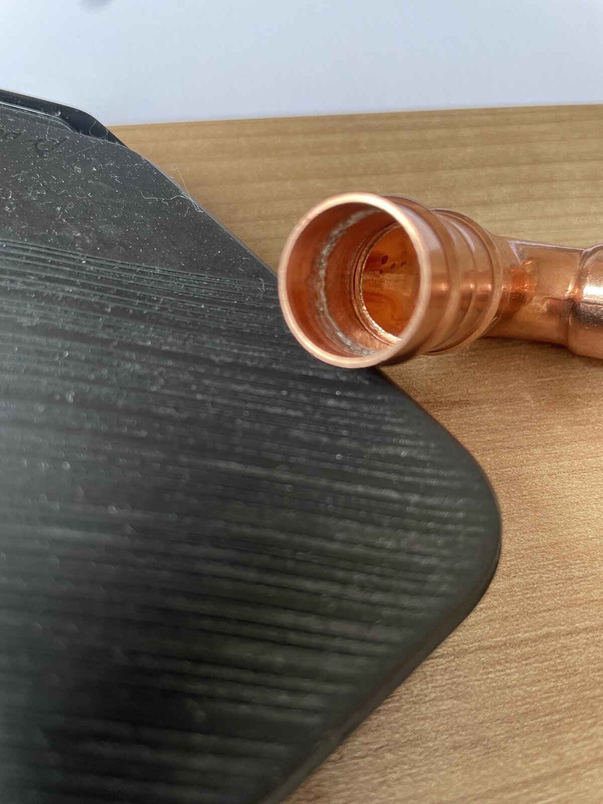

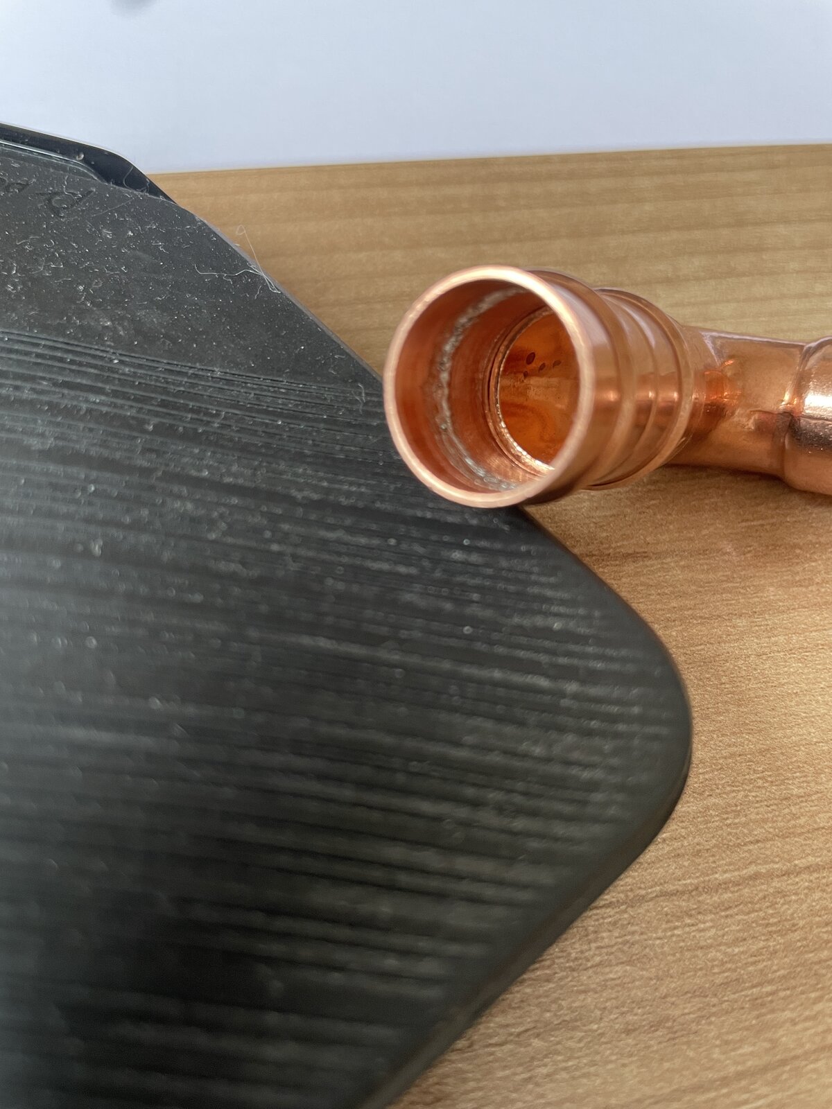

As you can see from the photos I’ve attached the one where it has a street elbow and a nice straight clean cut. You can make out the midpoint within the coupling however with the cut that I’ve done on a separate piece of pipe because of the chamfer, the circumference is slightly less meaning it goes past that midpoint
It can be the only explanation in my head
Elbow/clean cut/midpoint visible
Chamfer

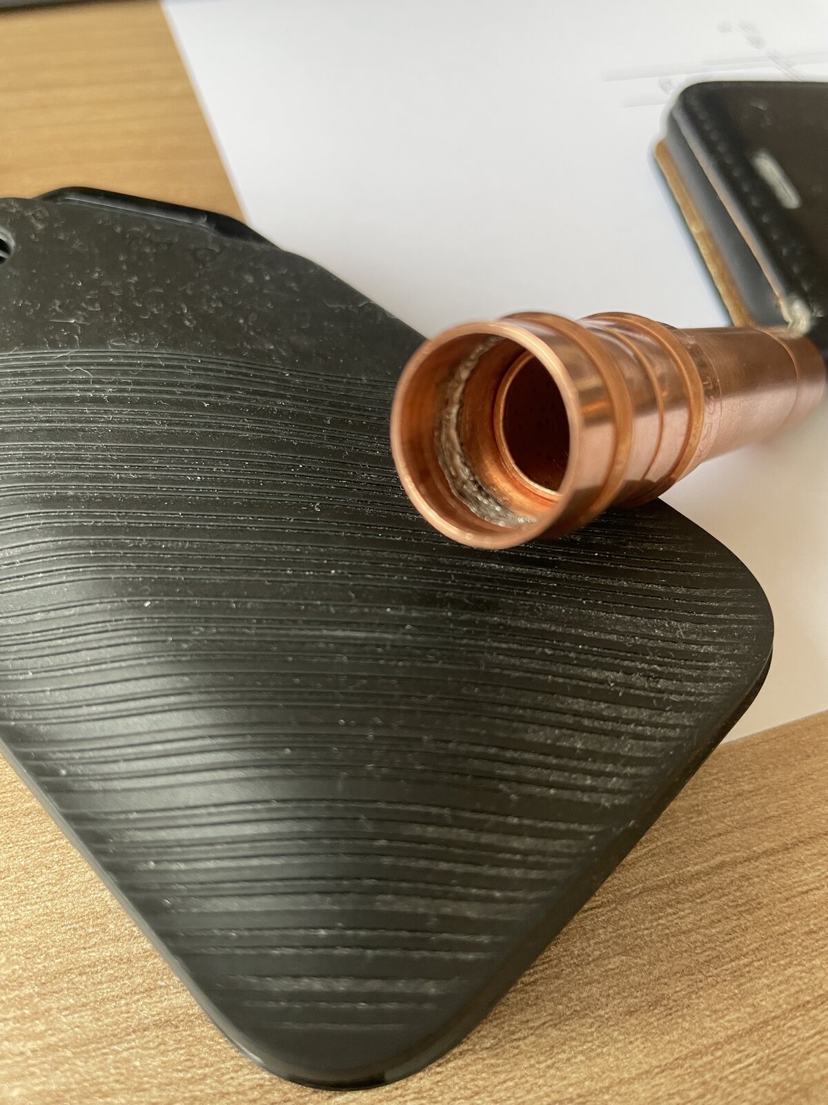

Chamfer
The pipes might be touching in the middle but the ends of the pipes are deformed so much that there is still a gap for the fitting to move. That's much more than a chamfer though, your cutters aren't right.
As Rob says though, it really doesn't matter anyway.
