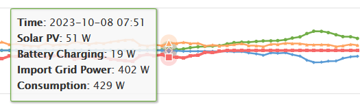

But with one hand they are asking us to use more electric with heat pumps and EV's and with other hand they want to reduce what we are using, I know batteries can smooth out our demand, but this has nothing to do with 'Smart' meters, I know when the red line lifts to the zero point I am running on solar
so from 8:20 am today I have not been drawing from the grid, neither have I been exporting, but I can see all this without a 'Smart' meter, so what does the 'Smart' meter tell me which I don't already know? Would be interesting to see some ones graph from their 'Smart' meter, yes my SCARTA suffers from delay, I am not really charging the battery at 19 W at same time as importing 402 W one is direct and other is from a server so the time delay shows as some anomalies. So I am told anyway.
