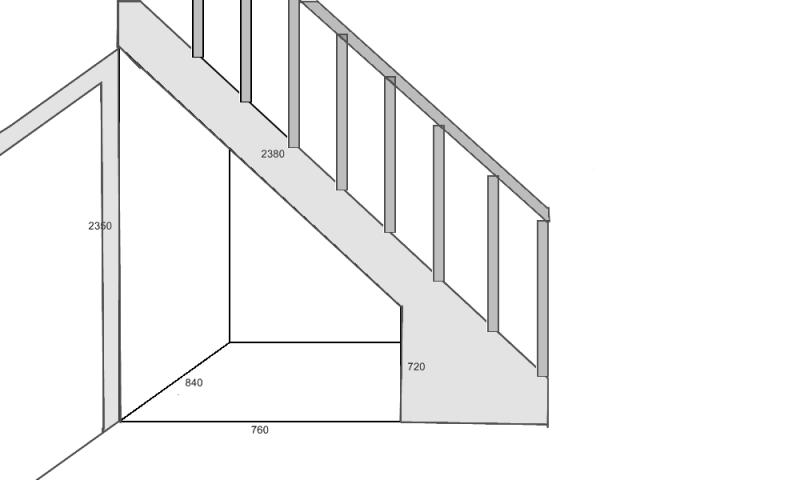

Hello all,
I'm looking for a bit of advise please. I'll explain the problem, show you how I think I might be able to fix it and you can all tell me how wrong I am and tell me how it should be done.
Problem:
I'm hoping to block in under my stairs, to create a large cupboard, I need a reasonable size door since I need to store big things in there (like musical instruments). See pic for shell with dimensions (even a rubbish picture speaks a thousand words):
The issues: Although this needs to be a solid structure I want to damage the laminate flooring as little as possible. The house is in a shared ownership scheme (with a housing association) so I have to be careful about things like that.
My Idea:
So my idea is to use two pieces of 2440x1220x18 MDF board and basically panel it all in. Cutting a door out and putting it on hinges with a small subtle handle, I would then finish with a white gloss paint to match the stair case...again, see bad picture(colours for clarity only):
My Questions:
Is this a good idea? (is there an obvious alternative)
I'm good at DIY and woodwork but have never done anything that actually requires "Structural" type work. Since this is almost a temporary wall type project (but don't want to go down the stud wall route)
If this is a reasonable plan, what is the best way to secure the wall/cupboard? Is there a clever way to do it which would allow the least amount of flooring fixtures?
Please share your ideas and ask if I need to clarify further

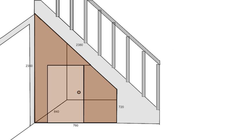

2. The Door:
Ok so here is where the main trade off is.
I want the door to be big enough to get stuff in (it maybe too small in the picture above) but as ^woody^ said it will be pretty heavy. In the picture above I made it as big as possible but with out having to have an angle in the door (since this would make opening/closing hard). A trade off may be to cut one corner off (not all - see the picture below) which would mean that the far left corner is still flat so would make the opening angle less of a challenge. So now I have the problem of hinging this heavy mdf door onto a temp mdf wall (sounds scary) but I'll have a look at what hinges are available (any suggestions?)
My drawings are all to scale and the door is the width of a standard internat door, does it now look too heavy?

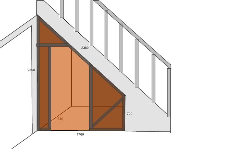

3. The Frame
Also see in the picture below a suggestion for a frame. I've heard that if I built the frame out of a different wood type (i.e. timber instead of mdf) without balancing it with an identical frame on the opposite side (not possible) then it can actually make warping worse as the two wood types expand/contract at different rates with heat/humidity. Would it be feasible to build the frame out of the same MDF since I would have quite a bit left over?
Would I be better building the whole thing out of a different material (i.e. not MDF) to reduce the chance of warping?

A door pivots from its hinge. There is no problem with chamfering a corner- it will still open and close.
The short answer to this is to bear in mind that some sort of timber frame should surround the MDF panel to provide stiffness - you can decide what is required. There will be no issues with differential movement of the two materials.

You can have a pair of doors this will reduce the weight and you will be able to use normal push to close concealed cabinet hinges (like those that are used on kitchen and wardrobe doors). I would recommend that you use a minimum of 1½ pairs per door. You will need hinges that are suited for inset doors not overlay doors.
I would also go for option 3 as the stair string is used as the door stop thus being a lot easer to fit.

Don’t use a timber framing around the internal face of the doors there is no need just look at the mass produced wardrobe doors. Do they have timber frame work? Plus if you glue a timber frame to one side only the door will warp due to there being no balancing frame.

you can if your careful and do a pilot hole screw piano hinges to the face of mdf without any problems
you can do the same to the edge but your hinges will protrude by around 6mm
why not have the minimum practical door and an easily removable section for the occasional bigger item!!
