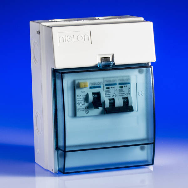

Need power supply to summerhouse and workshop.
The summerhouse have 6 downlighters (50 watts) under the soffit,4 wall lights internal (40 watts)+ 2 double wall socket for light useage and the workshop have 2 strip lights + 3 double wall socket for power tools etc and a single waterproof wall socket outside.
The summerhouse is approx 10m away from the building C/Unit.What supply cable size+ amp size + unit do I need or anything I've missed out ?
Will get sparky in to check my work and final connection etc...

4mm 3-core SWA would be best (2.5mm is actually suffient for the load you will be drawing but go for the 4mm) terminated in a MCB at the main CU in the house with a shed/garage cu fitted in the summerhouse
The unit can be bought from screwfix for £30, a bit cheaper than TLC are selling it for...
Thanks for that,
Does this unit have some sort of name for this so people know what I'm talking about and not make me look a dimwit :? :oops: :)
Looks like a 2-way (4module) IP65 consumer unit using an RCD as a main switch. You may want slightly more capacity than this and I would always make sure I had some spare capacity, even if you don't need it now, it might be useful in the future and the cost difference will be small. As suggested, 4mm would be a good choice with a 32A MCB.
it is known as a garage unit it comes with a 30ma RCD 1x16a and 1x6A although you might want a 32a mcb iam not sure if you can chage the mcbs in this
