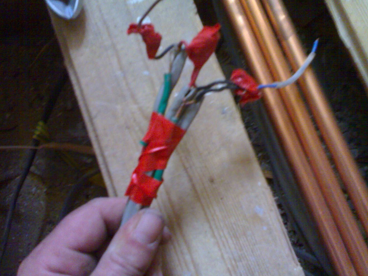

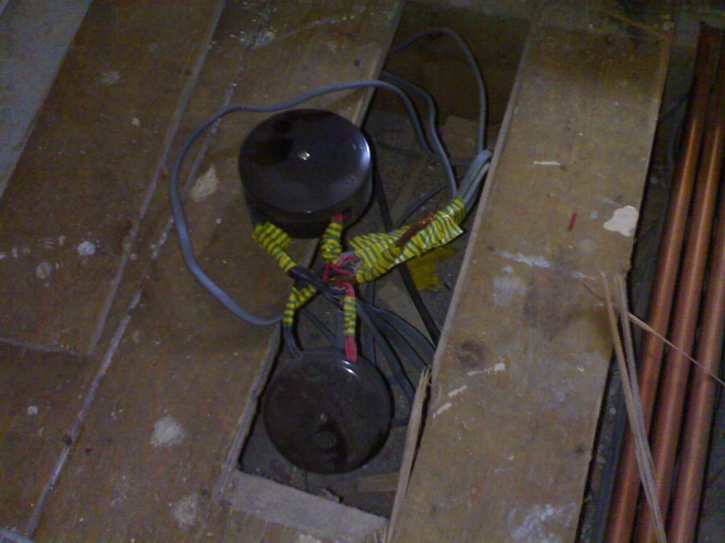

How not to make off the junction box for your wall lights
Oh and this was fed from a joint box straight off the ring! :shock:
Neutral not long enough to reach the terminal?
Simple, one strip connector and a bit of RED 2.5mm2

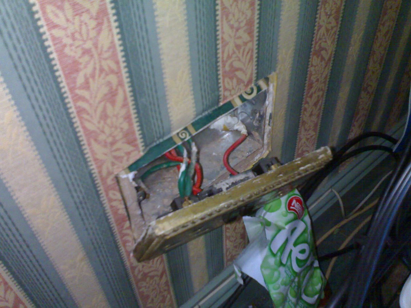

Job Done :shock:
This was used to connect a class 1 light fitting.

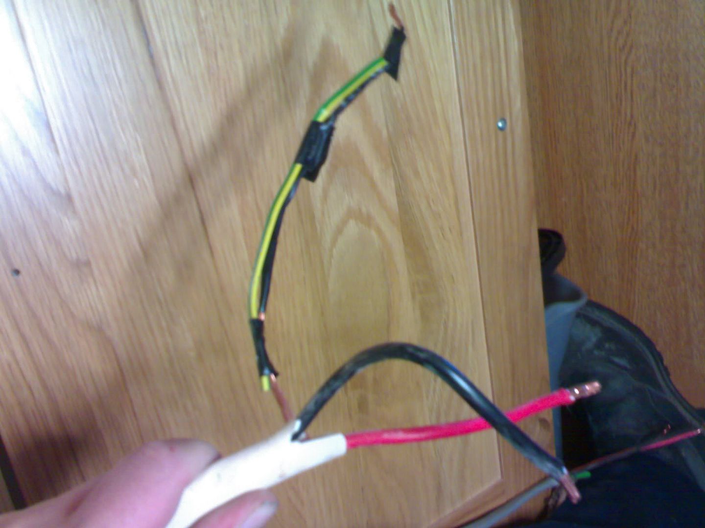

Inside the red tape are the little brass strips from a butchered ceiling rose?
Earth sleeving too thin for the cable? Simple just tape it to it!

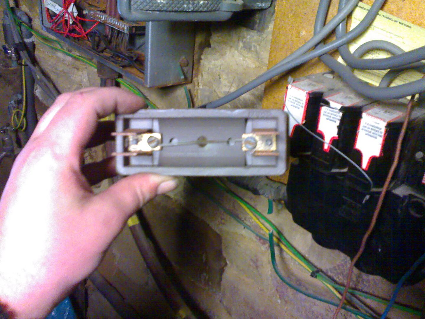

And from a local church:
Blown a cartridge fuse? Simple, two lengths of 30A fuse wire.

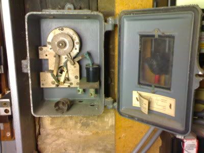

This one is not too bad, Just old.
This is an old time clock that has to be wound by hand every couple of days. The little round black bits on the right are pots filled with mercury :shock: to make the electrical connection!
