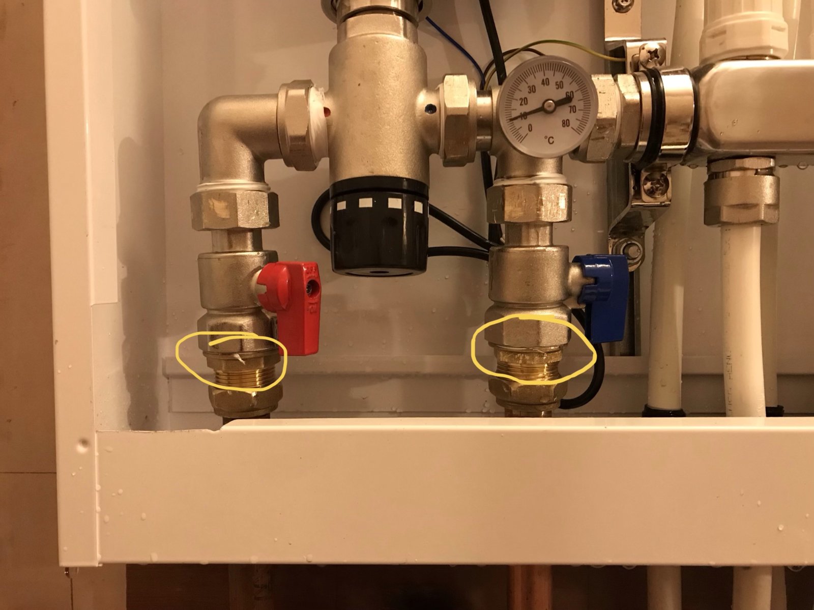

I’ve got 1” straight connectors to connect my 22mm flow and return from the boiler to my UFH. I’ve tried several times fitting them to the manifold inlet but they keep dripping. I’ve used PFE tape... am I doing something wrong? Photos attached.
Any help and advice would be great please.

How much PTFE have you used? You'll need about 20-25 turns on each fitting
Wind the tape to form a taper..ie. with more tape towards the back of the thread. Then when you tighten ensure the threads don't bottom out through lack of tape.
Blimey what a nightmare all those joints are on the manifold. I get one to stop weeping and then another one starts. Surely they are badly designed?! Any suggestions for the best way to do it if I strip it all down and start again? I really don’t want it leaking everywhere.
Are you sure the connectors mentioned are the main cause of the leaks ?, there is a lot of water droplets in the photo.

you only use PTFE on the two joints you have circled the others should have washers and no PTFE
