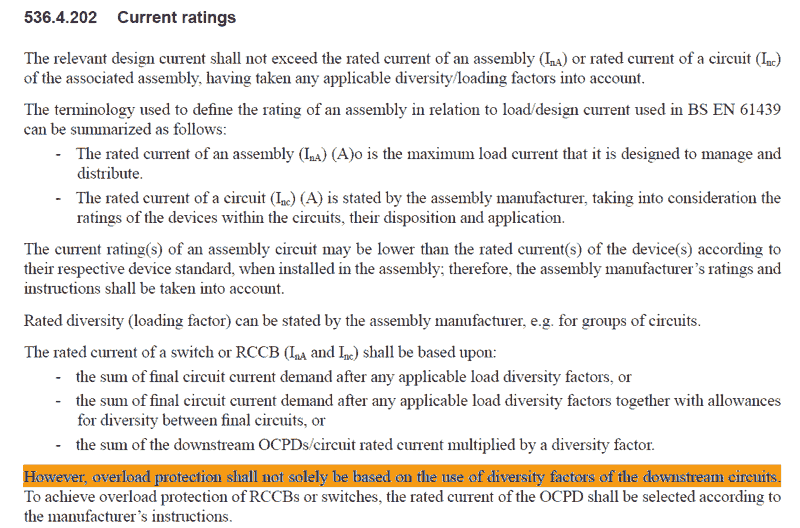

However, in terms of the OP's concerns, it's no different from Main Switches. They are usually rated at 100A, sometimes only 80A, but if one adds up the ratings of all the MCBs in the CU, it would not be unusual to get a figure approaching 200A.
RCD overload protection cannot be by diversity alone, so if the MCB total is more than the RCD rating and the main fuse is also more, it does not comply.
RCD overload protection cannot be by diversity alone, so if the MCB total is more than the RCD rating and the main fuse is also more, it does not comply.[/ATTACH]
Well, as I just wrote, if one temporarily forgets about "RCD overload protection" and instead considers "Main Switch overload protection", then I would think that, per what you have cited (highlighted), a high proportion of CUs "would not comply". Is that not the case?
Having said that, I'm not sure how one is meant to interpret the totality of the sentence in the reg you have highlighted together with what is said in the three options which immediately precedes that sentence/paragraph.
Kind Regards, John
You know I'm not good at cryptic clues but what does the last sentence mean?
Which is THE OCPD? Is it suggested there should be a single separate one to protect the RCCB or switch?
Which manufacturer? That of the RCCB or switch or the OCPD?
I'm glad to hear that it's not just me! As I wrote ...
... I'm not sure how one is meant to interpret the totality of the sentence in the reg you have highlighted together with what is said in the three options which immediately precedes that sentence/paragraph.
... and, yes, that question applies to the next sentence (which flameport didn't highlight), too!
Kind Regards, John

I have seen a few times where 63 amp and 80 amp RCD's have been used in a consumer unit where the MCB's would allow in excess of that rating, I don't think any overload would be long enough to cause a problem, however technically the RCD should be selected so over load is not possible, as to whom is responsible that is not so clear, a minor works certificate is not a legal requirement and it says "Comments on (including any defects observed in) the existing installation (Regulation 644.1.2):" the whole form is here and it is questionable as to what should be done with an old installation. However I would have thought a comment should be made as clearly could not enter the tripping time or current.

I have seen a few times where 63 amp and 80 amp RCD's have been used in a consumer unit where the MCB's would allow in excess of that rating ....
I would have thought that 'a few times' is probably an appreciable understatement.
63A RCDs are far from uncommon, yet it only takes a couple of 32A circuits ('just'!), or a shower circuit plus almost anything else, to theoretically overload them.
I think one probably has to be sensible, particularly with sockets circuits - the chances of two or more 32A circuits being 'fully loaded' simultaneously in a domestic environment must be incredibly small.
... and, as I said, what about Main Switches, where I suspect the opposite may well be the case - i.e. that you have only seen a few CUs where the sum of the ratings of the MCBs did NOT exceed the 'rating' of the Main Switch.
Kind Regards, John
Surely if there is a 100A main switch and a 100A main fuse then that doesn't matter.
As for RCCBs, doesn't the subject raise the question of why do they bother to make ones with a rating of less than 100A.
They are, quite surprisingly I think, a little bit cheaper but not enough to worry about.
You're getting dangerously close to talking about common sense, whereas flameport was quoiting the chapter and verse of a regulation, which is not necessarily the same thing :-)
I suppose that, strictly speaking, there is a theoretical issue (even if we feel we can over-ride it by common sense). A 100A fuse will allow appreciably more than 100A to flow 'indefinitely' and considerably more than 100A to flow for moderate periods (e.g. around 200A for 1 hour). If one held the view that any current appreciably >100A was unacceptable for a Main Switch 'rated' at 100A, then that could be an issue.
Kind Regards, John
It does. I've never really understood, but I imagine that the reason/explanation is probably 'historical' (and unthinkingly perpetuated).
Kind Regards, John

Yes as you say common to see 80A RCD supplying MCB's which add up to over 80A, the RCD has two current ratings, one momentary often 4.7 kA and one continuous the 80A rating and it would be unlikely you would get over 80A continuous. A B32A MCB should trip on the magnetic part at between 3 and 5 times the rating, so up to 160A before it trips in 0.01 seconds, there is a sliding scale below that, but seen many a 40 amp shower on a 32A MCB.
There are very few items in the house which can draw high current for an extended time, likely the immersion heater is the longest, followed by maybe tumble drier, it is recommended that items fixed at over 2 kW have a dedicated supply, and normally the immersion heater does have a dedicated supply, but the tumble drier rare, more likely to find the oven with a dedicated supply and the oven with use mark/space control to maintain temperature so in real terms draws high current for less time than the tumble drier or washer/drier.
