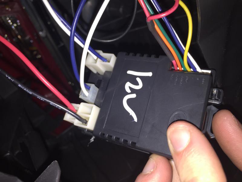

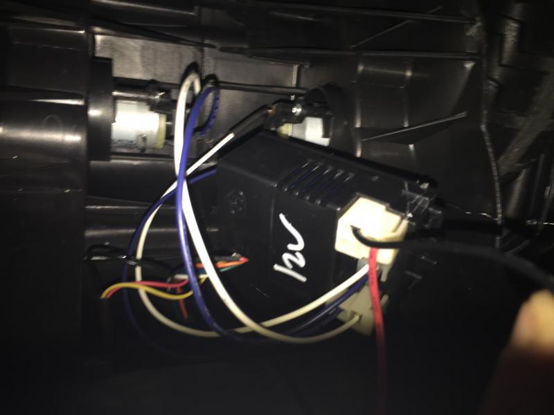

Hi guys I was hoping someone could help me with my sons bike, it doesn't appear to be charging and won't switch on...
I have a basic knowledge of things and how to use a multimeter but I just need pointing in the right direction of where to look..

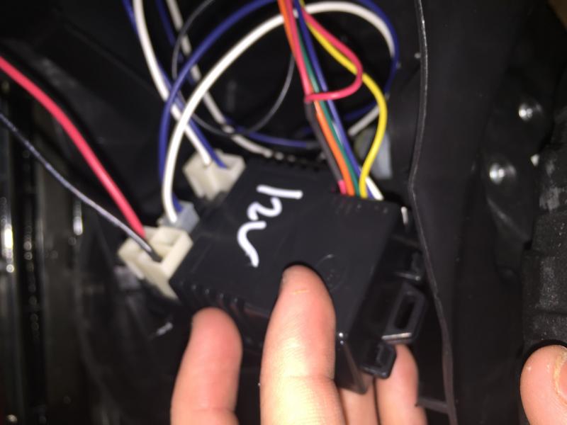

I have plugged the charger into the socket and the socket has a red, black and yellow connection coming off the back of it (see pics) when I was testing for voltage across them, I accidentally put the meter across the yellow and the black cable and the bike powered up, the on off on the bike works and the bike runs fine when those wires are connected through the lead.. (Or any metal creating a conductor) but as soon as I take it off the bike dies again..
I have also chased the cables back to what looks like a 12v switch or transformer feeding the other functions of the bike and which feeds the 2 6v battery supplies... (The red black and yellow leads plug into this)

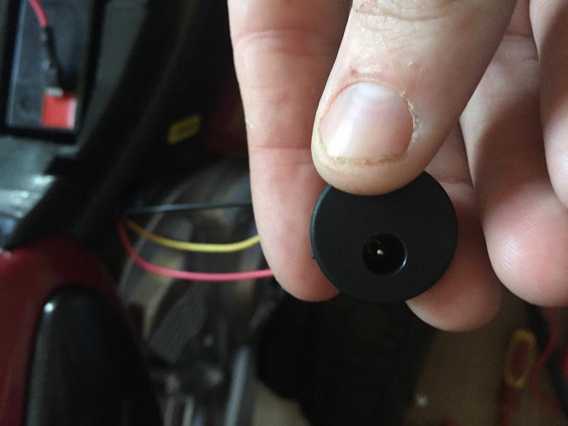

I know that the red is obviously positive, black negative shut Im unsure what the purpose of the yellow lead is.. I think the charger socket maybe faulty as the yellow and black cable should be connected at the socket and when I put metal across them it completes the circuit? Is this correct...
Otherwise could anyone maybe point me in the direction based on these pictures??
Thanks for your help!

The yellow wire is used to prevent the motor running when the charger is plugged in.
When the charger plug is inserted, it breaks the contact between yellow and black. When the plug is removed, black and yellow are connected - or not in this case as the socket has failed internally.
You need a new socket. They are readily available, such as these: http://www.rapidonline.com/Cables-Connectors/Connectors-Mains-Power/DC-Power-Connectors
There are several different sizes of plug.

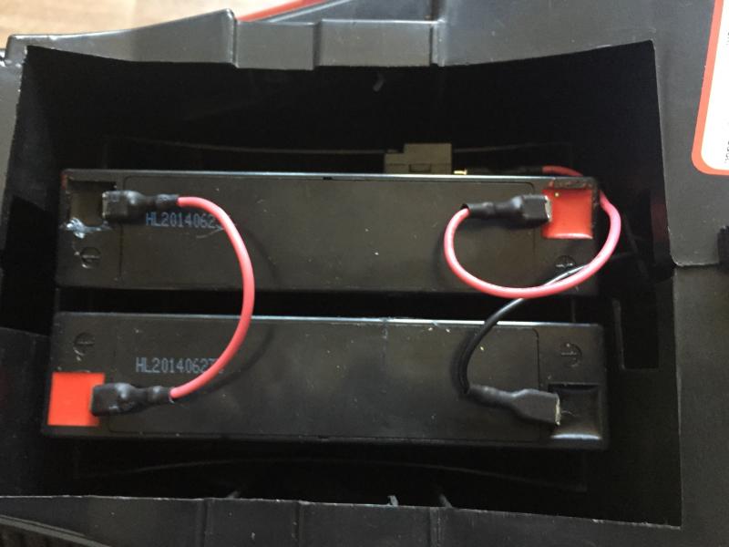

Across battery 1 + to - I get 6v
From battery 2 I get the same
If I do + to - across battery 1 to 2 I get 12v on the side that goes off into the bike
If I do the same across the other end which is just a looped bit of cable I get 0 volts (may have to check picture to understand what I mean )
As for checking with motor on Im not sure what you mean as unit is dead without charger in, but I've tried it whilst pressing the foot pedal and with the on off switch set to on, and it makes no difference the unit remains dead

Yea regardless of what I press or don't press, or even if I disconnect the leads and just check the terminals of the battery's I still get 12v (6v each batt)
I've tested the voltage up to the (vcc) part of the little pcb ( the connector with the Orange, red, blue white etc on it ) box too and I get 12v at that stage aswell
I also get 12v at the red and black connector that comes directly off the battery at that point aswell
(Hope all that makes sense)

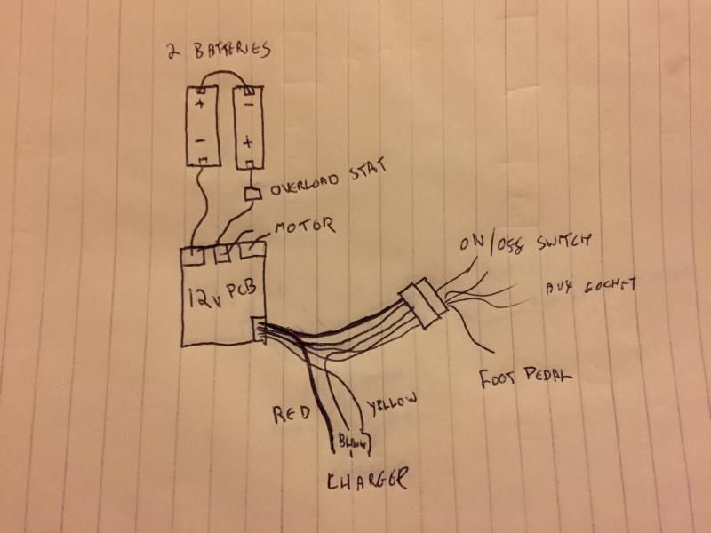

I've drawn a diagram of how I've chased the wires so far, hope it can be understood, it isn't in wiring diagram form or symbols due to my lack of knowledge in drawing them 😂
Well, what I would now probably do would be as follows:
With charger not plugged in and with the black and yellow joined at the charger socket, confirm that there is about 12V between the left-hand two terminals on the 'PCB' (i.e. coming from battery) and then determine whether there is any voltage between the right-hand two terminals ('to motor') when one attempts to switch the motor on (the 'on-off switch', I imagine).
What does the foot pedal do?
Kind Regards, John

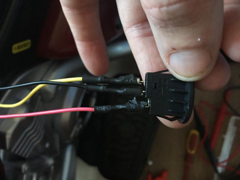

I am getting 12v going off the pcb to the on/off button.. The on off button is just literally an on/off switch for the whole bike, when it's working normally it's just a big round button that he presses to turn the bike on and off (it lights up when it's on and makes a sound.. All of which works when I switch the black and yellow wire and run it off the mains but doesn't when it's in a standard setup off the battery)
The foot pedal is what you use to run the motor he presses it and depresses it to move or not move.. Again this works when I'm getting a supply direct from mains but doesn't function when it's off the battery
-: I'm starting to wonder if im getting 12volts but the battery's aren't pulling any Ampage , which unfortunately my multimeter cannot check :-
I am getting 12v going off the pcb to the on/off button.. The on off button is just literally an on/off switch for the whole bike, when it's working normally it's just a big round button that he presses to turn the bike on and off (it lights up when it's on and makes a sound.. All of which works when I switch the black and yellow wire and run it off the mains but doesn't when it's in a standard setup off the battery) ... The foot pedal is what you use to run the motor he presses it and depresses it to move or not move.. Again this works when I'm getting a supply direct from mains but doesn't function when it's off the battery
Fair enough - but if (with charger not connected and yellow and black joined at charger socket), if you switch the switch 'on' and press the pedal, do you get any voltage between the two wires going from the 'PCB' to the motor?
That's why I asked you to check the voltage across the battery when you attempted to make the motor run. If it were a duff battery (or a battery which wasn't getting charged), it might have 12V across it 'off load', but that would fall to a much lower voltage when the motor tried (fairly unsuccessfully!) to draw current (amps) from it. However, you seem to have indicated that this did not happen.
