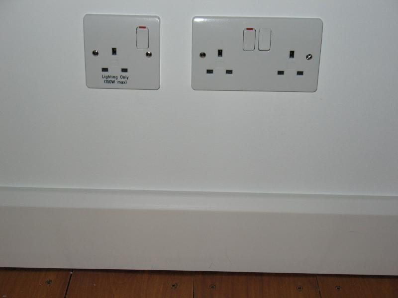

Perfect solution to the problem. Looks good, clear for all to see.
Of course, some prat will ignore it and plug god knows what into it - but you get prats doing other kinds of stupid things, so why go any further catering for these prats?
Engraving is the best way.
<a photo>
That's certainly the clearest way to label it. However, I have to wonder why there is such a (switched) socket adjacent to an 'ordinary' one (presumably on a standard 'power' circuit) - is it perhaps because (despite having a switch itself) it is 'remotely switched'?
Kind Regards, John
Perfect solution to the problem. Looks good, clear for all to see. ... Engraving is the best way.
Indeed so. However, unless such an animal is available 'off the shelf' (I can't say that I have seen one), I doubt that many people would go to the trouble and/or cost to get engraved labelling on a socket which was going to be in a loft,!
Quite so. It's fair enough taking steps (such as the labelling) to minimise the risk of 'understandable' (and not necessarily 'unreasonable') errors being made, but I don't believe in (inevitably unsuccessful!) attempts to make things proof against any sort of idiot!
Kind Regards, John
Perhaps it was a 2 or 5 amp socket controlled by a light switch originally.
Indeed - in fact, as I implied, maybe it's not only 'originally' - maybe it (perhaps together with other things) is still controlled by a light switch (or whatever)?
Mind you, if that were the case, one would ideally need more explicit/detailed labelling - otherwise people might get confused by the fact that, having plugged in a light and switched the socket on, the light still did not work!
Kind Regards, John

You could argue that when plugging in a 2 or 5 amp plug that the light switch has to be on.
We have to stop catering for prats.
Nothing is prat-proof.
I think I have to disagree with you here.....
Agreed - when it was a 2a or 5A socket (particularly if it was amongst 13A ones).
However, once that 2A or 5A socket was (as has been postulated) changed to a switched 13A one, I think it becomes far less obvious (indeed, 'far less likely') that, as well as having a switch of its own, it was also controlled by some remote switch, both of which had to be 'on' for electricity to appear. The labelling shown ["Lighting only (150W max)"] gives no reason to think that there is anything 'special' about the socket other than a maximum load.
We have to stop catering for prats. Nothing is prat-proof.
As I've said, I agree with that - but, as above, I don't think one would have to be much of a prat to not realise that "Lighting only (150W max)" also meant that some other switch had to be operated for it to work.
Kind Regards, John
You've got a socket marked 'lighting only'. There's a light switch in the wall.
That's good enough.
There's enough kitchens with unmarked switches peppered over the wall over worktops, and unmarked sockets under counters or in fridge spaces that don't appear to work.
They soon get it, unless they are TOTAL prats.
