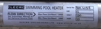

14kw pool heater ....What trip switch to buy for fuse box

It should be 53 so I assume that's what it is.
It is ...

Beside the point that you could easily overload the incoming HRC fuse when you include other expected electrical house loads, it is also not a cost effective way of heating a pool up in my opinion.

The design current using nominal voltage is 52.2A
A 10.5kW/240V shower at 230V is 9.66kW.
9.66 + 50% is 14.49.
