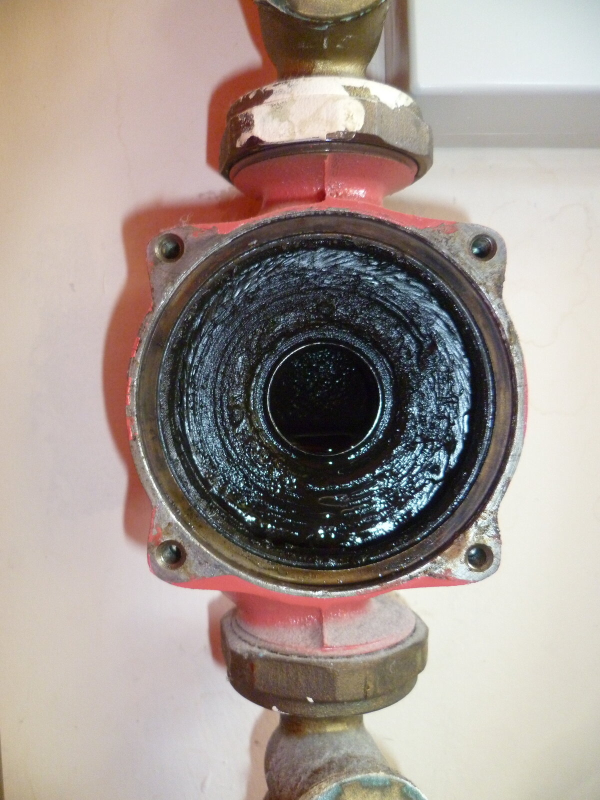

When I took mine apart with the same intention to swap the head this is what I found. So I also had to do battle with the gate valves, but in the end was not so bad. Luckily I had bought a complete new pump from a well known auction site (it was cheaper than buying the head only).
Hope yours is looking better than this!

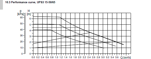

This will do the job for you, a UPS3 15-50/65, a 6.5M pump. Your original pump may have been a Grundfos Selectric or super selectric.

I have to say I am not too enthusiastic about your suggestion of UPS3 15-50/65 which seems an unnecessarily complex item, as do your earlier suggestions. I still feel I should get a straight forward bigger 2-3 speed variety. I don't see the point of introducing electronics into hot pumps, being an ex-engineer in the field.

You have 15 rads say 22.5kW total @ 1.5kW/rad, if you allow for a rad dT of say 12C then flowrate (probably max) required is 26.9LPM or 1.6M3/hr, the UPS3 will give this flowrate at a head of over 5M but the DAB will only give this at 3.8M both on constant curve ("fixed speed") 3.
I am also a ex engineer with ~ 40 years experience of all forms of pumping systems and I don't think you would regret going for a A rated pump, whatever your preferred manufacturer.

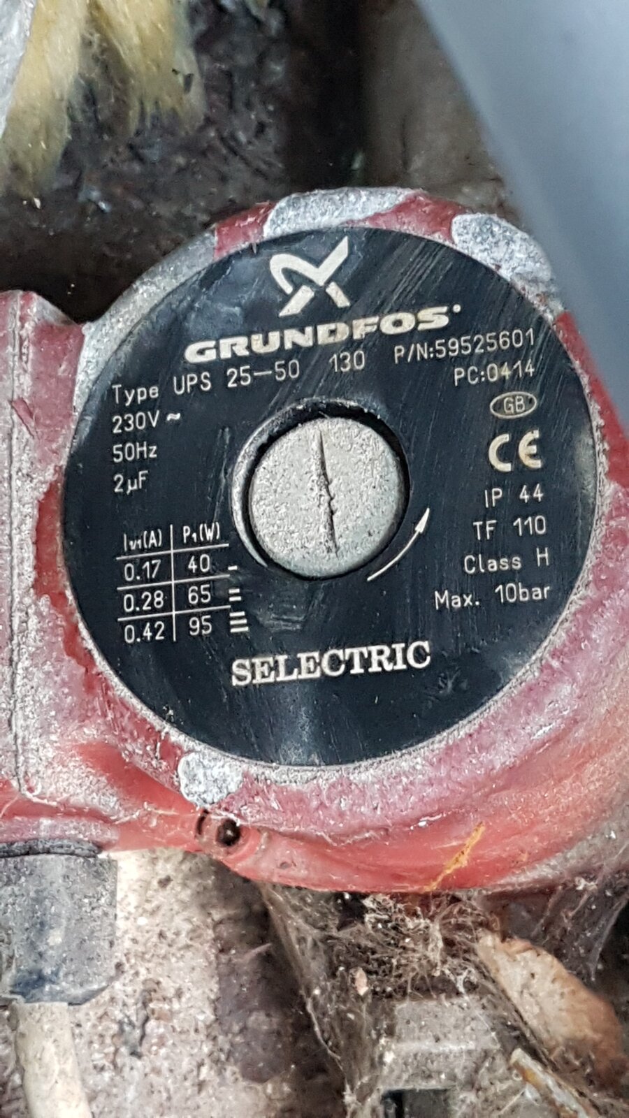

The pump that I installed (16 years ago) was manufactured 18 years ago, its actually a (5M) Selectric, you can see the year/week of manufacture on the label, PC:0414. You might post a photo of your one and we can try and establish its pump curve to match a new pump to it, IF this is required.
You can also see that it has a 2uF capacitor?.

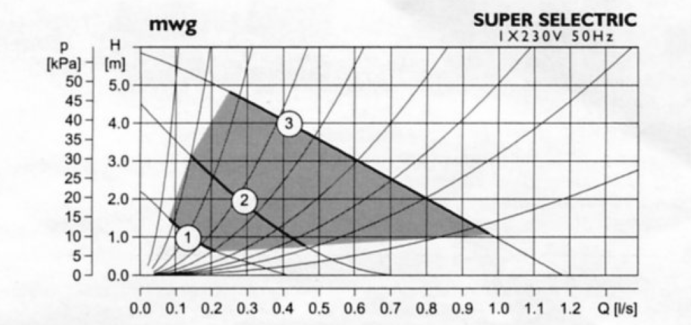

Edit: Found curves for a UPS15-60 95W Super Selectric so looks like a head of 3.8M at a flowrate of 1.6M3/hr. (0.44 l/s)
