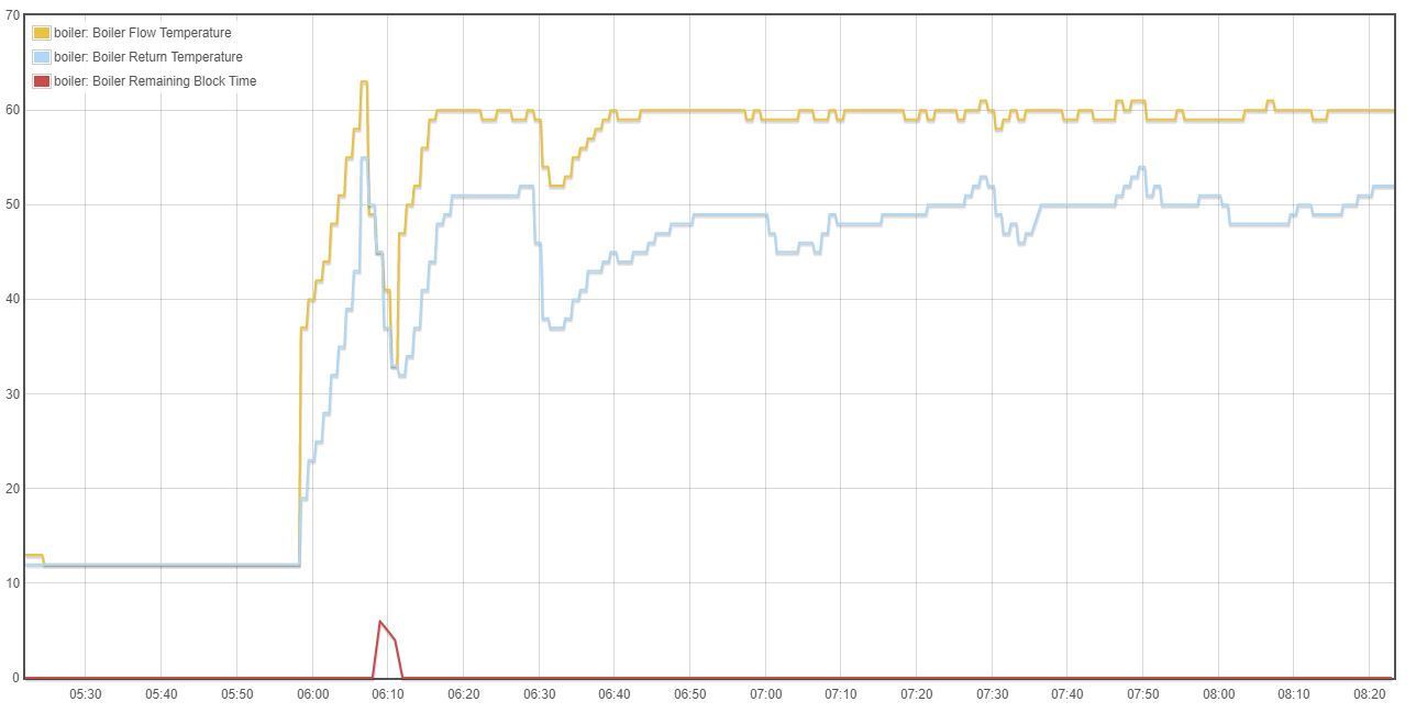

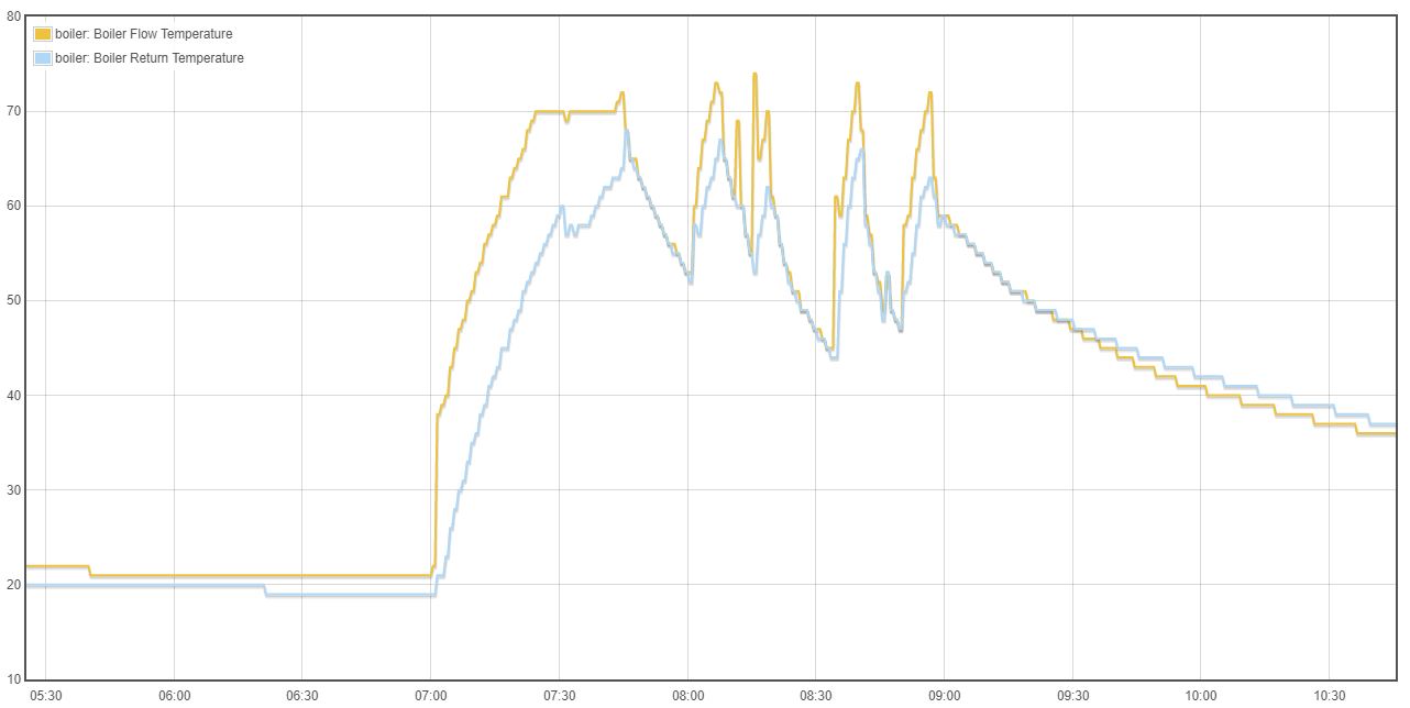

View attachment 130091View attachment 130090
These graphs confirm my thought that the system has been balanced for a differential about 10C, which requires a higher flow rate and, consequently, much greater pressure loss in the heat exchanger and all the system.
Balancing for a higher differential (but no more than 20C) would most likely solve your problem, without needing to buy another pump.
If, at the same time, you increase the flow temp from 60C to 65 and balance each rad for a return temp no lower than 45C, the heat output of each rad will stay approximately the same.
The lower pump speed required for a 20C differential will mean that the ABV will no longer be opening early. You may eve be able to shut off the ABV and run the pump in Auto mode.
