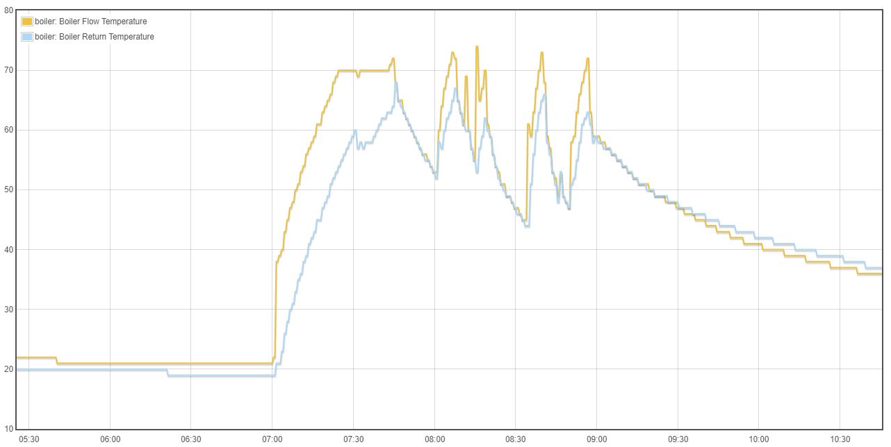

First thing in the morning it's only 1 single room that is calling for heat. So the flow temperature rises to the max 60C within about 3-5 mins.
Last weekend I conducted a little experiment and got a lot of the rads calling for heat at the same time. Then the flow took 25 mins to get to the 60C max.
3 Nov 2015
57
See the temperatures of the Flow and Return during start up. Saturday was when max Flow was set to 70C and many zones calling for heat.
Today was when flow was set to it's normal max of 60C and generally only 1 or 2 rooms are calling for heat, first thing in the morning.

Have a look in the manual for the status codes....press the i key. See if you're getting an S53 code. It refers to the VL-RL spread which is German for flow and return temperature differential being out of an acceptable range.
Set the pump on a fixed speed setting..probably 2 or 3 and try the bypass at a lower setting say 0.1 or 0.2 bar ie. 1 or 2 meters.
