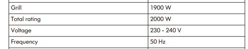

Got it now, it's an IKEA EFTERSMAK MICROWAVE OVEN.
Total Rating 2000W, if you want to believe the manual. Apparently well within 13A.
Thanks. That appears to be a lot more than just a microwave and it does, indeed, say 'minimum fuse 16A'. As well as the microwave, it appears to have multiple heating elements inside it, and at least one seems to account for an additional 2kW ...
... IF just that can be on the same time as high levels of the microwave, (which one can adjust in steps from 100W up to 1000W), that could well account for a total of 16A - but I presume that many would feel happy to apply diversity to at least the 'conventional heating' part of the load (which is no different from any other oven). Of course, it depends upon what they mean by 'Grill' - might that be Swedish for 'Microwave'? :-)
Kind Regards, John
See what I've just posted - that "Total Rating 2000W" appears on the line below "Grill 1900W", so I'm not convinced that that 'total' includes the microwave part!
There certainly appear to be various heating elements withing the devices's cavity.
Kind Regards, John
Grill 1900 W
Total rating 2000 W
I wonder if "total rating" means what it says?
Indeed - or, alternatively, as I've just written, one might also wonder whether "Grill" also means what it appears to be saying (at least, in English English).
Kind Regards, John
It would be interesting to see a photo of the "rating plate" (part 8. )
page 23 includes power settings up to 1000W, which seem to be Microwave settings.
It is unclear if these numbers correspond to electrical load additional to the "total" or included in it.
There is also an electric light.
