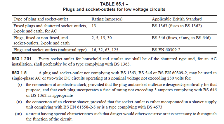

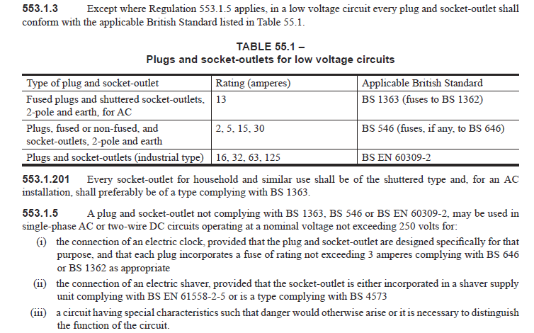

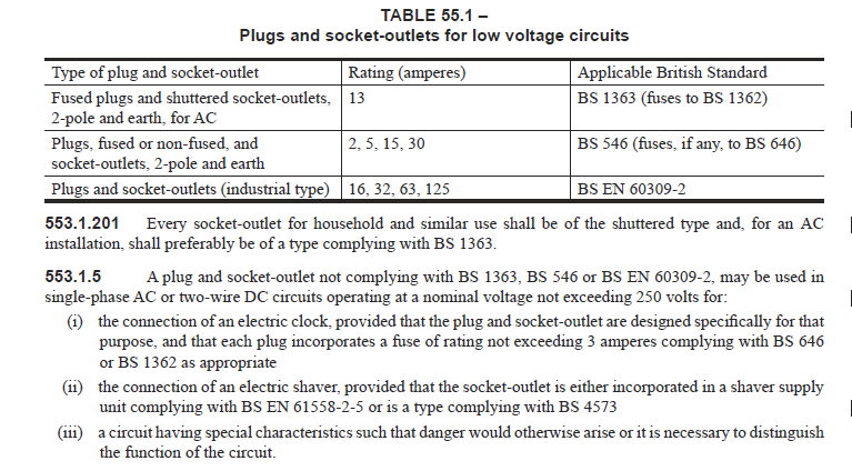

It that not already the case? EICRs are undertake with reference not to laws but, rather, with reference to BS 7671, and there seems little doubt that BS 7671 only allows socket outlets to BS 1363 BS 546 ior BS EN 60309-2, or a clock connector/shaver socket [the only conceivable wriggle room seemingly being in relation to 553.1.5(iii)]
Kind Regards, John
What about 120.3?
That doesn't really say anything (at least, not that I can really understand!) - merely that deliberate departures from (non-mandatory) BS 7671 "shall" not result in a degree of safety of the installation less than that obtained by compliance with BS 7671. I'm not sure what that "shall" is all about - it is (rather confusingly) suggesting that something which is non-compliant with BS 7671 can be compliant with BS 7671 if it does not result in a lesser degree of safety than would 'direct compliance' with BS 7671 ?!!
Also what is the wording of the reference to methods complying with other standards? I can't find it.
Same problem here. I looked, but could not find it in BS 7671, OSG or App Doc P. Maybe it's gone? When I have a moment I'll look in some earlier versions of BS 7671.
Kind Regards, John
