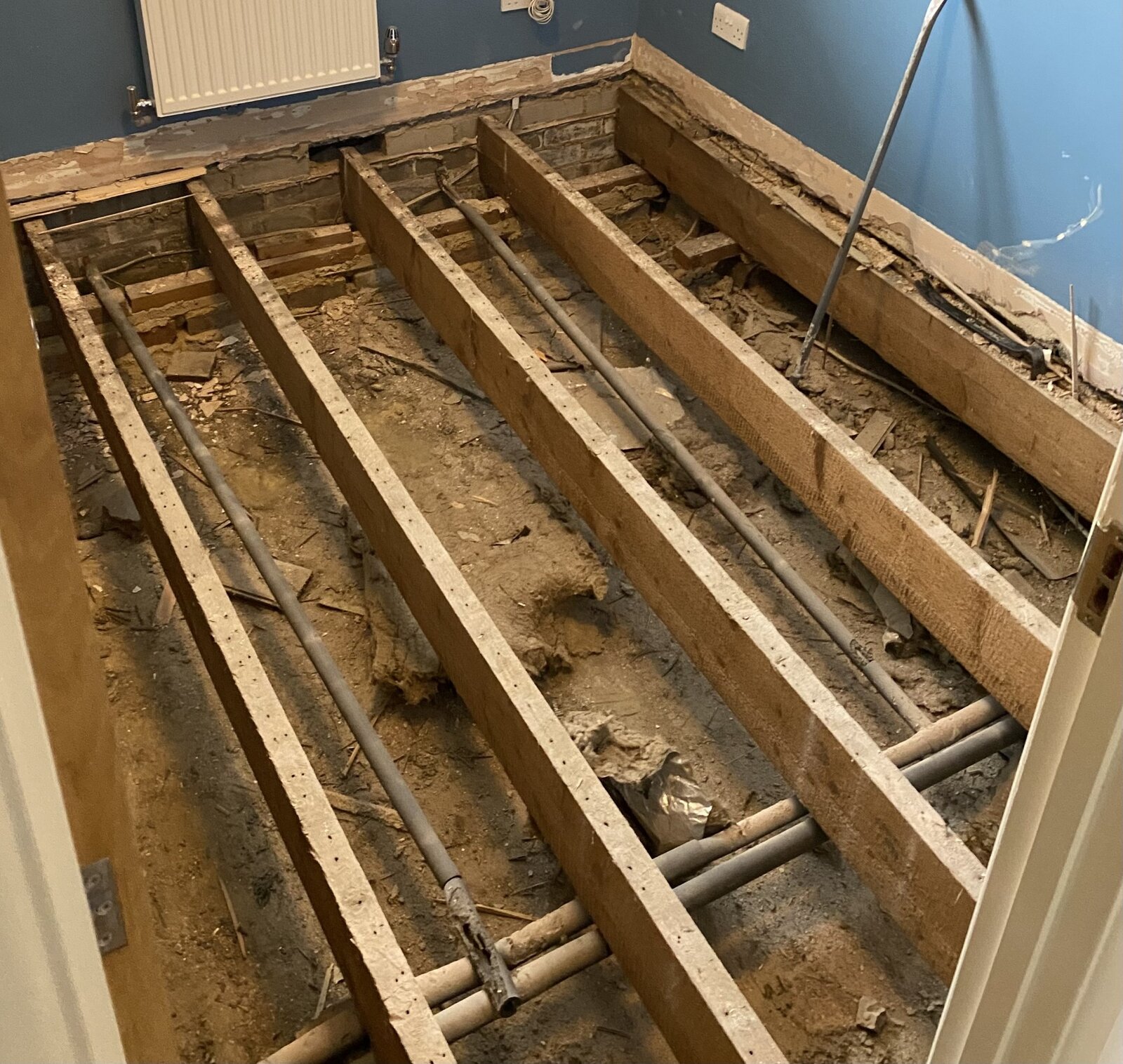

Hello,
I am renovating my 1950s bungalow with a suspended timber floor. As you can see in the photo I've stripped the floors down to the joists, with a composition of external cavity walls, timber joists, a small sleeper wall, and air vents. I'm shortly looking to get started putting everything back together and am looking for some advice please.
Firstly, in terms of the flooring, I'm trying to decide whether to use PIR or some kind of flexible insulation. It looks like the ideal method is: breathable membrane, then timber battens, then flexible insulation, then a VCL, then tongue and groove chipboard, before finally underlay and LVT. However, if using PIR, then presumably the VCL wouldn't be necessary?
Also, given that my son has some health conditions I'm looking at ventilation methods and ensuring that the air is as clean as possible whilst minimising the chance of damp/mould, including researching MVH and PIV etc, but feel totally lost with what the right option is. We have a low pitched cold roof, with floorboards and insulation that I'm going to replace, with no vapour barrier above the plasterboard ceilings. I'm curious if anyone has any experience of PIV or MVHR, and could suggest what might be best for my situation?
Thanks in advance for any advice and support

As far as your floor insulation is concerned, you don't need the lower support for your flexible insulation to be a membrane of any sort. Simple wire or nylon netting would suffice to support your flexible insulation. The netting can be stapled to the sides of the joists. The insulation is simply laid onto this support.

We have concrete floors so we can't add insulation, but the advantage is that our place is basically sealed. As you don't have concrete then you'll need to ensure your floors are airtight. Otherwise the rooms with extraction will probably pull cold damp air from the floor instead of from the adjoining rooms. Similarly the rooms with positive air pressure may just vent out through the floor.
Sealing the floors will be a big job, in addition to the insulation. You'll need tongue and groove chipboard with a vapour barrier below. With glued joints and the perimeter sealed to the wall or skirting. Ensure there's good cross ventilation via air bricks, as the structure will be losing any air movement that currently occurs to/from the rooms above.
If those are central heating pipes in the photo below the joists, you need to consider how to place them relative to the insulation.
How deep are the joists? They look quite substantial to me. What U-value do you get if you fill between the joists with rockwool (or similar)?

Hi endecotp, thanks for replying. Most of the pipework under the subfloor is actually redundant, with the exception of the gas pipe going to the boiler (not in this photo). This is because the heating pipes are plastic and behind the skirting boards. I'll remove the old copper pipes though, along with all of the debris that is down there, to help the air to circulate.
The joists are deep, and I'll measure them later this week, but must confess I'm ignorant to U-values and what I should be aspiring to.
Hi TomWW, thanks for your reply. I've researched that 'wind-washing' is an issue, which is why I thought a breathable membrane was required? I should say that I also looked at using Celotex but concluded that what I've proposed is a better option,
