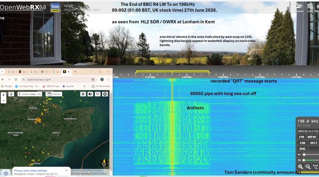

thought I ought to mark the occasion
not that anyone cares
thought I ought to mark the occasion ... not that anyone cares

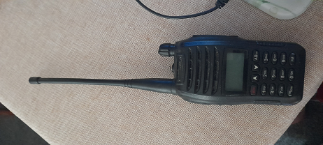

So one radio still in use, 1782576390129.png well it also covers PMR466 and we have two other radios which we did use on the push bikes, we found something which recived the message without needing to stop to answer it was good. So my chain has come off, will you wait for me, or my chain has broken will you return to rescue me, was handy.
The same with local heritige railway, a broadcast Mr & Mrs X and children are not on the train can you cheak car park, so as car park attendents we looked, but were found in the museum they had got the times wrong. And they heard the museum guys hand held ask the question, and yes we held back the train so they could catch it.
