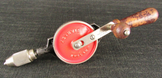

Back in the days of "egg whisk" drills, and for those of you who don't know what I'm wittering on about, I am referring to the original environmentally-friendly cordless drill:
pilot holes for woodworking were often produced by taking a panel pin or the like, snipping off the end with your nipper, chucking the beheaded pin in the drill, then drilling a hole. Works with small nails, too. Surprisingly effective and if you are piloting for something like gimp pins, panel pins, small nails or the like it produces a hole that matches the fastening you are using (obviously). There were also jewelers' versions of these drills with chucks that could hold drills down to a fraction of a millimetre diameter
