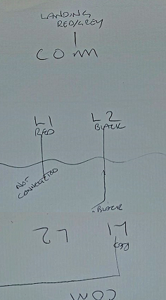

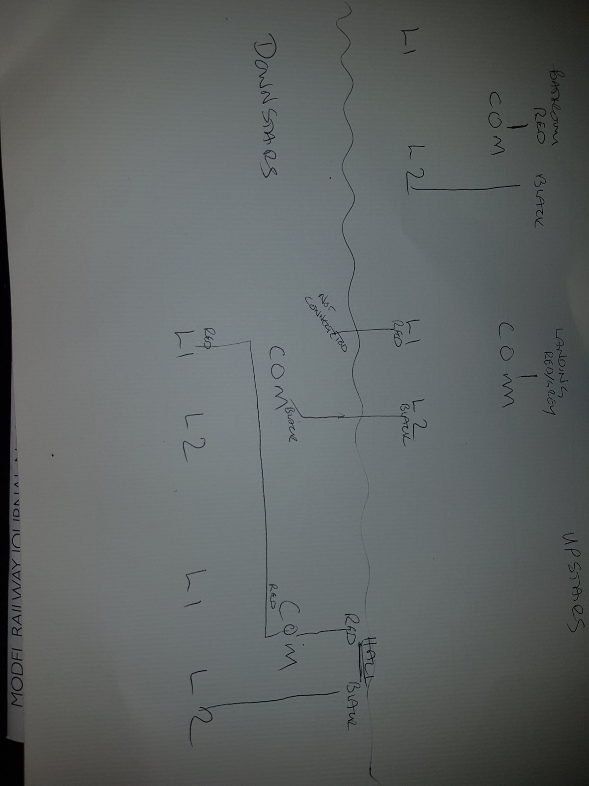

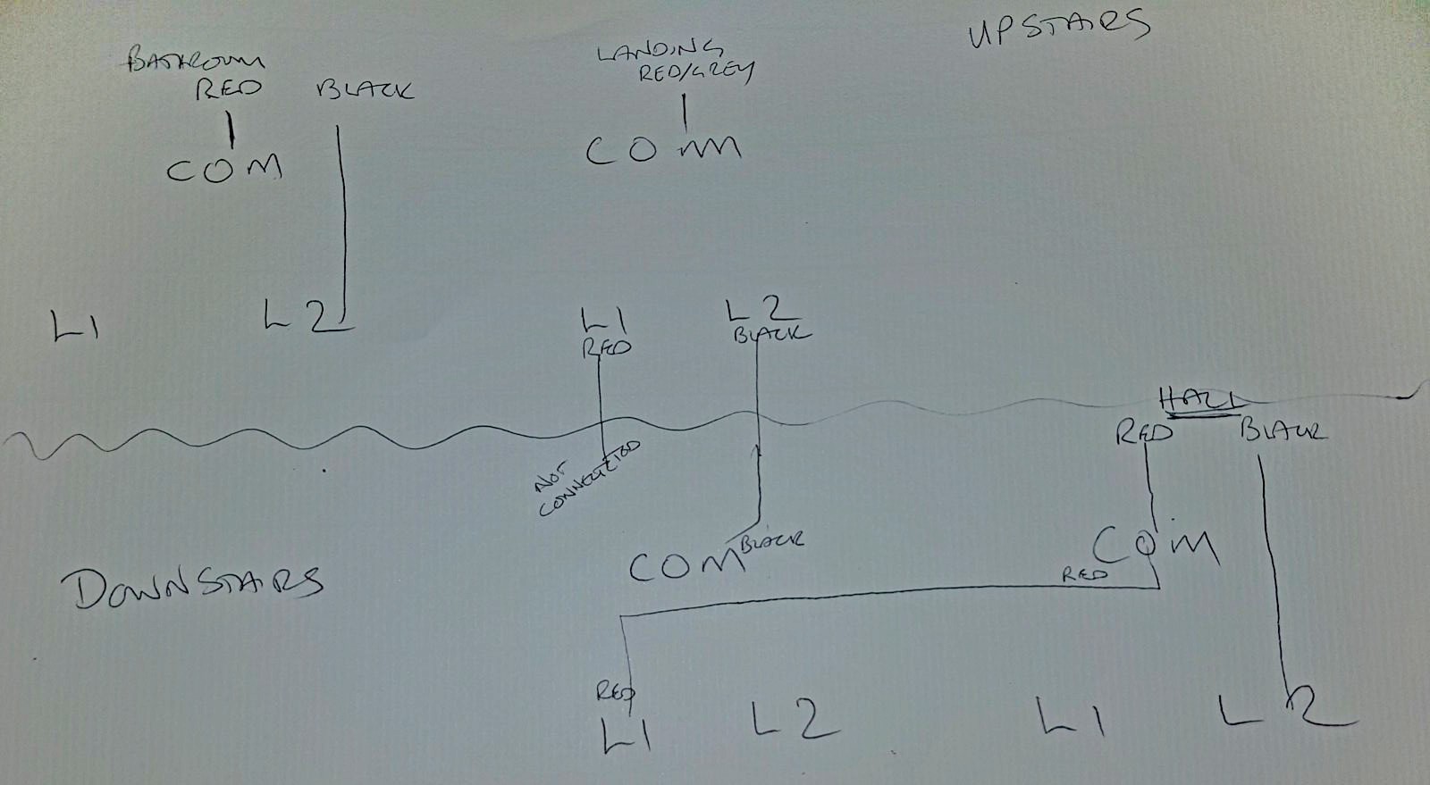

I am trying to understand the wiring in my girlfriends house. I was going to replace the switches for a better version.
Her two way lighting does not work properly. The only way she can turn landing light on and on off from hall is if switch on landing is switched on.
Hopefully i have attached a wiring diagram although as i dont have my meter her I cannot say which is live and which is neutral.
Any help appreciated. Thanks

I hadnt got my tester with me yesterday. I need to check the cable from the landing light is the "Line"
I also want to check the continuity of the disconnected red. Logic says it is from the upstairs switch, however?

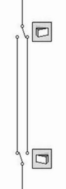

ALL the wires in your diagram will be live at one time or another.
None of them is ever Neutral.
The supply LINE is the !ink between the two downstairs switches and the conductor to which it is connected by the COM terminal.
