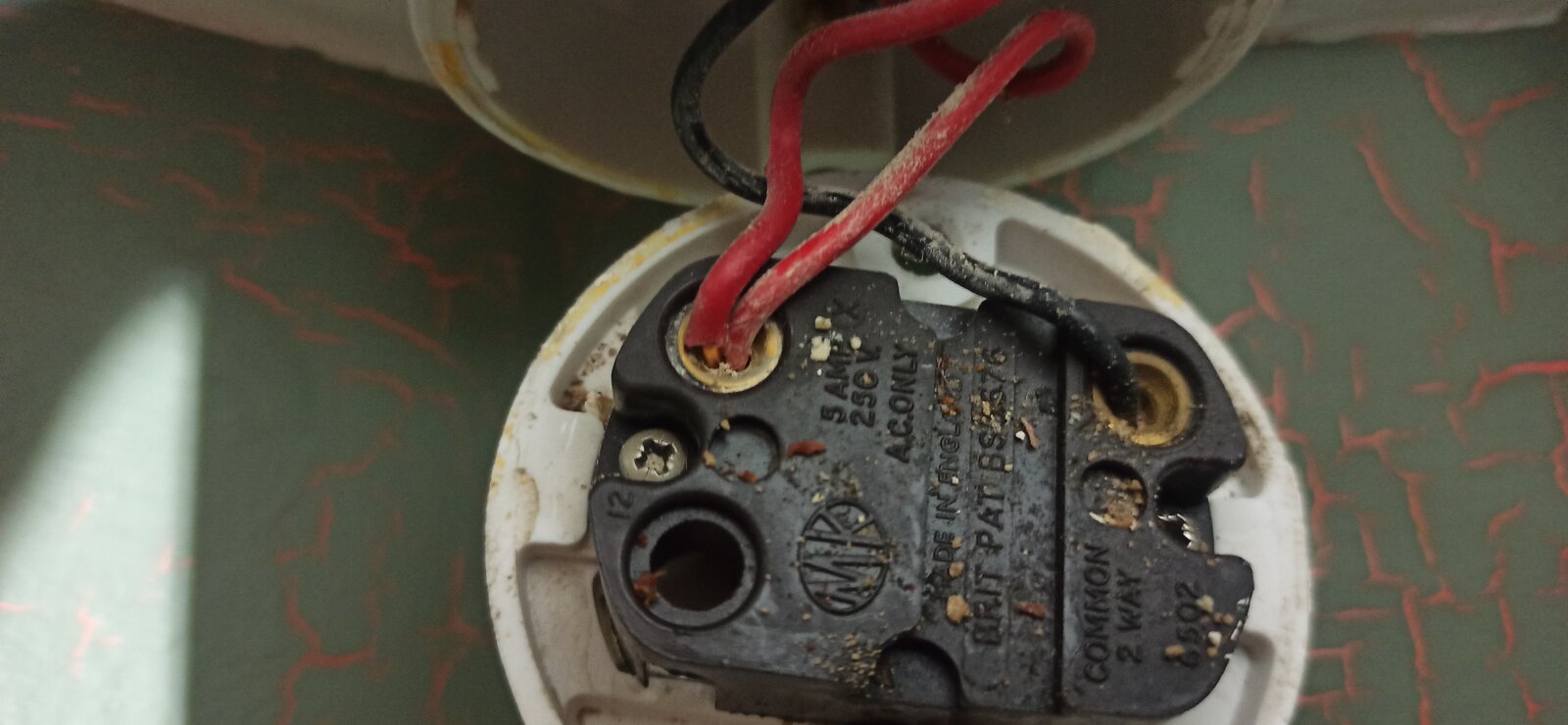

The pull switch failed in our downstairs bathroom that switches the light and extraction fan on and off. The original is a 2 way, but L2 is just an empty space. I bought a replacement crabtree 2way, which came with a variety of helpful wiring diagrams. Nothing like the original though. Com wired with neutral and two live wires on L1 (earth not shown in picture). Is there any reason not to wire the replacement like this?
It's not a Neutral and that is how it is wired and it works.

L2 is not used when it's only switched 1 way.

+ I take that your using a class ll light fitting as you've got no CPC.
He probably has got a CPC, since he wrote ...
.... (earth not shown in picture).....
One wouldn't expect to see the CPC in the picture, since it only shows the switch, and there's nowhere on the switch that a CPC could be attached to.

Thanks to eveyone for the suggestions and to EFLImpudence for clarifying that it being a black wire doesn't necessarily mean it's neutral. I'm learning a lot on this site. There is a ground in the other part of the fixture. Will replicate the original wiring and see how the plaster and rawl plugs hold up. It's at an awkward junction in an awkward old building. I would probably need to take up the floorboards upstairs to anchor it properly from above. Maybe a PIR ceiling switch would an easier option in the future?
