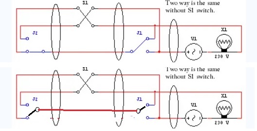

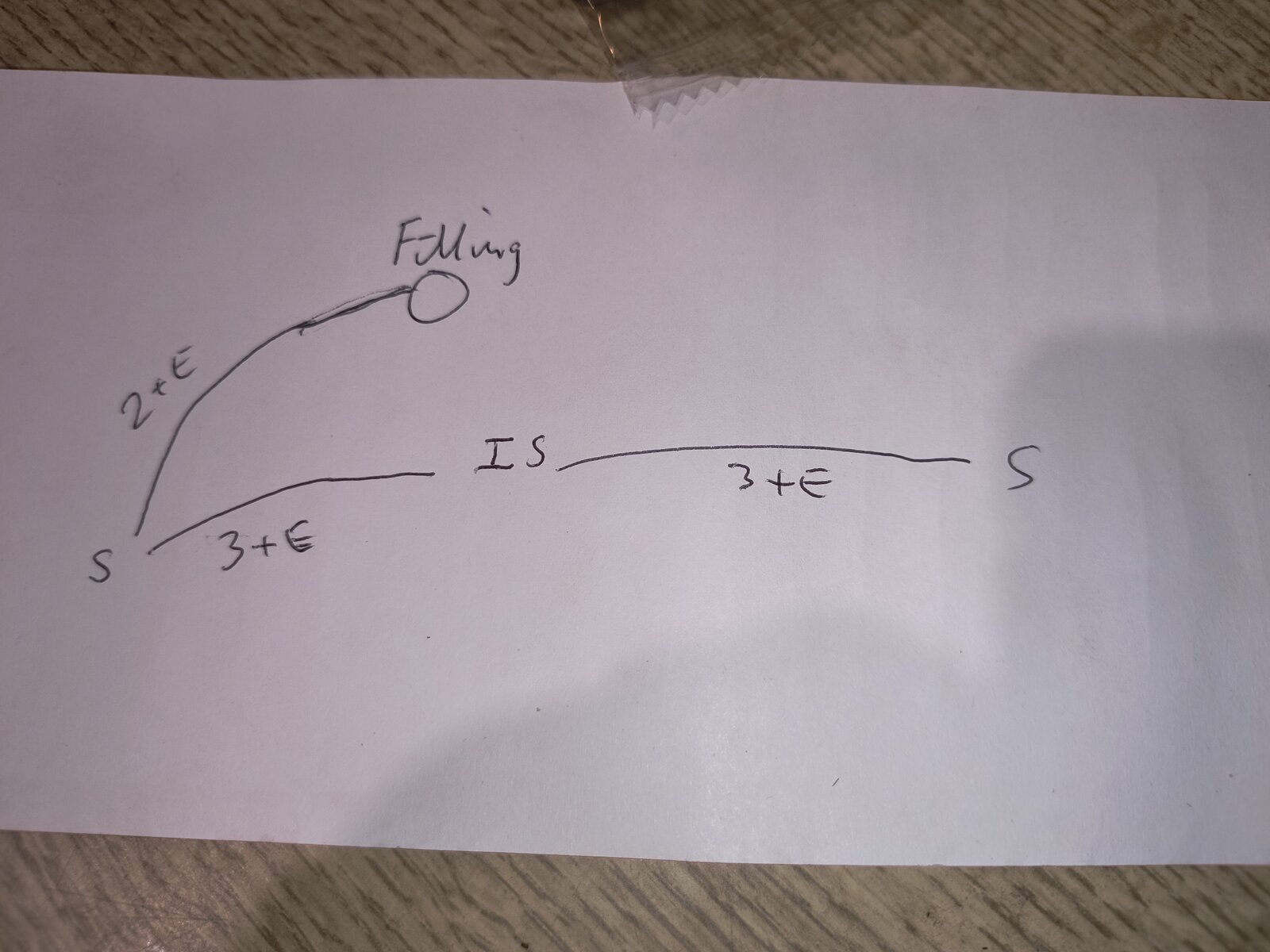

Is there more than one way?

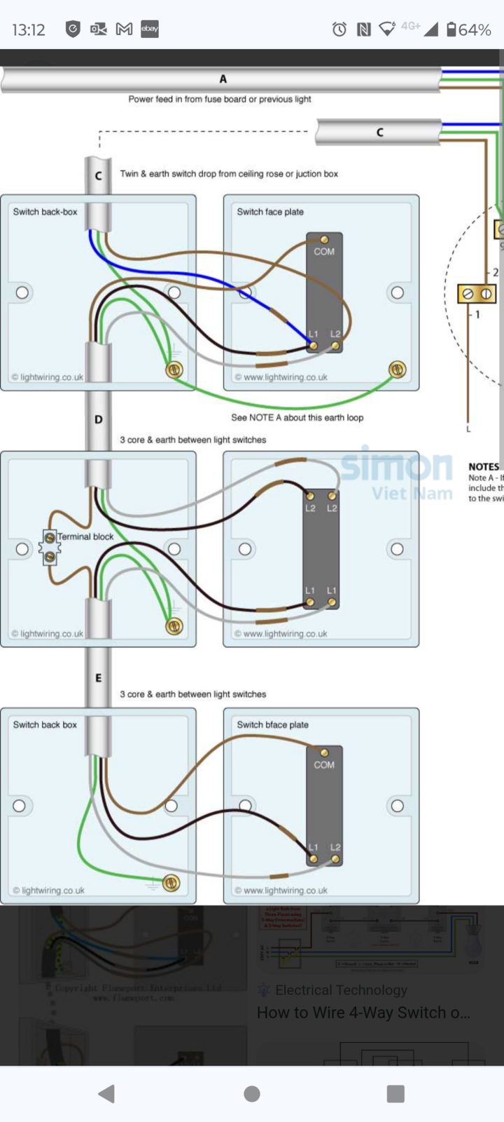

I've laid cable in like this:

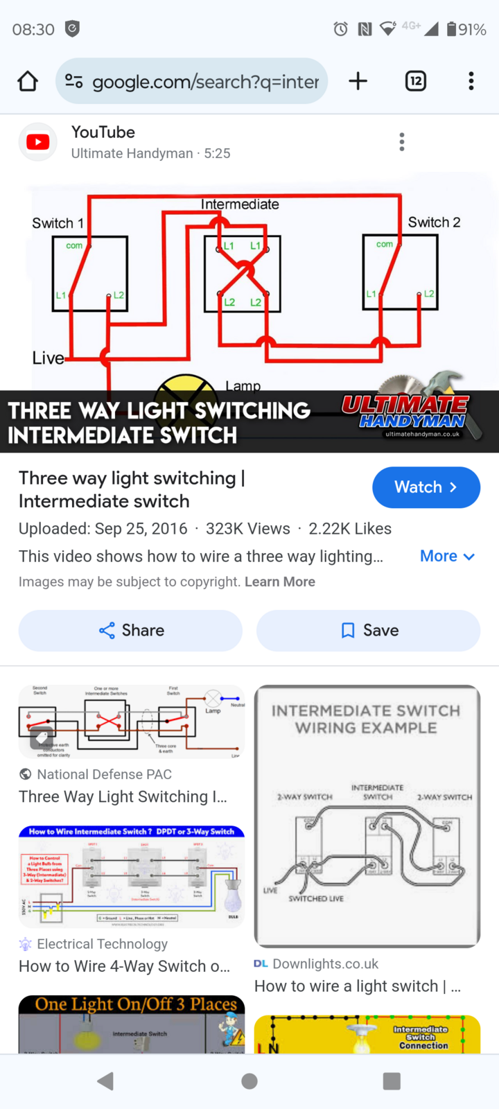

but have seen this:
I'm not really bothered as long as it works and have loads of 3C+E to use up.
Obviously the second diagram using red for all the cables is about as much use a a chocolate teapot for a DIYer.
Thanks.

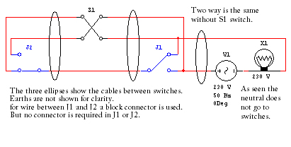

Yes there are two common ways, this
is the method you show, and there is only one connector block used in the intermediate switch, this is same with other method, but at school we were taught this
as two way wiring, which means a connector block in each two way switch rather than this
which used no connector blocks until the intermediate is used. Nearly all two way wiring has a problem in that the neutral is not run with the lives, technically this is wrong, as there can be some capacitive or inductive linking, this was never a problem with tungsten bulbs, but can be a problem with LED bulbs if it is a long run.
