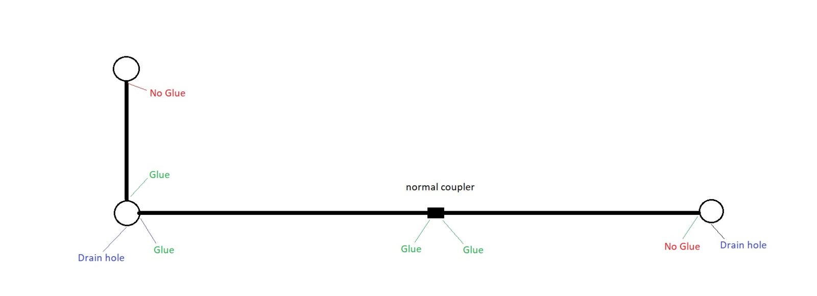

As a suggestion for drainage, how about using an inverted T junction with a short length of pipe in. At least no drainage holes will get blocked up then :)
On the topic of 'to glue or not to glue', to me it's a case of glueing some joins and not others, so you're not just allowing for expansion, you're thinking about where it will happen and by how much.
For example, if I was putting up a PVC conduit run that went down 1.5m, then to the right 6m, I would install it like this... (saddles omitted!)
With the join on the right into the terminal box, if it was was a very hot day, I'd shove the tube all the way in. If it was cold, about half way in.
With a 6 metre run and allowing for a 30° temperature change throughout the year, it will expand/contract by 10.8mm. Seeing as the couplers and terminal boxes allow 20mm of tube entry, everything will be fine. I would never do a 9m run without a through box in the middle somewhere, just to cover the rare days when it's outside of my -5 to 25° 'estimate'.
The worst conduit jobs I've seen are when the PVC has shrunk too much and popped out of a join, then when it expands in the summer, that's when the trouble starts and it goes wavy and looks awful! Putting some thought into the installation solves all that.
Gaz
Gaz

Too much expansion temporarily will be taken up by the elasticity of the PVC, it will compress and recover, as long as the saddle spacing is close. I usually use 'every 3 bricks' for 25mm conduit, which works out to about 75cm spacing. For 20mm, that looks a bit long, so more like 'every 2½ bricks', but with avoiding the mortar at all costs! i.e....
Too much contraction is the real problem, as it can cause an end to pop out and get stuck when expansion re-occurs. I have seen many installations where there is no glue on any joint and none of the joints were fully pushed in, every join seems to have been left loose, 'to allow for expansion'. The joints then all slide about wherever they want until the tube pops out of a coupler for example. Now that that end is now crooked because it has drooped, thermal expansion wont be taken up by the elasticity of the PVC, because it's not being held rigidly, it makes a nice sine wave between the saddles!
A normal coupler really isn't suitable for that purpose.
Of course it is. With my drawn example above, lets say we installed it in the shade (thanks JohnW2!! :p), on a day which was 25°C and fully pushed into the only unglued join. This can even be at the coupler if you like, it doesn't really matter which one is not glued.
For our 6m run to contract by 20mm in the winter and therefore fall out of the coupler it would need a temperature drop of...
20mm/(6000mm*0.00006)=55.55555°
I.e it would need to go below -30°C to fall out.
