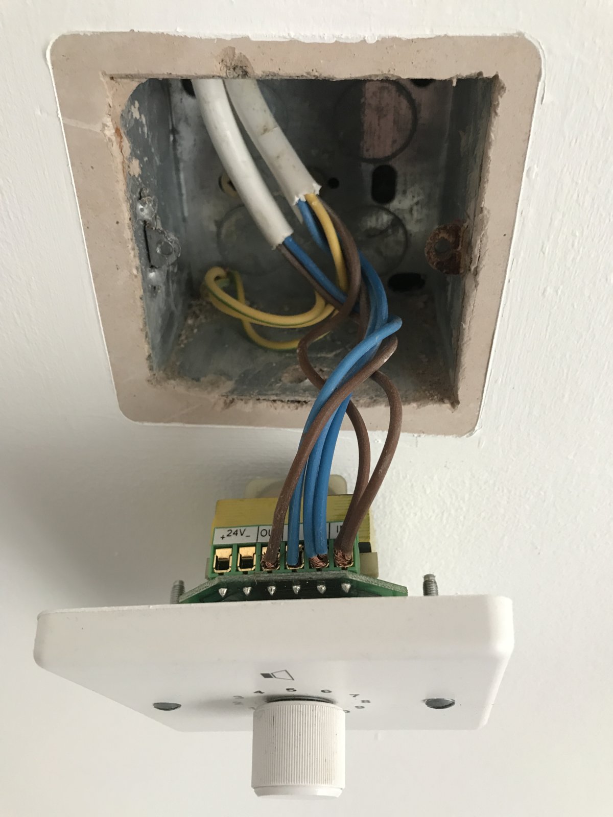

Hi guys, I've moved into a house that has a 100v Amp powering 8 ceiling speakers over 4 zones. Each zone has a twist volume control on the wall.
Everything was working fine then the sound became quiet and washy, the amp blew and stopped working.
I purchased a 2nd hand amp from eBay and again it worked fine for a few months then the same happened.
I'm lost without music and want to replace the amp but am obviously fearful that the same will happen again.
If anyone has an suggestions or anything that should be doing to try and fix it would be really helpful.
I've so far been round the wall volume controls and checked for any shorts or loose wires and everything is in check.
Many thanks,
Devs.
P.S. I'm not a spark so be gentle.

If the sound went quiet and non-dynamic then you've got a short on the system somewhere. Quite irritating to diagnose since each speaker is fed via a transformer (which will look like a short circuit to most multimeters).
EDIT AGAIN- I'll leave the rest cos it may still apply but....
The local volume controls- do you know if they are wired on the 100v side or the 8 ohm side? And how are they wired- each control should have 3 wires into it- ground, signal in and signal out. Ground should be at one end of the pot, signal in at the other end, signal out on the variable pin (ground commoned). If each zone has 2 speakers on it then each pot has to handle up to 16 watts- which makes them quite chunky and expensive. If a spark wired it he may not actually have known what he was doing. 100v line in a domestic installation is unusual, unless the cable runs are massive (20m plus) then 8 ohm would be fine.
EDIT AGAIN. You say the thing is set up in zones. Presumably you're feeding the same signal to all 4 zones? In which case the local twist volume controls will be handling about 16w
Your MA200 probably still works- the output fuse has hopefully protected the output stages of the amplifier. EDIT just reread initial post- if the fuse is popping with no speakers connected then that isn't a good sign. If you feel brave, have the lid off, disconnect the output side of the amp from the 100v line transformer and try powering up. If the fuse goes again then amp is probably FUBAR.
First thing is to meter the cabling (disconnect all transformers). If you're lucky there'll be a big fat short in the cabling somewhere- find it and you're laughing.
If the cabling checks out then connect 1 speaker back up to the cabling, put the amp on the other end and see if it works and sounds loud and full. Reconnect speakers one by one until the fuse blows/everything goes quiet.
Remove the last speaker you connected, try it now. Add remaining speakers (NOT the one that blew the fuse).

This gets interesting. I take back the comment about the spark not knowing what he was doing (though that's still more than I'd pay for a distributed audio system)- pricey way of kitting a house out but hey ho.....
Looking at the wiring, those controls are on the 100v line side (the IN terminals connected to the amp outputs). Those controls (attenuators) usually contain the audio transformer as well so the output will be connected to the loudspeakers direct. You may have to verify this.
The terminals marked 24v are for use in a PA situation- where you have local control of normal program level but if the fire alarm is activated 24v will override local volume settings (for run away messages).
Cabling is well oversize for 100v line (the system at Olivers Mount, covering 2 miles, runs on 1mm twin). Using the 3rd core to earth the backboxes isn't a good idea
My suspicion is you're getting a short on the 100v distribution system. This could easily be caused by a stray strand at one of your control points.
JOB 1. Disconnect amplifier, measure the impedance of the system (using a multimeter set to OHMS across the 2 cores feeding the speakers). This may give you a very low reading (cos transformers) but it might be useful. While at the amplifier end, see what the green and yellow conductor in the speaker flex is connected to.
JOB 2- inspect all the volume controls looking especially for stray copper strands causing short circuits.EITHER Get some bootlace ferrules and reterminate all the flex connections (the flex used is too big for the terminals, high risk of shorts between adjacent conductors) OR get some terminal block and 1mm two core flex, use terminal block to connect your oversize flexes to a short length of 1mm, connect the 1mm flex to the control . Leave the BLUE terminals on the INPUT side hanging loose for now (crimp the ferrule on but don't connect it to the control. Crimp and reconnect the other cables. TIP- disconnect, crimp and reconnect 1 pair at a time at each control so you don't get confused and end up having a speaker getting 100v line direct.
JOB 3- when you've done that, remeasure the system impedance from the amplifier end. It should be open circuit (cos you left all the blue inputs hanging)
JOB 4- measure the impedance at the INPUT of one of those controls. See if it varies with the setting on the volume control. Repeat with all the other controls. Are there any significant differences?
JOB 5- Reconnect the amplifier. Connect one BLUE INPUT terminal, run some music, does it sound OK? Repeat with your other zones til the whole system is reconnected.

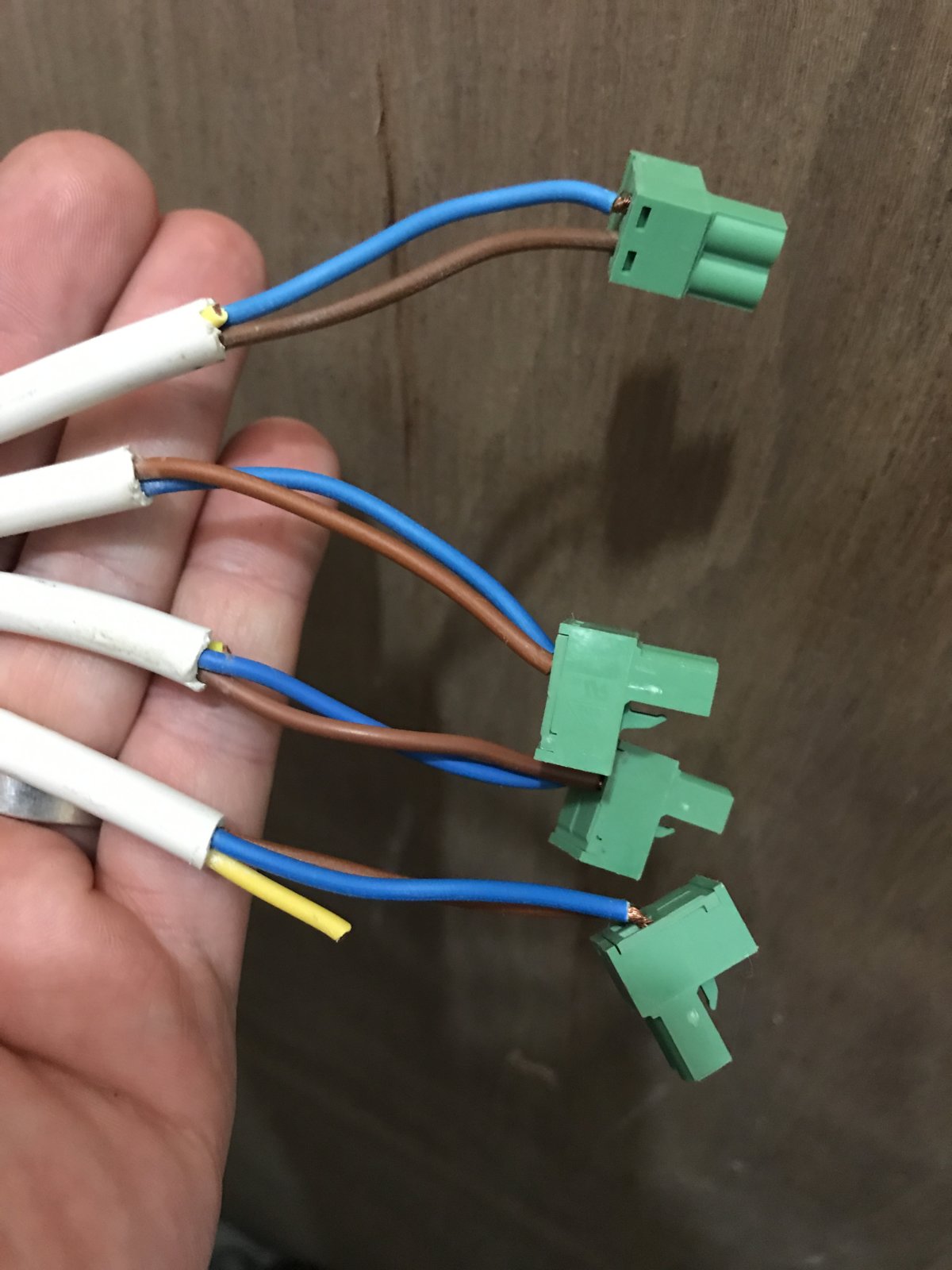

Attached is how my current to amp wires are configured so I assumed that I needed the 4 zones? I've also attached an image of the back of the amp that I intended to buy and it doesn't seem to be able to accept?

Well one bit of good news- matey who cabled the thing hasn't connected the green/yellow cores to anything at the amplifier end. Do yourself a favour- when you go round all the volume controls rewiring them snip the green/yellows (or disconnect them from the backbox anyway)- that way neither you or anyone else will be thinking that the backboxes are earthed.
Do you have any need to switch the individual zones off at the amplifier? I suspect not- if you want to turn one room off you'd be doing it at the local volume control wouldn't you? So on that new amp you would parallel all 4 pairs onto COM and 100v.
