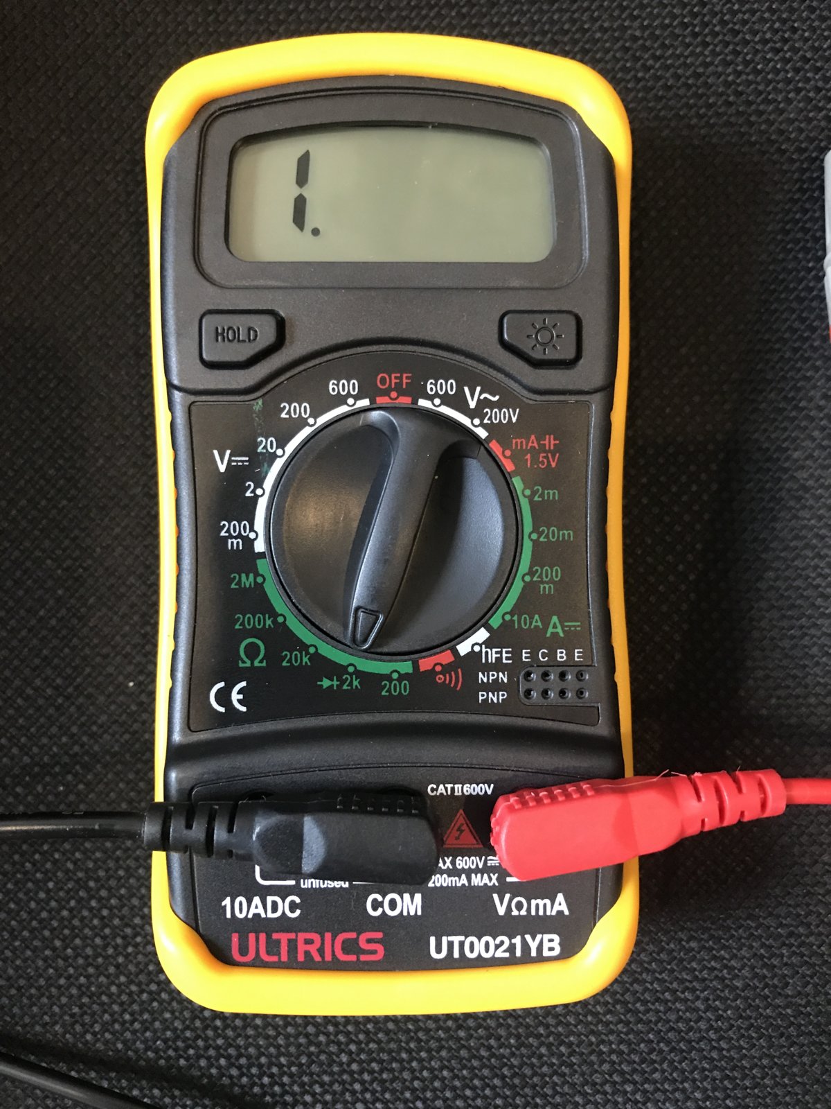

Hello mate, the meter has arrived this morning and I've just started to go round the controls and test the readings.. I just wanted to double check that I've got the meter setup correctly before continuing as the readings on the two that I have tested so far differ from when you suggested.
1 - Kitchen / Dining room - 3 x speakers / one twist vol. control - Reading = 1.21
2 - Downstairs Hall - 1 x speaker / one twist vol. control - Reading = 3.51
Attached is a photo of how the meter is set..
Is this correct and shall I carry on.
Many thanks,
Devs.
Morning. Better off having the meter set to 200 rather than 2k (for the low impedance you're measuring). Those readings imply that the speakers are 4 ohm impedance rather than 8 ohm which is odd and may not be helping with your problems (presenting too high a load to the amplifier).....

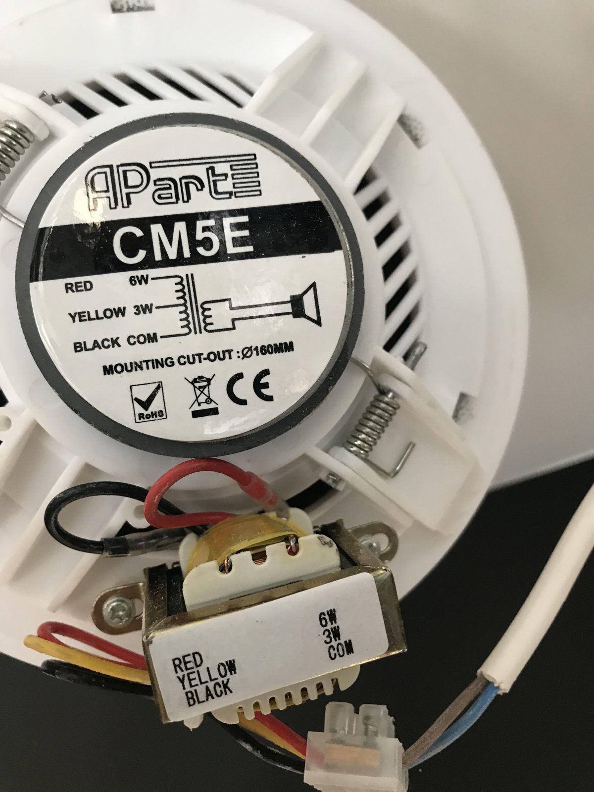

Hmmm. Most of the controls are to handle 12 w- that's reasonable for 1 speaker. The odd one (if on the zone with 3 speakers) makes sense- that'll handle 100w. The interesting bit is there are 2 variants on those controls. The ones without relay appear to have an onboard transformer (so you'd connect your 8 ohm speakers direct to the control). The ones with relay appear NOT to have said onboard transformer fitted (what passes for a drawing implies that the line transformer is separate to the control). Can you get at any of the loudspeakers to see if they have transformers attached? (An easy one is always better to start with)- and if they have got transformers (they should have) whether they've been wired to use the transformer or bypass it?
The odd ball control is for the upstairs hall, that powers only on speaker. I've just double checked a speaker and attached a photo of one here. I can confirm that they are all the same as this one without anything additional attached as I've had them all out previously whilst painting.
OK and all good so far. Might be an idea to swap the odd one to the zone with 3 speakers on it. And no you shouldn't have blown the amp up by having all the speakers on full- there's only 8 speakers on the system, with them at full chat that's still only 50 watts. Those controls you have are the proper ones for the job so not a design issue, I still suspect a low impedance fault from a whisker on those chunky cables at the volume controls. The speakers have been wired sensibly (decent sized terminal block so less likely to be a wiring fault there). Those resistance readings intrigue me- they are quite high for DC through a transformer. Shame I don't have any 100v line kit here any more to do some testing of my own.
