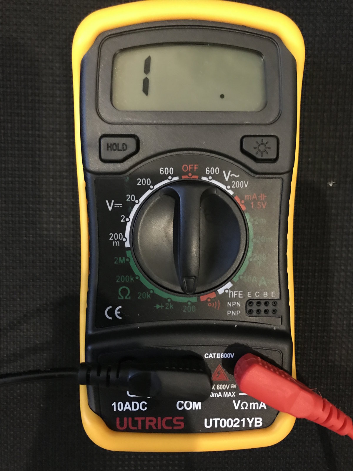

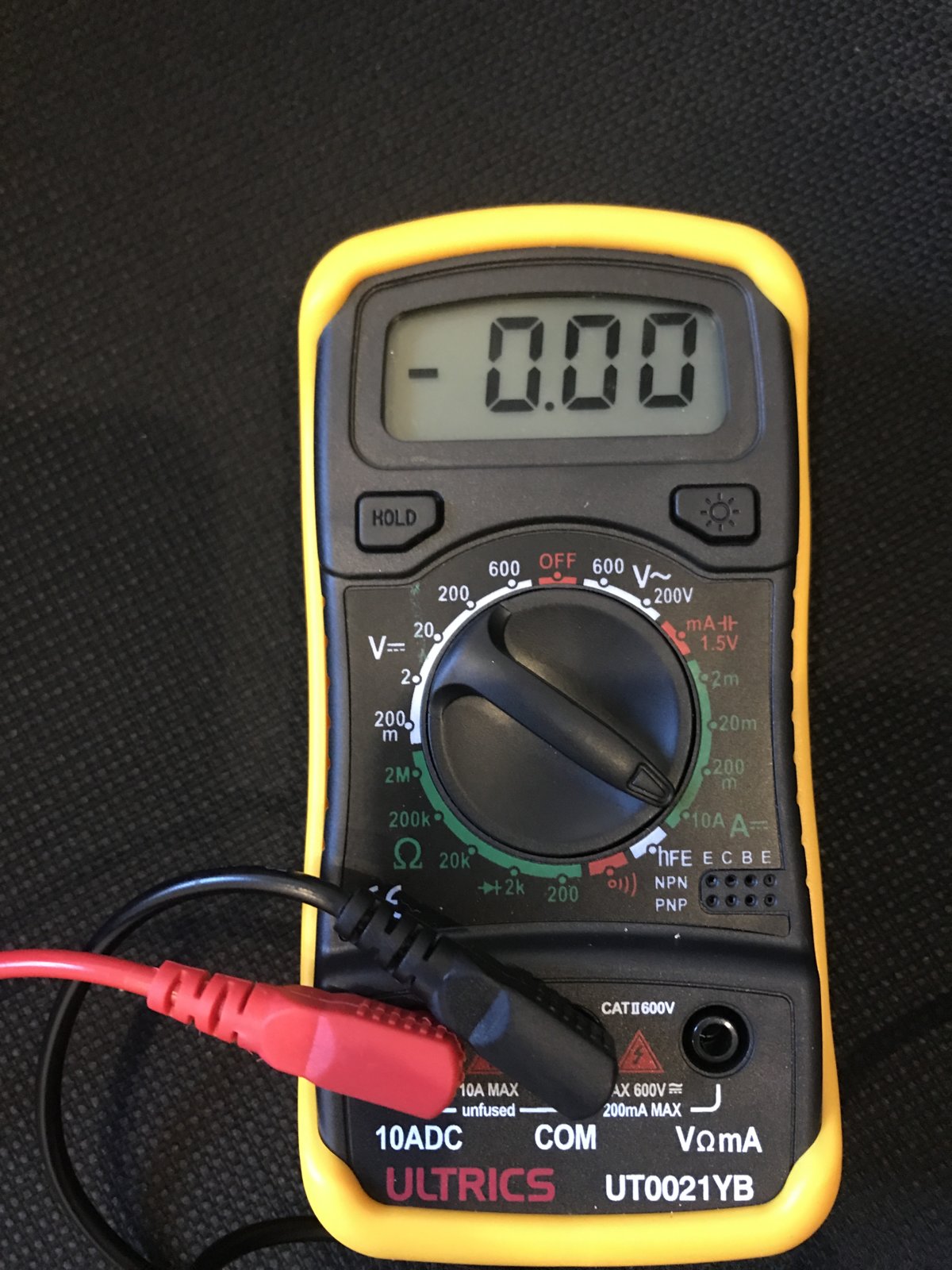

How do I check the continuity? I tried a reading via the connected switch wires. With the following settings but no reading? What am I doing wrong?
Thanks.
You're still on 10A and the RED probe is in the 10A hole. Put the RED probe in the VΩmA hole, select 200Ω with the rotary selector and try again (that is if you have disconnected the amp and are metering the cable that goes to the kitchen and only to the kitchen).
If you're checking for volts at the kitchen then put the RED probe in the VΩmA hole, select V ac(can't find squiggle on here) 200 with the rotary selector, stick some noise through and see if you get some numbers. If none on AC, try DC
School boy error, apologies. As you can probably tell this isn’t a strong point of mine :)
You're still on 10A and the RED probe is in the 10A hole. Put the RED probe in the VΩmA hole, select 200Ω with the rotary selector and try again (that is if you have disconnected the amp and are metering the cable that goes to the kitchen and only to the kitchen). On this test I was getting a reading of 121.
If you're checking for volts at the kitchen then put the RED probe in the VΩmA hole, select V ac(can't find squiggle on here) 200 with the rotary selector, stick some noise through and see if you get some numbers. If none on AC, try DC I’ve just tried this test and whilst metering the joined cabled from where the volume control is sited in the kitchen. The only setting that I’m getting a reading on the meter is:
The reading that I got was also 121 (whilst playing music).

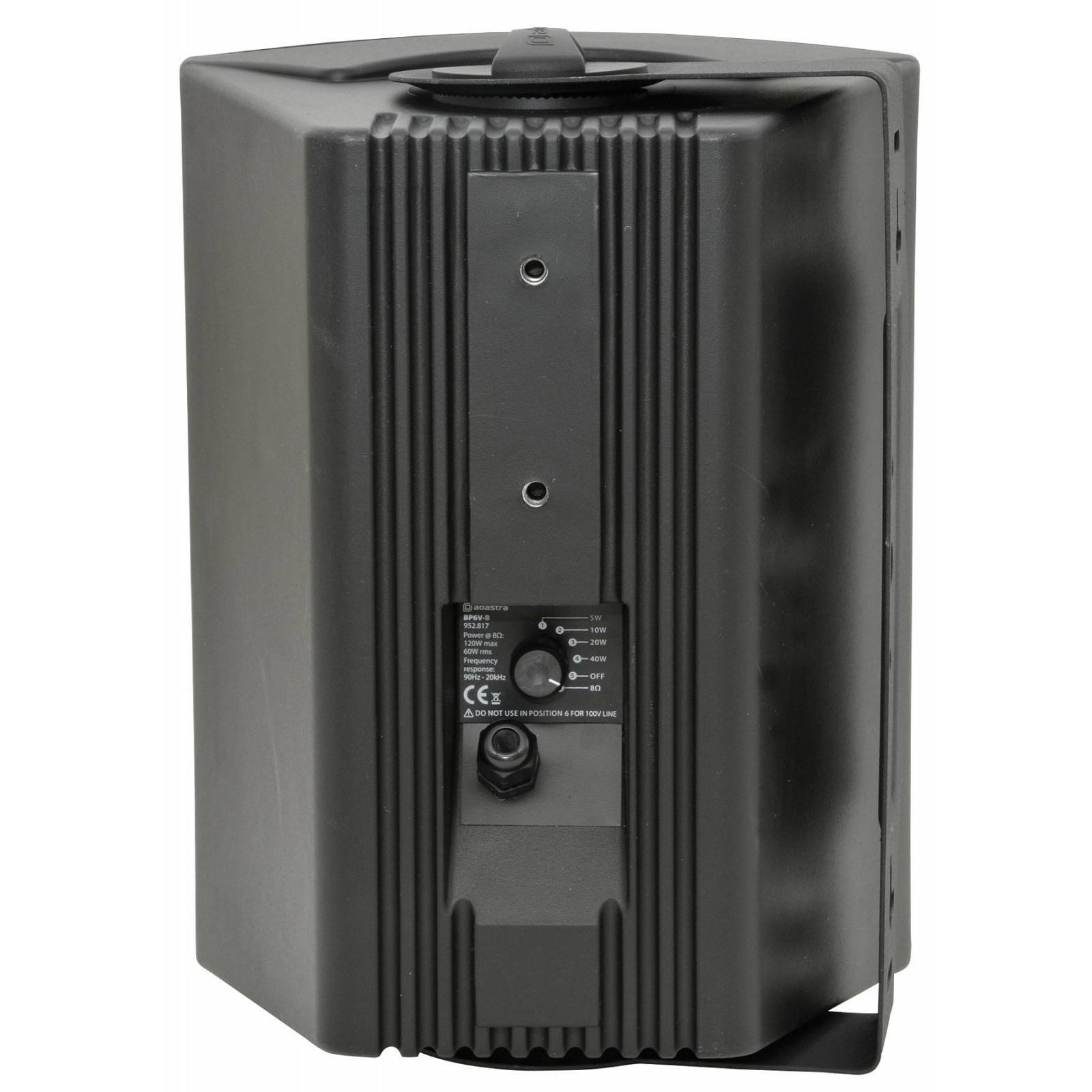

On a side note I've just purchased an outside speaker that I'm going to hook up. The switch on the back of the speaker I trust should be set to 40w? I'm I also right in thinking that there needs to be a new volume control fitted for this speaker?

Quickies. That outside speaker- it'll be easier to control it with another controller like the ones you've got. The switch on the back of it- 40w might be a bit loud, any setting except OFF and 8Ω will work.

If the speaker was set to its no.4 position of 40w? I'm getting thrown by the output speaker spec of Power max. : 8 Ohms: 120W Power rms : 8 Ohms: 60W
