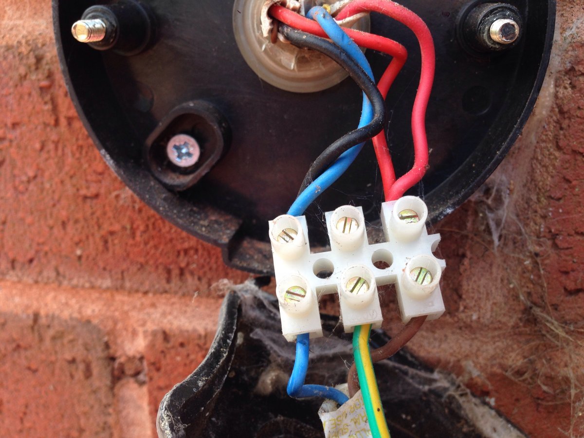

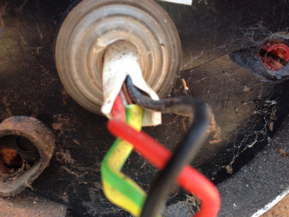

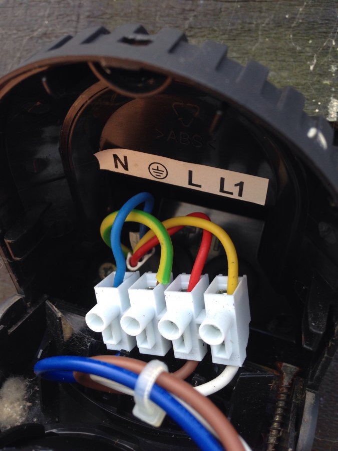

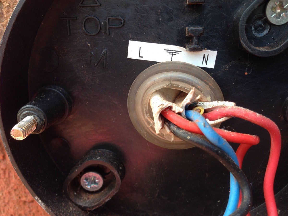

So the other lights connected up to the pir have more wires. Will look at the PIR next
Another light is wired just with 3 core no bare earth.

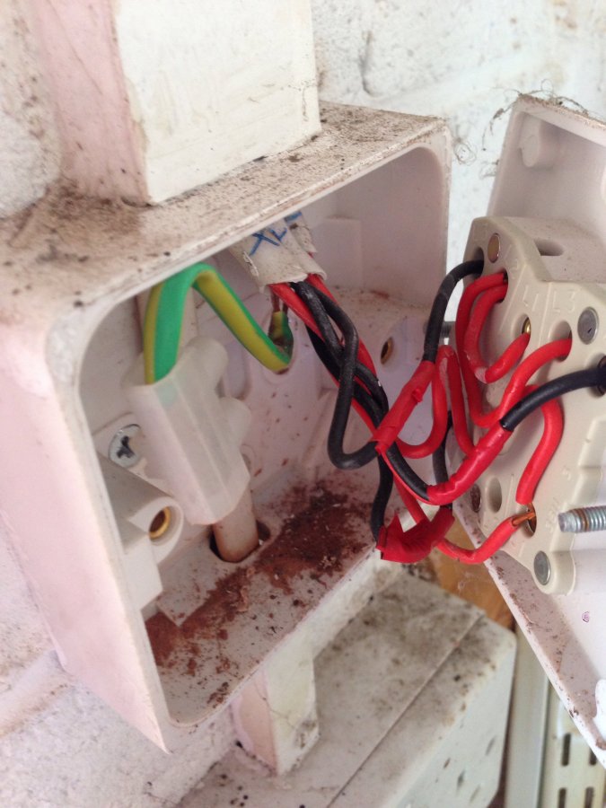

The light switch is wires
