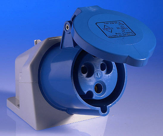

I've got a compressor in my garage and want to be able to plug it in to a socket. It's 2.2kW but because of starting current requires a 30A supply. I've found this Gewiss 32A socket on tlc site but never seen one before. It will be mounted on brick wall with cable surface mounted in conduit from CU where there is a spare way available. I can't see where cable entry is from the pic. If it's through rear of mounting flange it's not too convenient.
Is this the only one to use or are there any alternatives. I'd prefer one that was more of a box shape.
most wall mounted are a similar shape and cable entry is thru the top. why wud this type be a problem?
Thanks for reply Andrew and top entry is ok as conduit would be surface mounted. The socket looks a bit industrial and I didn't know if it was usually mounted on some sort of partition wall with the cable coming in from the back of the flange, but in my case it's on a solid wall.
I asked the question to see if anyone knew an alternative as I've never used these before and only found this one.
as Andrew says I think this picture shows it at ninety degrees to its mounting position
no wrong way you know you can't fit one of those to the left :D :D :D
Thanks for orientation info, but I'm still not sure how the supply cable enters the socket. Is this unit normally fitted onto trunking where the supply cable goes through the mounting flange? My installation will be surface mounted socket and conduit.
Has anyone fitted one please?
Use a male conduit adaptor between conduit and socket.
Are you sure you need a 32 amp one?? Starting current cant be too bad for too long??
Thanks for drawing lectrician, that confirms what Andrew thought. I'm sure you're right that starting curent is not on for long but installation manual states 30A fuse rating. If I fit a 32A socket I can plug my welder into it as well.
