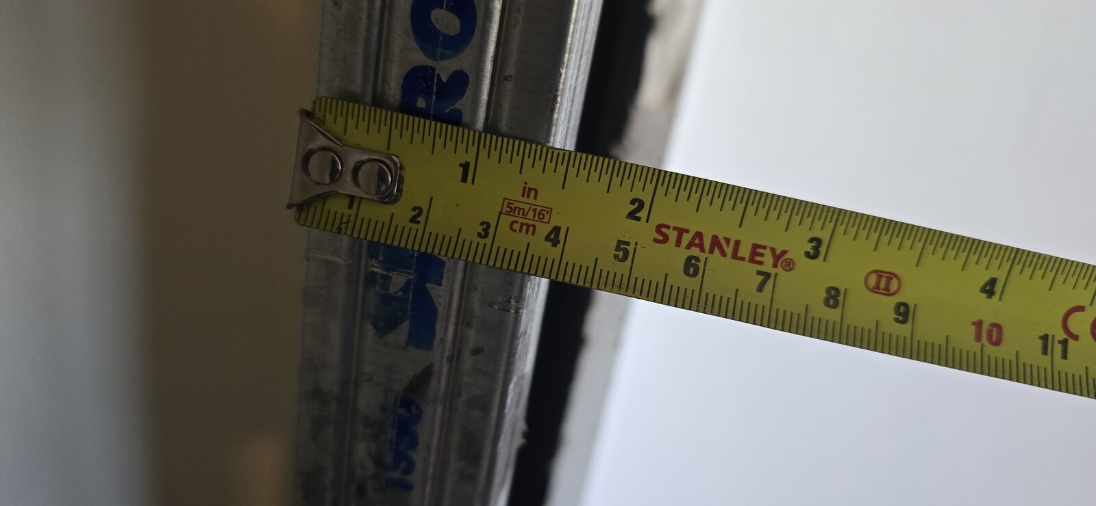

Renovating a room to get access to a cupboard. Cutting out the plasterbaord on the stud wall to get access to the cupboard (blocking up the order side)
Issue is the metal stud used appears to be 37mm and i need to brace the exposed plasterboad and cavity once i complete the cutting out. Looks like (as i suseced) 37mm metal stud isnt a thing anymore. So looking to use timber to box out the opening.
Anyone see any issues with this?
Isn't the depth (the critical dimension) 50mm, unless it's been used the wrong way? Anyway, Wickes sell a 50mm x 35mm which may be close enough.
See measurements
Just had a quick measure, my 38x63 CLS timbers from Wickes are exactly 37mm. You'd have to have a search through their piles as most are like bananas!
