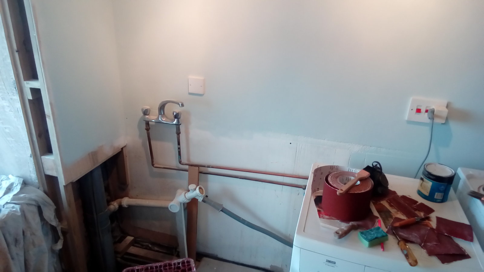

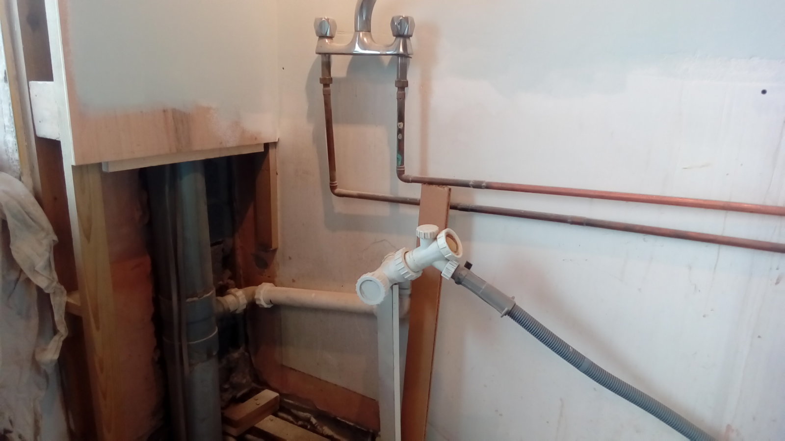

I've been looking online at a new sink base unit that's listed as having a 40mm void to it's rear? Is it 40mm,
Plenty of choice online source a product that suits your existing installation,or get a competent installer to supply & fit the unit :idea:
yes,but a 40mm void is good for not much when considering waste pipes.
Some units have 65mm void.
Personally I would still take out the back and refit after -making the rear accessible makes for much easier alteration afterwards.
You dont even need a full height back.......
Whats really annoying is taking out an old kitchen where the base units went in before the plumbing
Or trying to replace a tap that was fitted to the sink which was fitted to the work bench which was fitted after the cabinets and before the upstand, so there's no access to anything and the pipes are too close to get a pipe cutter on them. So a new tap means grinding the existing copper, taking the kitchen to bits, replacing the sink because the seal can't be cut at the back and it's thin steel that so ends up bent. That one ended up with an epoxy repair to the tap pin-hole leak, but it's going to be a pain at some point.
I've been looking online at a new sink base unit that's listed as having a 40mm void to it's rear? Is it 40mm, or is it actually larger in order to accommodate the compression connections etc? My existing sink waste pipe is slightly over 40mm anyway, with the various connectors being significantly bigger. I don't see how a new sink base with a 40mm void will marry up without some invasive surgery to the unit.
Is the 40mm void measurement only a nominal size that actually means it will be large enough to accommodate compression connectors that accompany a 40mm waste pipe? If so what size would the void actually be?

If I just get a base that isn't the full 600 deep, then I won't have to savage it to accommodate the copper or washing machine waste, which can just be altered slightly. The base won't have end panels or kicker, the legs will be changed to 6" brushed stainless. The left/drainer end will screw to the corner of the soil box-out, I might have to bracket the right hand end of the base off the wall. Then float a short length of worktop over the washing machine.

There is no existing, at all.
I've been a welder and a draughtsman, I can fit a beech worktop on a base, and fit a sink. Flashing a copper joint is a doddle. Familiarity with current products is my real issue.
I’d stick with the normal sized unit and make a neat job of the pipes inside the unit then it’s all accessible.

I wonder if you are over thinking it -cutting down a unit is no big shakes. If you can do the above, then cutting down a unit isnt that hard.
