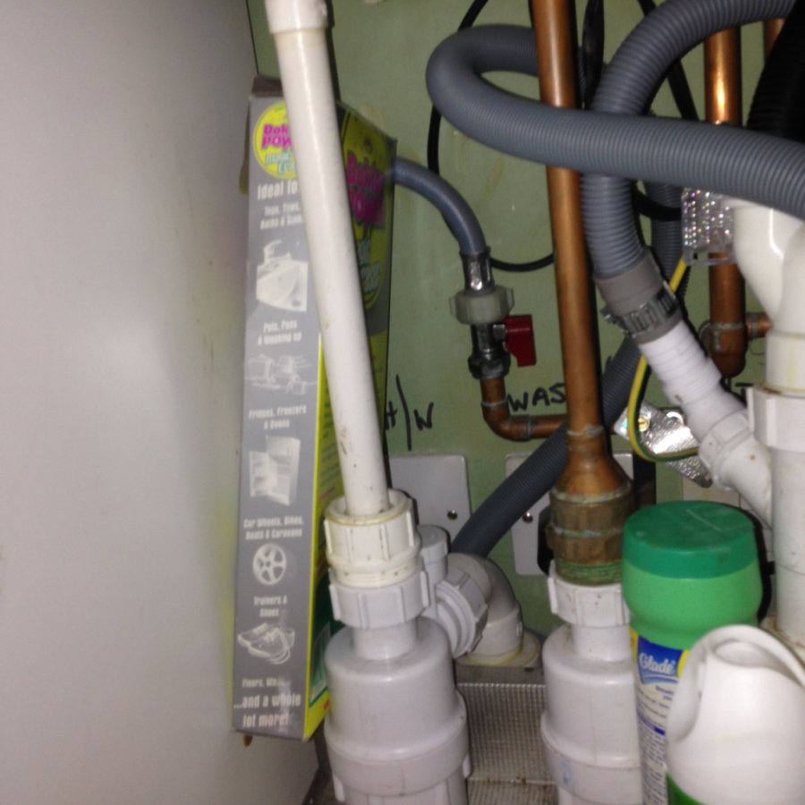

OP to enable us to make an informed comment please could you explain where the condensate goes to?
Perhaps post a photo?

posting the picture here, im based in docklands, London. the white pipe (on top) is coming from the boiler and joining the outlet through that white thingy. the reason for congestion he gave was ' perhaps when the flat was constructed 15 years ago, the builders left somethings in'. he got a drill like thing to unblock it. I am no expert but i didnt see a lump of wool coming out. the boiler condense, kitchen sink outlet and washer dryer eventually join the same 'big pipe' is what he said. he explained that the water within the boiler couldn't make it's way through and therefore it basically trickled down to most parts including cabling. At the time of installation, he didnt check the condensation pipe functioning and neither did he ask me to get it checked. he didnt suggest a condense pump either.
when he mentioned congestion, he said unblocking will solve the boiler problem. It did not. then the gas valve came up. im worried where will it end. I spent close to £3k just 5 months ago. another thing - its been 5 months and i havent received my building regulation certificate from LA. i am sure this person isnt gas safe registered.

From this boiler design, it is almost impossible for condensation water to back flow up to the gas valve before the boiler cuts off.
I have experienced some F28 and F54 failures on Vaillant ecoTEC R2. It is by a batch of gas valves, known issues. Call Vaillant to get it replaced.
If the gas valve and cables are wet then its not a manufacturing issue. Therefore its not covered, and Vaillant are now charging for call outs which turn out to not be manufacturing issues so you take the chance of this if you get them out.
It is however very unusual for a blocked pipe to cause this damage, for water to enter the gas train normally it has to be forced up the condensate, possible a blockage downstream and the washing maching has pushed back up into the condensate.
Im a big believer these days of having a trapped air gap between the boiler outlet and any drain system which makes such a fault impossible,
