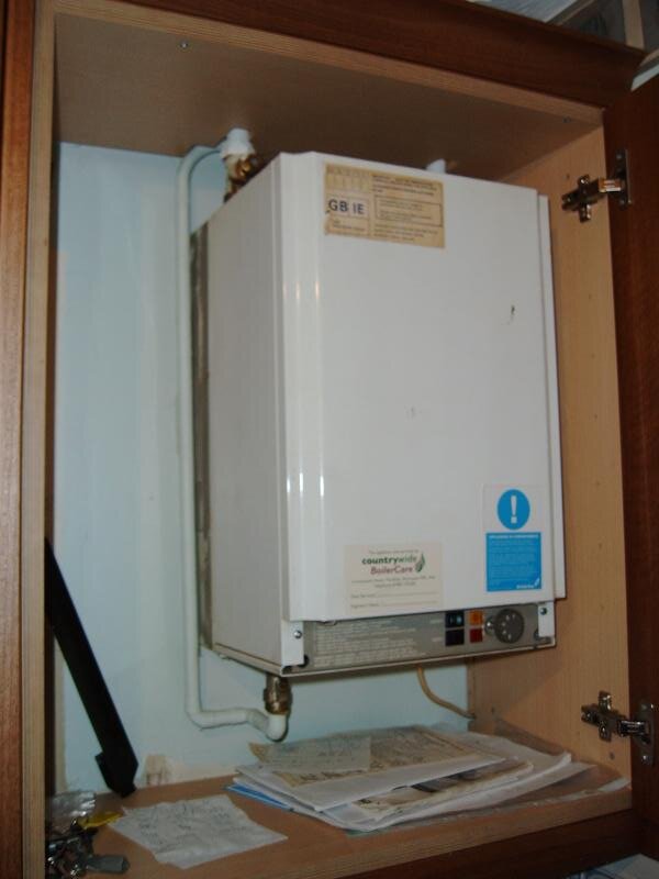

Many thanks for your replies. The boiler I have is a Maxol MicroTurbo 40H MDF. There's an attached picture.

Most of the parts which wear out and fail on such old boilers, are common to many such boilers, which means they are easily sourced for replacements, which also makes them simple and cheap to repair. Modern ones are much more complex and most parts are unique to the model too and tend to be more difficult to fix as well as more expensive, plus they tend not to last as long.
Against that you have to factor in that a modern boiler might consume 10 to 15% less gas, which is daily becoming more expensive.
Probably right about parts for the Maxol. Have worked on quite a few and parts virtually non existent.
Main issue you would have if you changed boiler is the flue is two aluminium tubes approx 40mm that can run
usually across a ceiling or in a box to outside some distance away and a modern flue is usually 100mm o.d.
and limited to 10m horizontally and with a fall.
My advice to customers is .
Replace an old boiler instead summer or wait until it dies. Sods law it would die on Christmas eve.
Bite the bullet now.
However, old boilers - dumb ones with no electronics - have nothing really to fail in them 'cept the gas valve. Piezo igniters and thermocouples seem to soldier on indefinitely.
The sooner the better, you can’t start saving running costs till you have a more efficient boiler .
