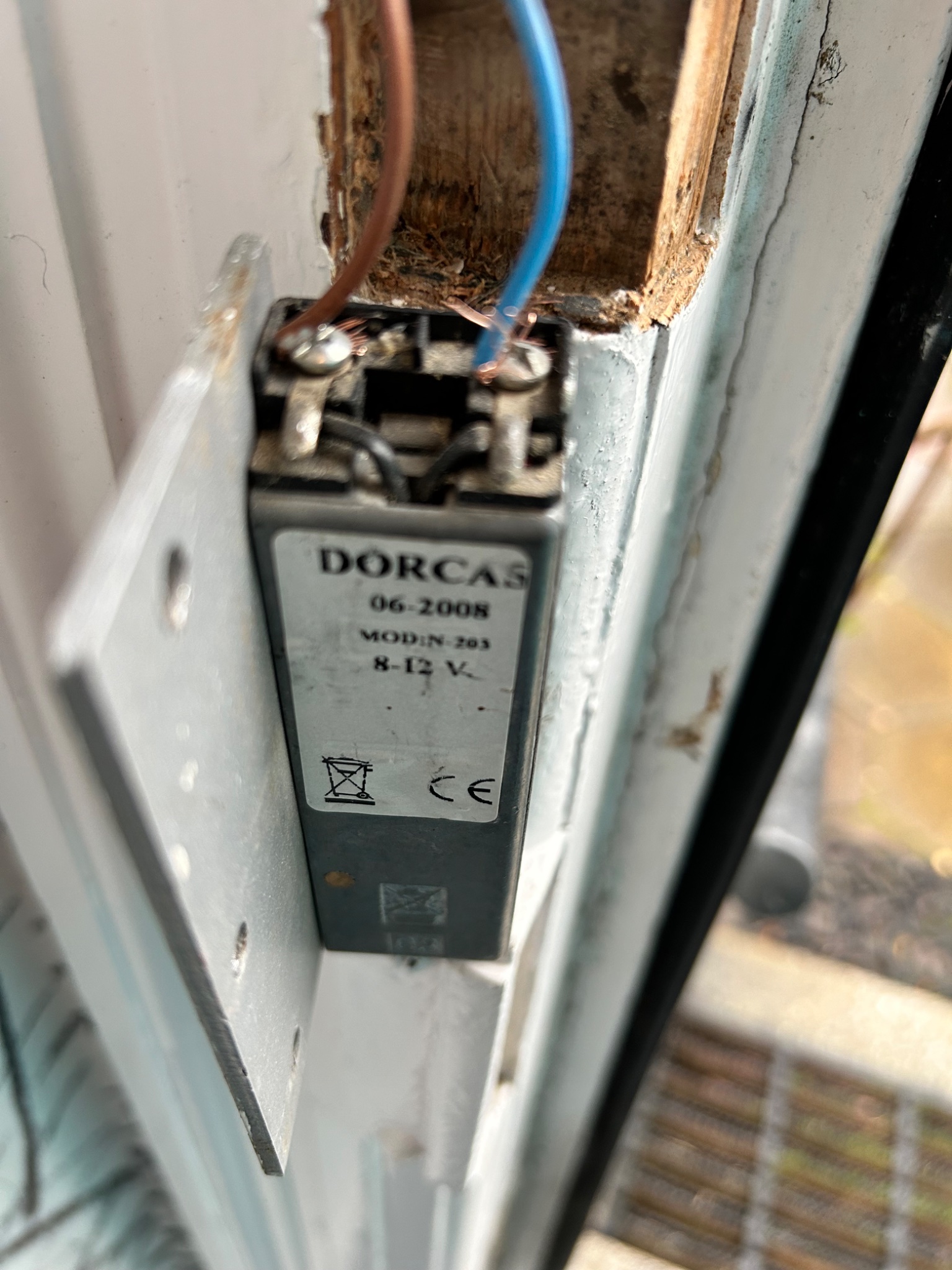

Attaching a pic, but no, can’t see + or - on the strike.

Pic of existing strike

Hmmm. How long are the wires? Assuming that you're measuring correctly, that suggests that there may be long wires and a significant voltage drop, and you're lucky that the solenoid works at all. Try measuring at the other end of the wires?

Update: the strike’s supply comes from a camera doorbell, which can be activated using a fob, mobile phone or the video monitor in the house. Supply to the doorbell comes from the video monitor, which gets its supply from a 24v DC transformer plugged into wall. Supply to the doorbell is 24v DC, confirmed by multimeter. However, when activated, output from doorbell to strike is 2.4v. This is confirmed by supply at strike which is also 2.4v DC. My existing strike which requires 8-12v worked fine with the camera doorbell supply?!
I would suggest your issue is volts drop, basically the resistance of the cable feeding the strike, is so high, the voltage is being lost within the cable itself. That is easily confirmed, if you check the voltage at the source end, when the release is pressed, and it shows an adequate voltage.
The fix, is to install a larger diameter cable, or you could try doubling up the one you already have.
