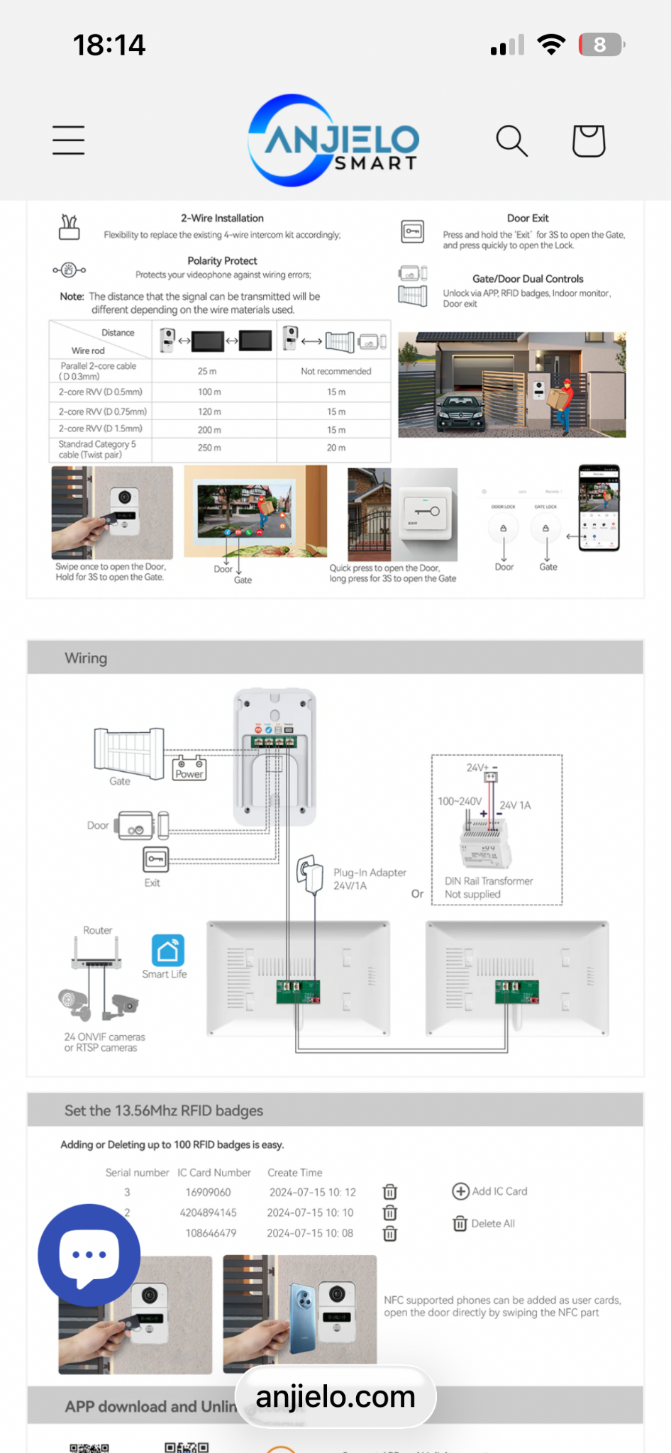

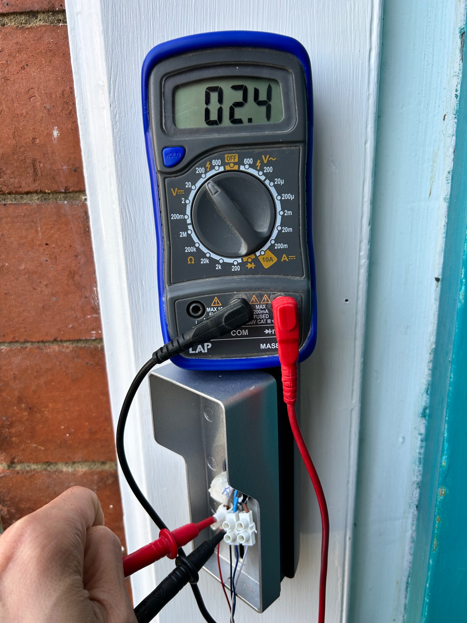

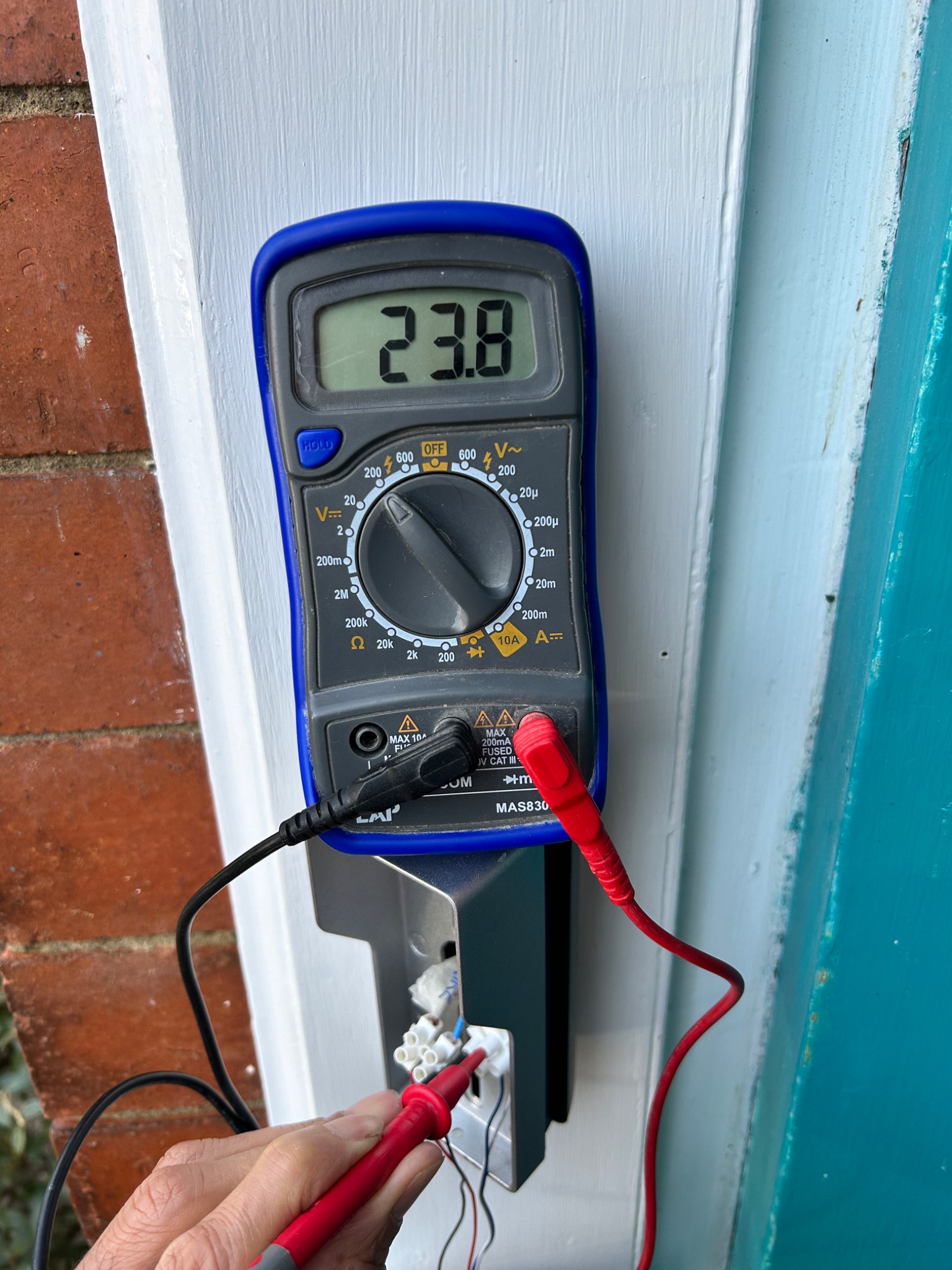

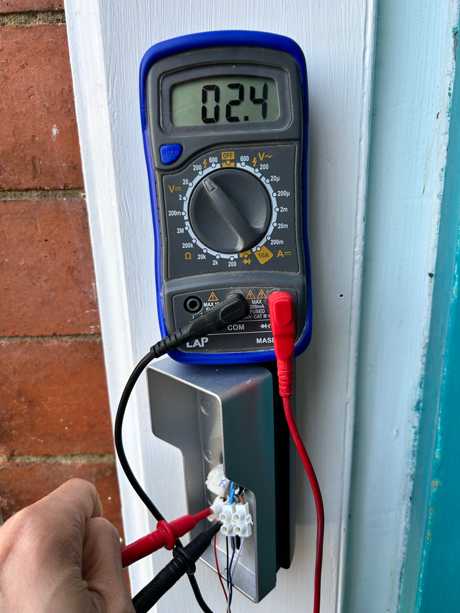

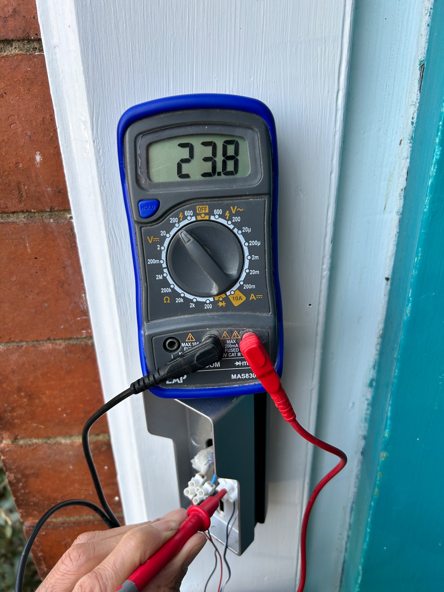

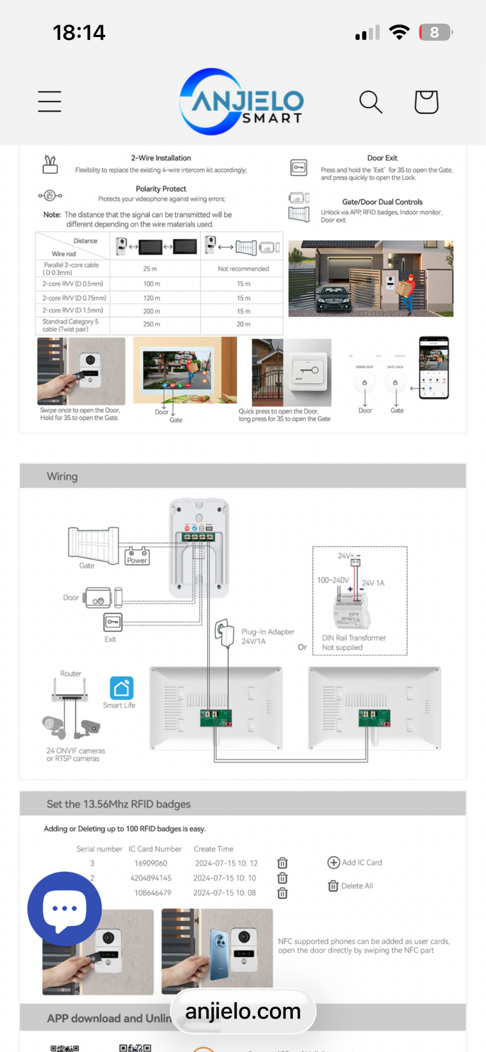

I’ve double checked readings at camera doorbell. Supply comes from video monitor and is almost 24v (see pic). However, when activated, the output from here is 2.4v (see pic). The strike - 3m cable run - also receives 2.4v, no drop.

The strike will only have the correct voltage when you activate the door release …are you measuring the voltage when you activate the door open button on your monitor ? …also try it with the release disconnected it won’t be voltage drop on that cable at that distance ….more than likely you have burnt out the coil putting 24v dc into the lock release coil …
Yes, measuring when door release is activated.
The old release still works. It worked well with the old Yale lock on the door, and had done for last 4 mths. It just doesn’t work with the new high security ERA lock because the throw is too long.
I’m not convinced 24v is present when the door release is activated. Hopefully hear back from manufacturers soon tho.
In fact, I should measure voltage once release activated after disconnecting old strike to see if that makes a difference. Will try this tmrw.

Have you tried disconnecting the strike (just one wire is adequate) and repeat the voltage measurements above?
A very quick google search for the resistance of the 203 strike comes up with 8 (or 17)Ω which would be 3(1.4)A at 24V, my guess is the PSU is incapable of providing 3(1.4)A.
