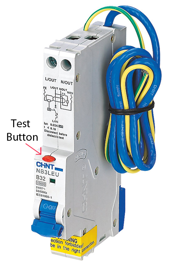

I have three switches which will turn off groups of lights, most people do RCBO.jpgunder a tin lid and where unlikely to be operated in error.

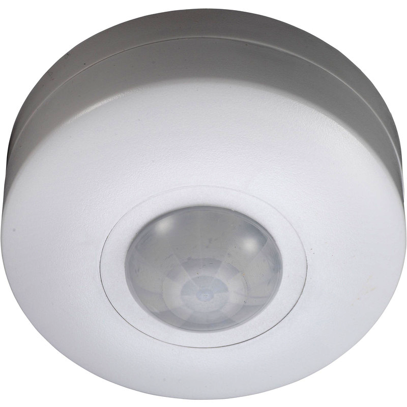

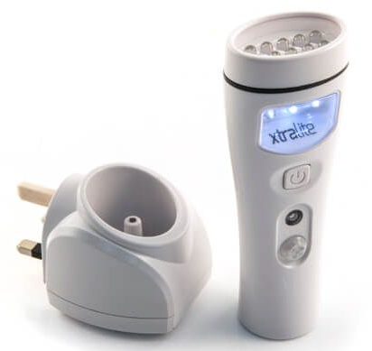

A PIR 1672241277710.pngcan turn lights on/off, I however use some thing like this 1672241439472.pngit also means with a power cut, can still see way down the stairs. And it auto switches on as we pass it.
