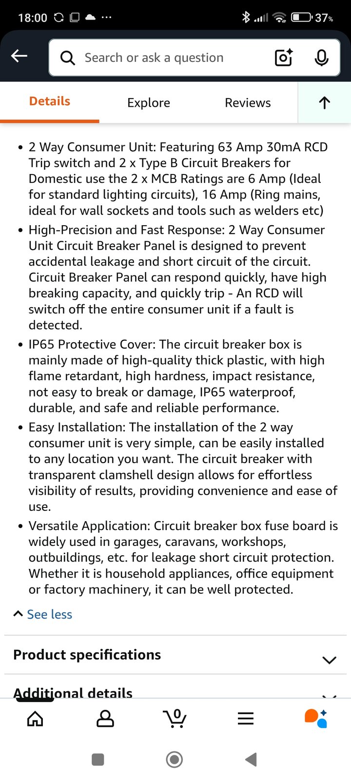

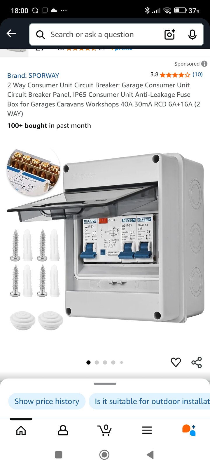

Hi guys ,may be a dumb question but will a consumer unit be better that the junction box? Something like this? Thanks
NO!!!! Why on earth would you want/ need to do that?

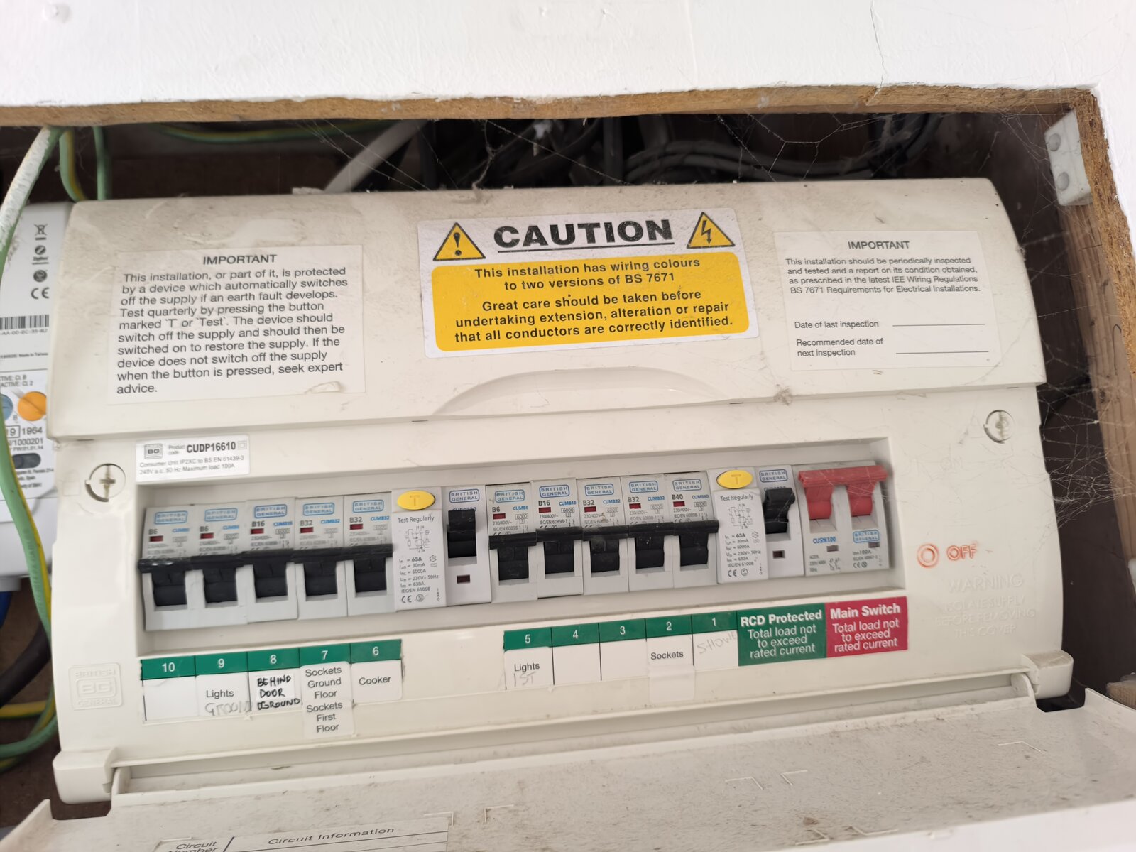

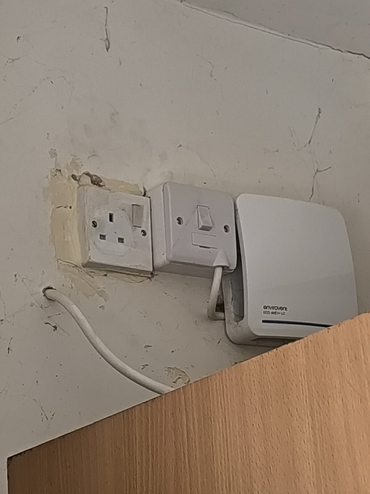

This is the fuse board in the house(see pic) and the socket in the kitchen I'm gonna hook the cable that goes to the garage(see pic). I was going to just plug it in and have a junction box in the garage to connect the sockets and lights ,+ a light switch. But I will swap the socket in the kitchen for a spur (let me know if is wrong) ,connect garage cable to that spur and then connect the sockets and lights+light switch in the junction box in the garage. Also, between the junction box and the light switch I will add another spur with a 5Amp fuse,as suggested by another member.
Coming back to the questions :1 I think the main board will isolate the circuit.(Let me know if I'm wrong. Again, limited knowledge about electrics)
2. Im assuming that if I connect to the kitchen socket , the circuit will be protected by the RCD from the main board?(May be wrong?)
