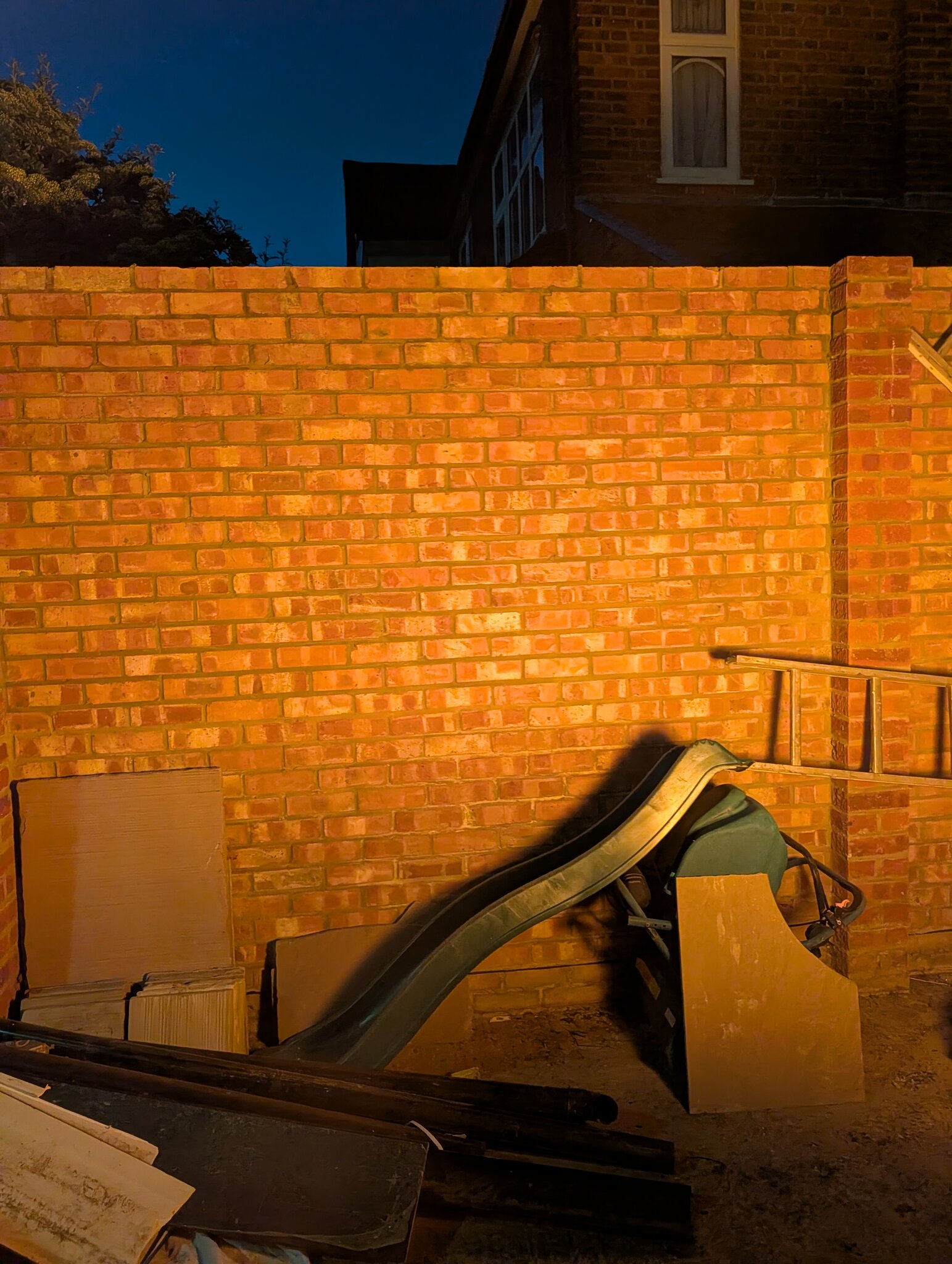

Brick wall is 2.3m tall, the other block wall is 3.3m tall (it's built up from lower garden ground) but still at the same top level all the way round. The back block wall has a return where it is attached to the brick wall return with starter kit. The front (garage door opening) has a small return of 2 bricks thick on the brick side.

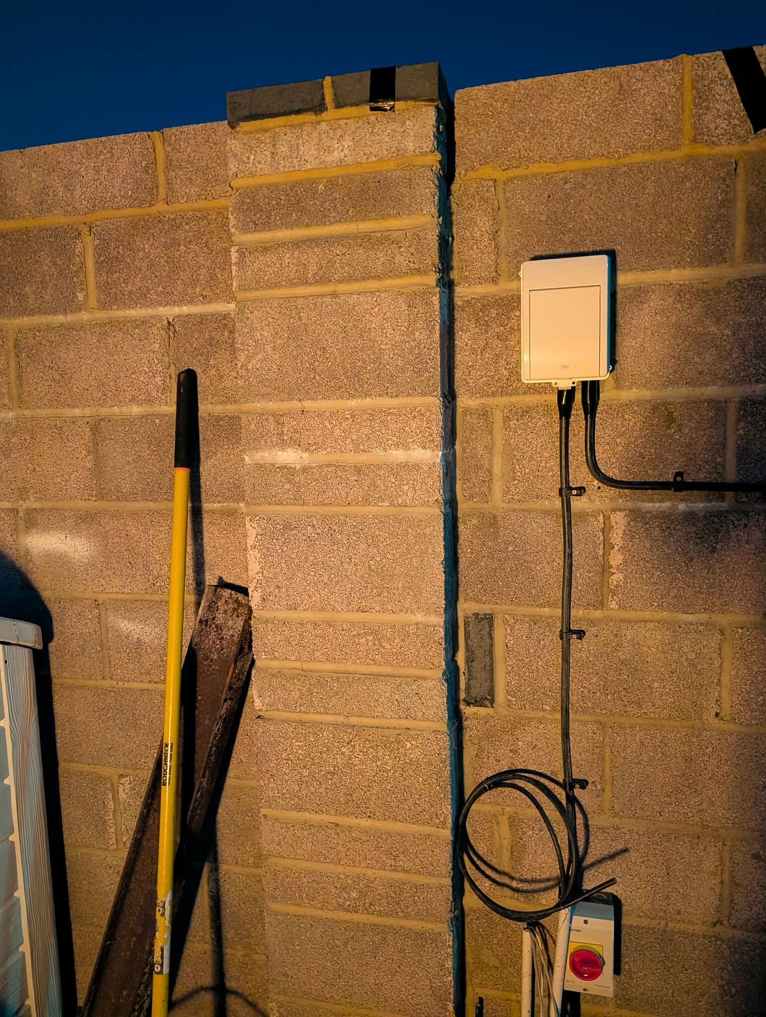

Of just a little more concern is the height of the block wall above ground level (3.3m). Wind applies not just horizontal compressive force on walls but, more significantly, suction often on the lee side.
Whenever there have been heavy gales across the country, news footage usually show walls such as gable walls, falling outside a house rather than falling inside. This is the effect of wind suction.
The 3.3m high wall will be OK with the wind blowing onto it from the lower side, but there will be little to nothing to tie it back when suction wants to pull it outwards.
You need to ensure that this wall particularly is well-tied at roof level. If possible, I'd be inclined to tie it to the concrete floor inside as well with a few restraint straps - this would help to an extent.

Thanks for all the help on this. One last quick question. As mentioned I have pillars on both sides but they do not match up in location. If you had a choice to rest the steel on one of those pillars, would you choose to do it on the taller 7.3 concrete block wall or the shorter brick wall pillar?
Thanks!
I think it would depend partly on the area - and hence the weight - of the roof the beam is carrying. The more slender a wall is, the less weight it can safely carry.
If the conc. block wall is 3.3m high and 100mm thick (?) it already exceeds the maximum slenderness ratio (height/thickness shouldn't be more than 27)
Regardless of where the beam sits, the wall should be tied at the top to the roof.
A diagram of the structure would be more helpful.

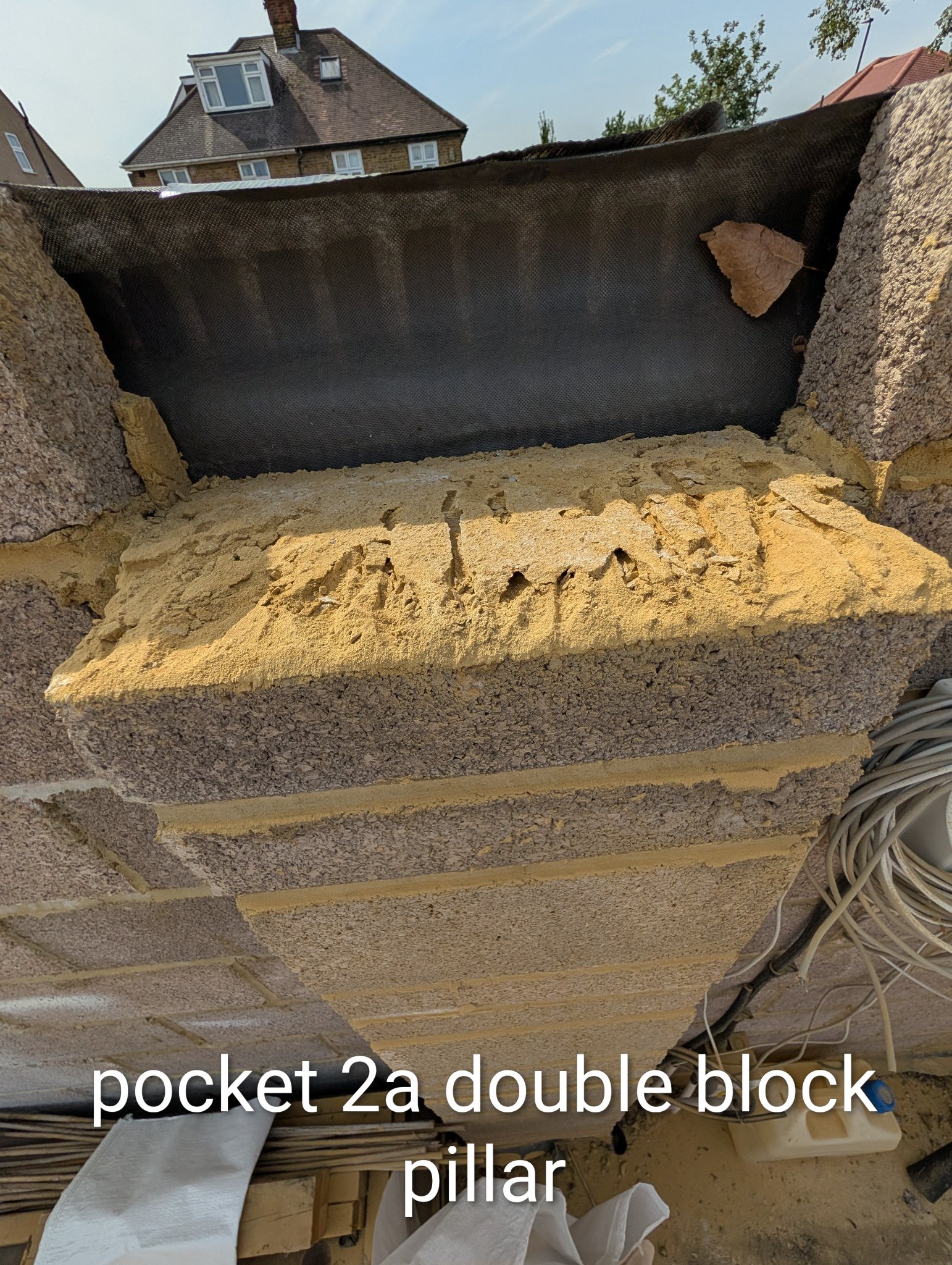

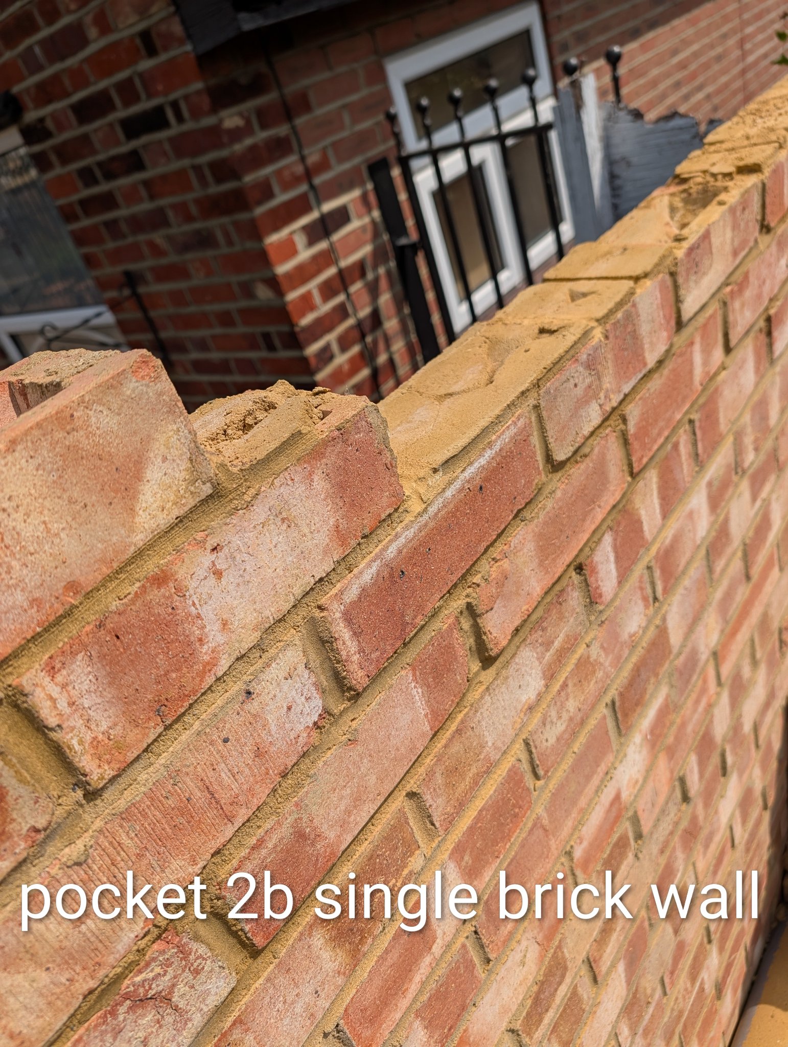

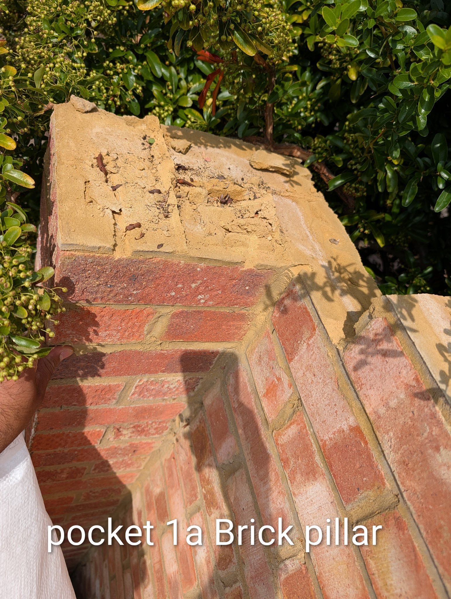

I have now cut out the pockets/dropped two courses ready for the steel plates and want to double check with you the following
To check/confirm to make sure I am fully using the right size steel plates.
Pocket pair 1a. Brick wall, brick pillar dimensions 205W*317D
Pocket pair 1b. Block side single block 440W*100D
Pocket pair 2a. Block sides double block pillar 440W*215D
Pocket pair 2b single brick wall 215W*102.5D
I know before you said to use a 215 x 100 x 12-15mm steel plate. Would it be wise on pocket pair 1A and pocket pair 2A to size the plate to the dimensions of those pockets/pillars available?
And then for pocket pair 1b. Should I change and use a steel plate that is 440x100 considering the block is wider than the bricks? Or should I even go longer to spread the load more along the wall.
Finally for pocket 2B, I know you again said use a 215 x 100, would you say that's still best? Or given that I have made a wider pocket as per the picture, I should get a longer steel plate to spread across maybe three bricks
