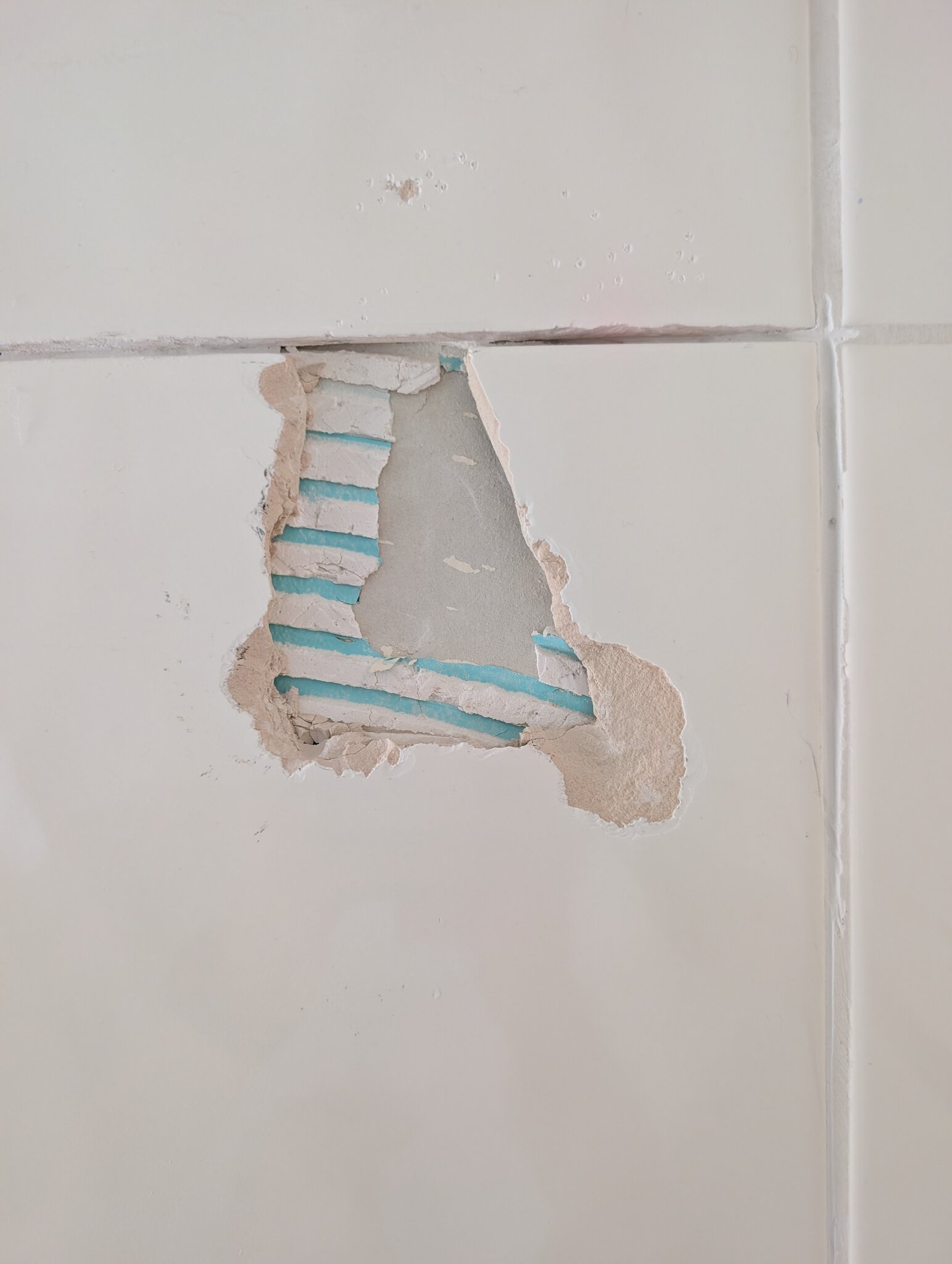

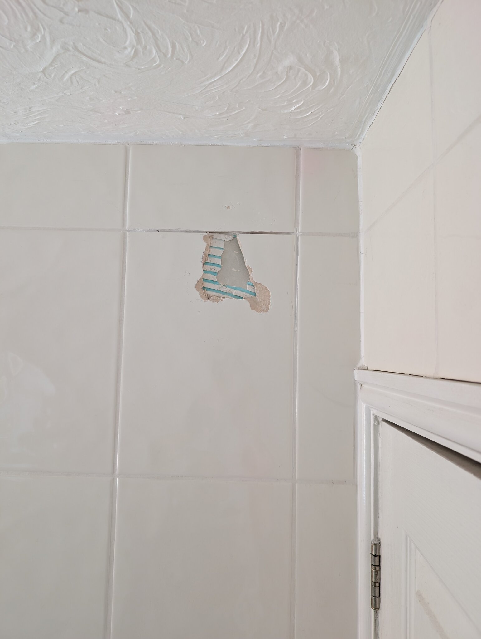

Hi all,
I'm going to be attempting to renovate our bathroom in a months time. It's a 90s house and most internal walls are stud and plasterboard.
My plan was to remove the tiles as cleanly as possible from the plasterboard, and presuming I didn't destroy it in the process just to re-tile on the existing plasterboard.
I have had a little bit of an exploratory look behind the tiles and I am wondering if it is actually worth me wasting my time trying to remove these tiles and I would be better off just ripping down all the walls and starting again.
From the hole I can see the plasterboard is covered in a blue/green material which I presume is the moisture resistant covering. However, this material is pretty much coming away with the tile adhesive and I strongly suspect that when I scrape off all the adhesive, most of the blue/green stuff is going to go with it.
Would I be wasting my time just trying to remove the tiles?
Thank you

Yes, you would be wasting your time, remove the boards too, then you can replace with a moisture resistant plasterboard, or cement board/insulated tile backer board for wet area or external walls.
It's also possible to tile over existing tiles, if time or money are an issue.

Ps. Looks like your green stuff is just painted wallpaper that's been tiled straight on to.

You're better off replacing or overboarding the plasterboard with a cement board.
Easy enough for a diyer.
Skim and tape the joints and screws and then tank it.
Again, easy stuff.
Tiling is a bit more demanding in terms of experience.
Use a levelling system and it will be better than done by eye.
To make a niche you need to get to the studs and add a couple of noggings, then line it with waterproof membrane, cement board, then tanking, otherwise the back might get wet.
Take your time and do not use rapid set adhesive.
You can buy adhesive that remains workable for a few hours if kept in a closed tub.
And finally, make sure to get the correct adhesive for your tiles.
Ceramic and porcelain stick in different ways; check the label.
