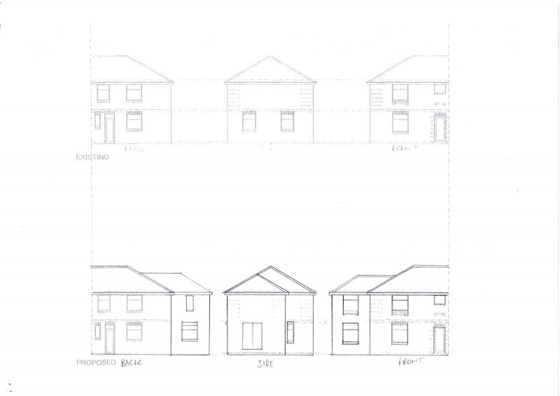

Hi all,
We are having a 2 storey side extension (5.1 x 3.7m) on a 1940's ex-council semi with hipped slate roof. Extension will have new hipped roof to hipped roof. Existing roof is backfilled which is all dropping off, slates and ridge tiles starting to slip and needs sorting so we are having it stripped, felted and relaid, sourcing reclaimed slate, all being done at the same time. We have arranged own scaff which is up.
Sorry for poor quality image - only jpeg plan is this one.
Joiner and roofer been to see us, liked them, quoted as follows:
- Joiner - fit new trusses to extension plus fascias, sofits, guttering whole house BEFORE SLATING (labour only) - £800 + VAT
- Roofer - strip, felt and relay existing and new slates, including battens and lead - £2k + VAT
- Truss quote - £500 + VAT
- UPVC SFG quote - £300 + VAT
We can get slates for about £1.40 each
This all adds up to £4.2k + VAT for new roof and reroof.

1. Seem fair prices? Joiner seems good value and truss and UPVC quotes seem good, not sure about £2k for roofing labour tho.
2. Joiner wants to fit trusses then UPVC before slating so that "there is a line for the roofer to go to with the fascias being there". We don't want UPVC up there before roofing and extension finished - it'll get damaged. Plus the roofer needs to go off the existing lines as it's a semi or it won't match the neighbours surely?
3. Anyone keen on Ubiflex instead of lead? That might help nip the price down.
4. This is a raised/dropped collar roof? (The bedroom ceilings slope and we have roof beams in the corners of the rooms). This gives us dreadful cold bridging/mildew/condensation issues and we MUST address this while the roof is off. How can we insulate the new roof adequately to stop these problem areas happening again. We have cavity wall insulation and will be renewing loft insulation and having eaves vents I believe. How do we keep roof space ventilated but insulated? Giving us headaches.
No, don't think like that
The facsias, soffits and gutters should go up before membrane and tiles so that the eaves tray and tiles are set to the gutters.
It wont be damaged
Ubiflex is OK, but is it that much cheaper than lead? If no use lead
Your designer should have specified how to insulate the rafters at ceiling level. You'll need insulation between and under the slope

The upvc fascia need not go on if you go with the fascia cap method.
This involves fitting the timber carcassing fascia first, which will deal with the tile rest and eaves tray detail, then the fascia cap can go on later.
All the roofer need do is allow an extra say 15mm on his overhang.

Guttering will be fitted after the roof tiler has finished.
You will need to assume where the rainwater gullies will be best positioned and then fix your outlets and downpipes accordingly. Fix all guttering prior to removing scaffold. We usually fix it having removed the top scaffold lift, as it is easier to reach up than to crouch down.
As far as the soffit and fascia detail is concerned then yes, it all needs to ultimately line up with the existing if these are in plane. Measure the overhang, timber fascia thickness, upvc fascia thickness and work back to the rafter ends, trimming accordingly.
The soffit boards are supported on timber cradling that is fixed to the rafter ends. The fascia is usually fixed directly into a trimmed rafter end.
The actual depth of the fascia is dictated by existing fascia. Or you choose a depth that provides enough 'kick' for the first course of tiles and collects the soffit.

Carpenter, labour only £800. to birds mouth and fix raised tie trusses, girder truss, reducing valley trusses, loose hip construction, wind bracing, lateral bracing, facia and soffit is a reasonable price. However check that he is VAT registered and has VAT number, as most labour only boys are under the Vat threshold in what they earn.
Roofer,. labour only at £2k is a fair price especially if he is supplying lead, battens and Tyvek breathable felt or similar. Check that he is supplying breathable felt, as it is not cheap. Suggest GRP valley instead of lead or Ubiflex
Truss price £500 plus all loose unfill as detailed above is about right.
UVPC near enough.
Slates depending on size, sound touch high, but then again, do not know your part of the county.
Always fit facia and soffit before tiling. You have got to work hard to do any damage.
Always fix gutters and down pipes after roof tiling completed. If you have no drainage in, take down pipes down to below DPC and let them run on garden or drive until drainage in. With permeable felt such as Tyvek, no ventilation required to roof space.
This is a raised/dropped collar roof. No it is a raised tie construction. In the new build, insulate from below raised tie before tacking ceiling. In the old build insulate raised tie as soon as roofers stripped of slates and battens. Use either 300nn fibreglass or 100mm GA4000 Celotex. You can either insulate remainder of ceiling before tacking or after tacking. Cut some battens out below the fly over to gain access.
