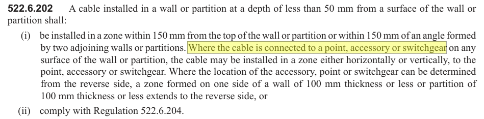

Would the cables be connected to a point, accessory or switchgear on the surface of the wall?
If we saw one of these in the middle of a wallView attachment 422866Nobody, not even Flameport or mister Mindy would give it a second thought, why anybody questions a perfectly normal electrical accessory I don't understand.
Maybe those who do are looking at what the regulations actually say.
As Eric observed not very long ago, some people have a tendency to look at regulations, and decide that they say what they want them to say, and deny the truth about what they actually say.
A blanking plate is not an accessory with a cable attached to it. Therefore it does not create any zones in which cables may be concealed.
It really does not, and that fact is made blindingly obvious if you look at what the regulations actually say, rather than assert that they say something else because you want them to.
What question are you actually asking here,
My interpretation of your question is requiring surface mounted devices,
Seems pretty straightforward. What does it actually say?
Sockets, switches, FCUs, etc are on the surface. The boxes enclosing the connections may be recessed, but the accessories are on the surface.
That's the problem, the group of us in DM's don't know what it actually says.
So would the blanking plate not be on the surface of a recessed box?
So the question "Would the cables be connected to a point, accessory or switchgear on the surface of the wall?" is meaningless to you?
Does that quoted regulation talk about a point, accessory or switchgear on the surface of a recessed box, or a point, accessory or switchgear on the surface of a wall or partition?
