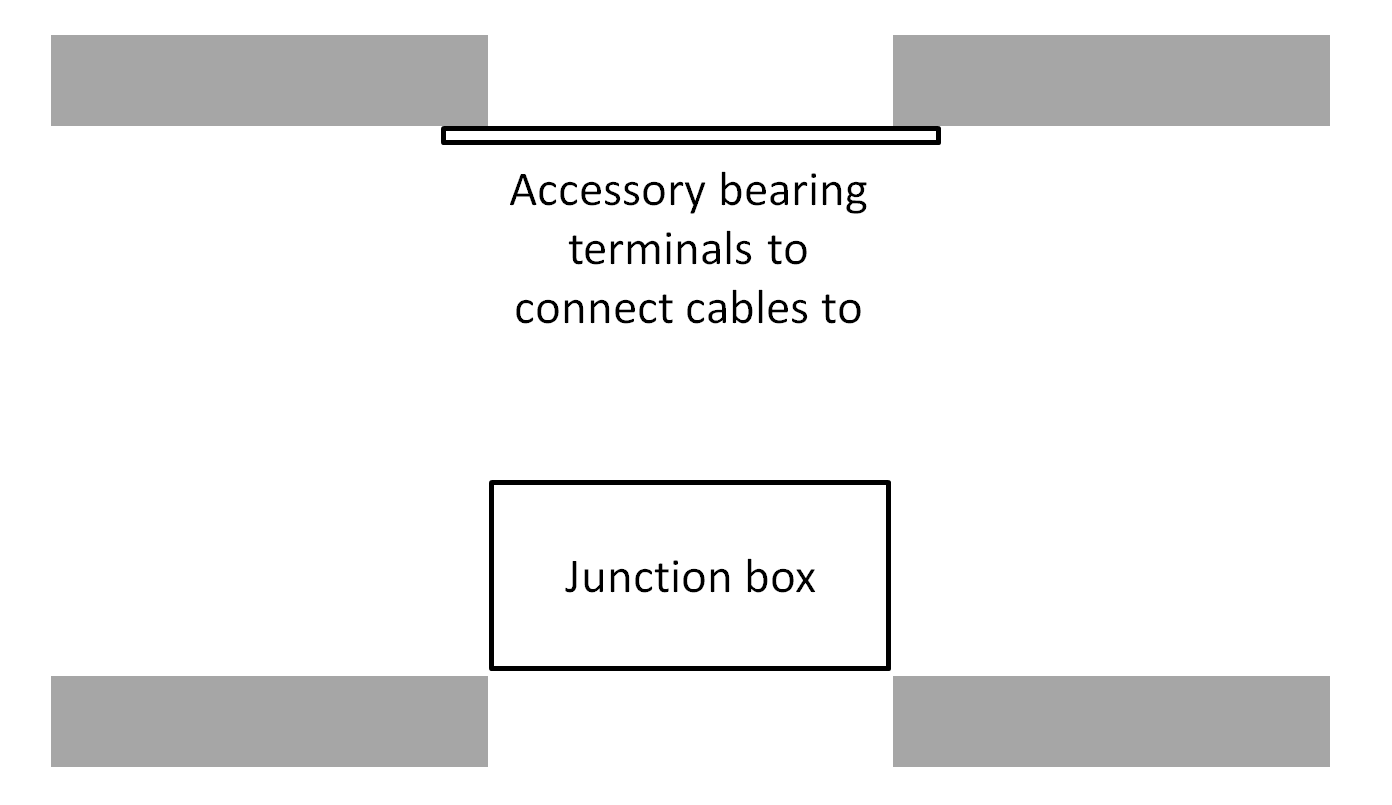

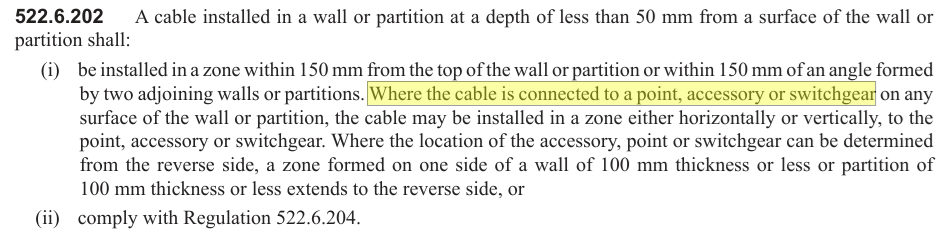

The simple fact is that that the regulation says
" ... Where the cable is connected to a point, accessory or switchgear on any surface of the wall or partition, ... "
A blanking plate does not have a cable connected to it.
A junction box recessed into the wall is not on the surface of the wall.

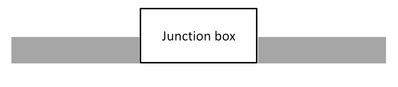

However terminals mounted in the recessed back box can have cable connected to it. Just in case you dont know what a junction box is and the way many of them have been manufactured I suggest you look them up, there is an almost unlimited combination out there.
However a junction box recessed into the wall with an exposed front plate is on the surface of the wall in exactly the same way as a 13A socket etc.

Where the cable is connected to a point, accessory or switchgear on any surface of the wall or partition.
It absolutely is not.
Even if you bring it forward so that it is flush with the surface of the wall it is still not on the surface of the wall.

There are many types. But whatever type is chosen, to create a zone for cables, the cables have to be connected to it and it has to be on the surface of the wall. Not recessed behind, not flush with, not merely visible, on it.

But "recessed into the wall" is not what the regulations actually say.

That is not what the regulations actually say.
They require the cable(s) to be connected to a point, accessory or switchgear on the surface of the wall or partition. A lid or a cover or a standard blanking plate behind which cables are joined or terminated does not have a cable connected to it

To create a zone, the wiring has to be connected to the accessory. A blank plate has no connections for wiring so doesn't create any zones.
Is that because the blank plate could be removed without touching any electrical connections, and plastered over?
