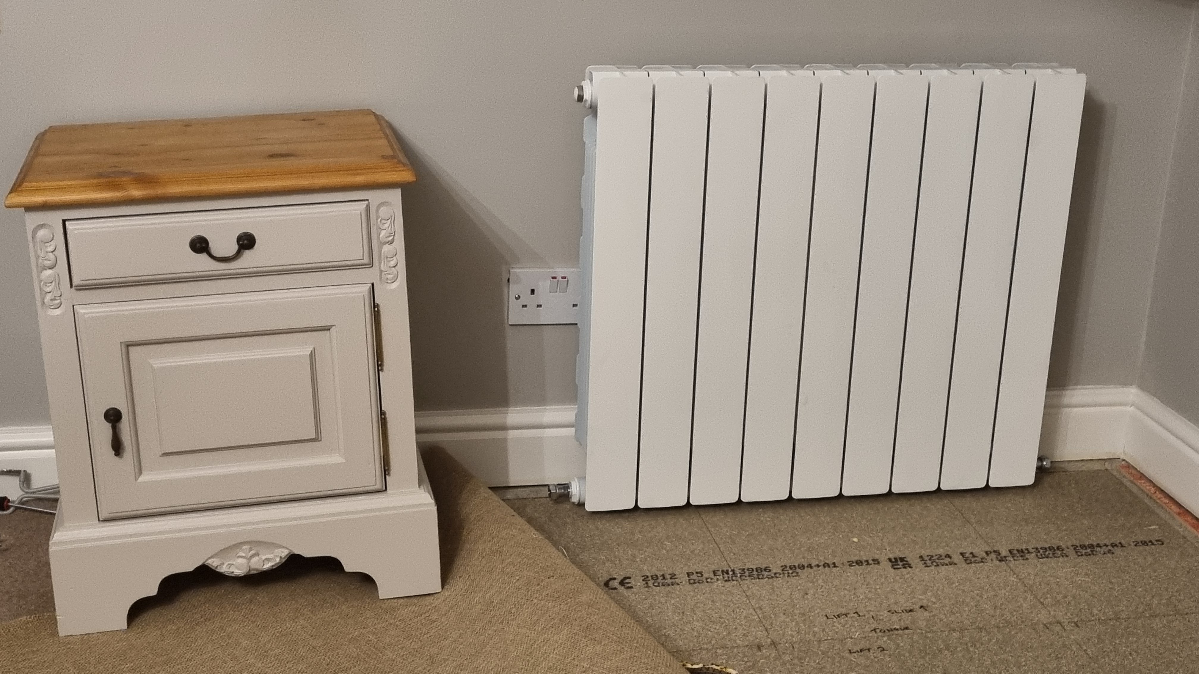

I'm in the process of moving a radiator and have an issue with an existing double socket.
Here's a photo showing the location of the bedside cabinet, the existing socket and where I want to place the radiator:
The wall is an outside wall; a breezeblock inner with plasterboard stuck using plaster dabs. I would assume the cables are run along the face of the breezeblock and the plasterboard fitted over the top of them.
As you can see, the position of the radiator means the socket needs to be moved to the left so it is positioned behind the bedside cabinet.
I already have access to underneath the floorboards and can see two cables running upto the socket from below. Having taken the socket front off there is absolutely no movement in the cables, suggesting they are possibly bedded in by the plaster used to fit the plasterboard. I was really hoping I could pull them down from the socket where I could have extended them, but without cutting away all the plasterboard and chipping away the plaster, I don't think that is possible.
Another thought was to cut the cables underneath the floorboards and connect up two new lengths to feed to the new socket, however, there isn't enough loose cable to do this as it is very tight in the way it runs up from the floor to the socket.
My third idea was to replace the double socket with a single socket blank, which would allow me to connect to the existing cables in place, and run them horizontally to the new socket. It will be necessary cut a channel from the single blank to the new socket as it sounds like there is plaster behind the plasterboard.
I would appreciate your thoughts, possibly another option I haven't considered? Any pros and cons of using a blanking plate, apart from it being unsightly? Obviously, I would ensure it could be unscrewed while the radiator was in place, so would avoid it being partly behind the radiator. I would prefer not to use a blanking plate, but it feels like the easiest solution.

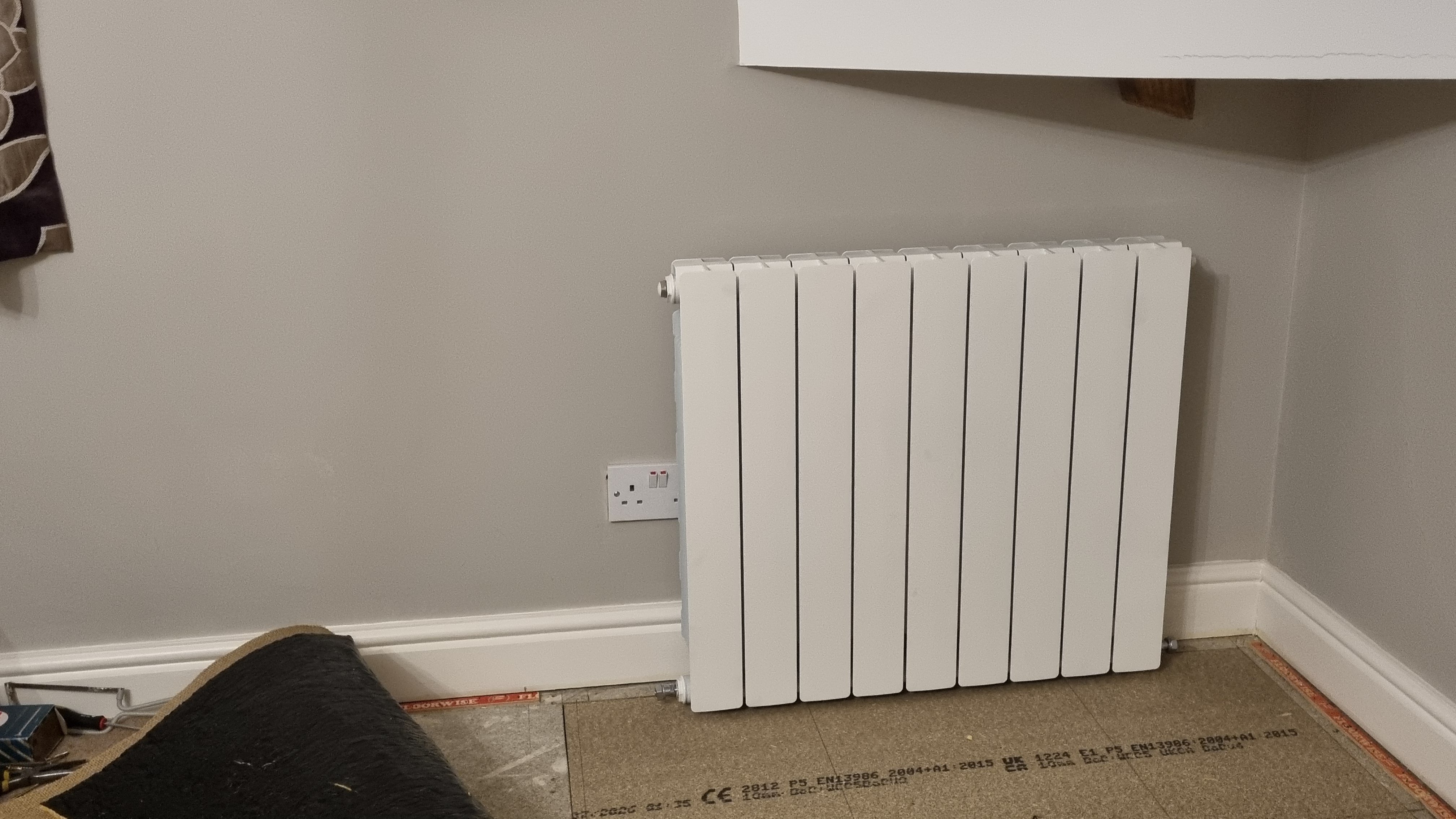

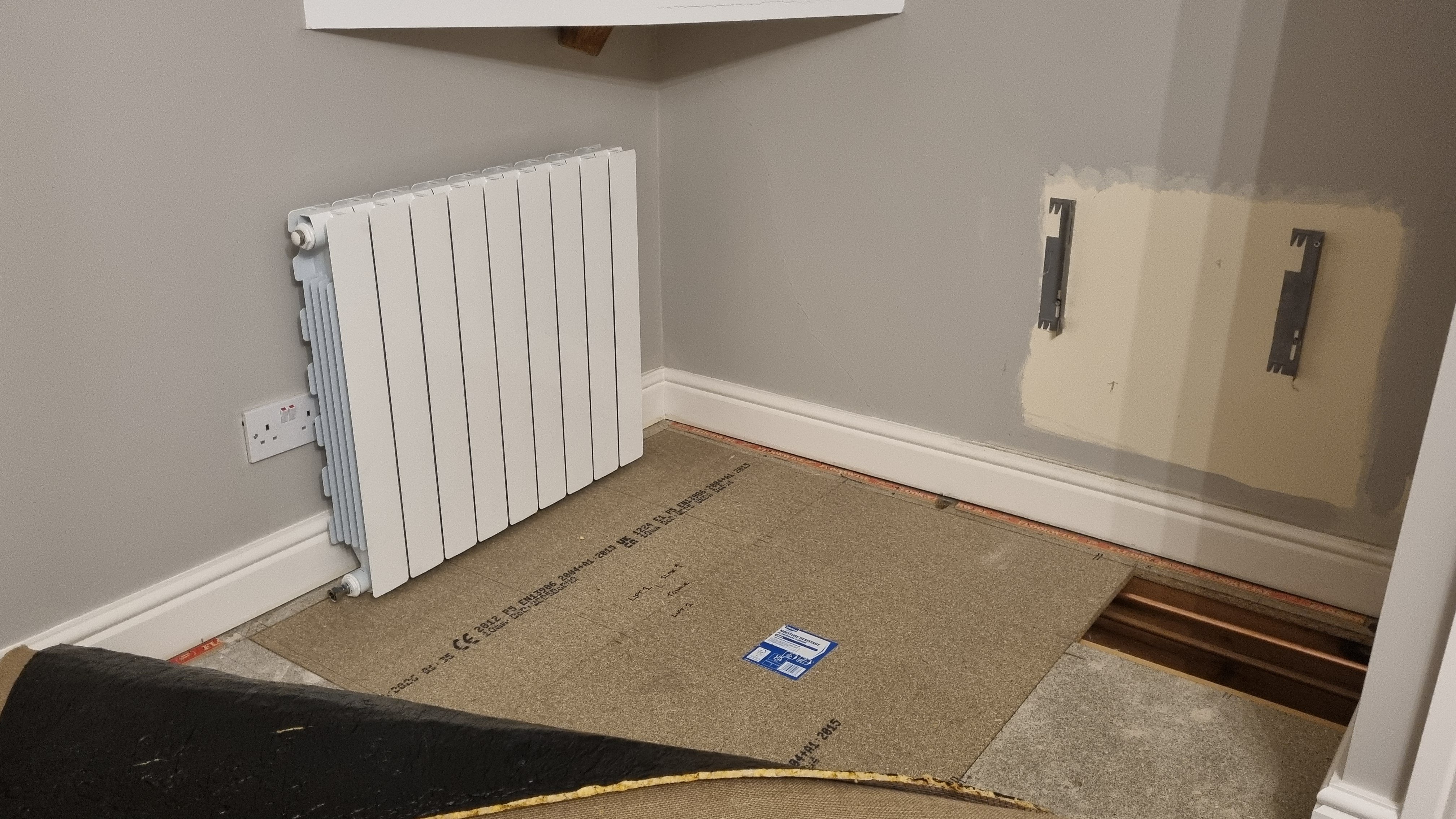

A few more photos of the area I'm working in.

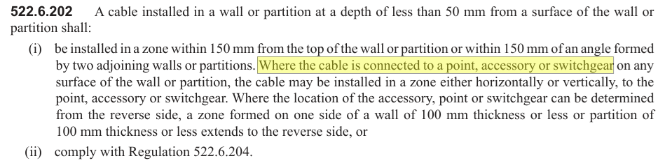

Ignore the advice above about the route of the cables
Cables can run horizontally or vertically from an accessory such as a switch or socket
How do you connect a cable to a blanking plate?
I know that but not everybody does.
Given the choice go virtual inline every time if it's easy enough to do which it is in this case.

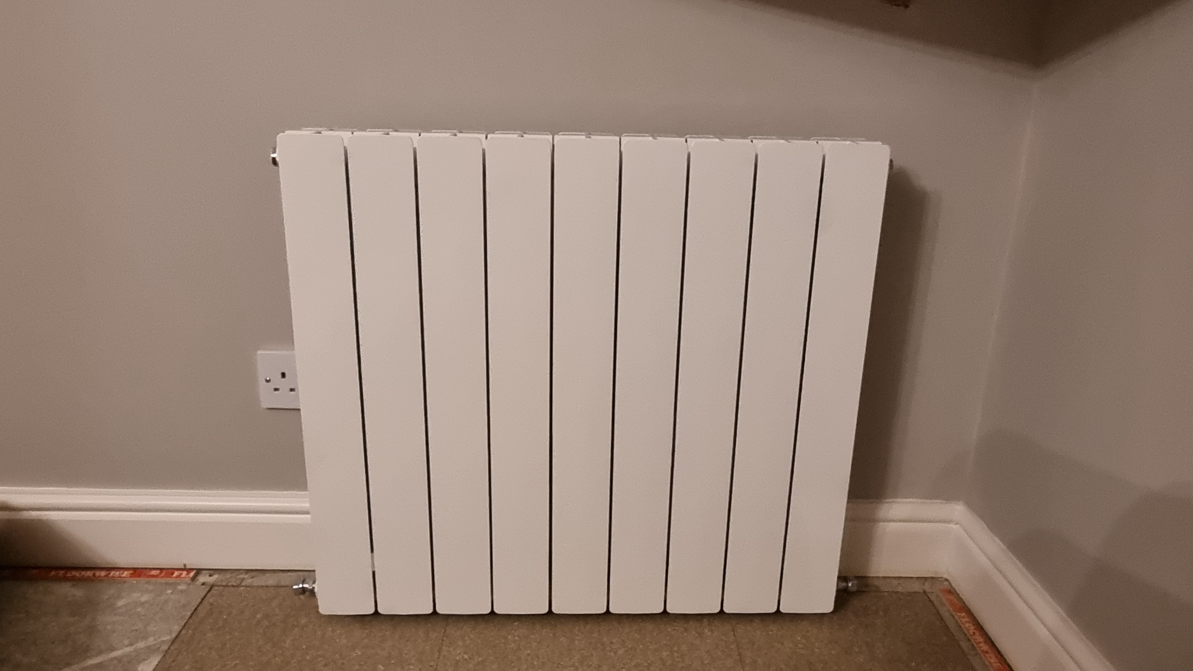

My wife suggested converting the double to a single and I could probably do this, although the two cables to the double are supplied through the centre holes of the back plate, but I think there would be enough wire to reach to a single socket placed to the left most position of the double.
I still think it will be far too close to the radiator and I know it will always bug me, but I may do this initially; replace the double back plate with a single and fill in the right hand side/redecorate. This will at least allow me to continue fitting the new radiator and if I then decide to, I can use a blanking plate on the single and run two extension cables horizontally to a new double socket to the left.

Out of interest, how strict is this rule?
If I were to go the whole way and pull down the existing cables from the existing double socket, which would probably mean removing all the plaster from below the socket to the skirting board and probably below the skirting board (somehow, and what a pain that is likely to be), I could use a junction box under the floor boards to extend the existing ring main cable to the new double socket.
However, currently, the floor boards directly below where the new socket would be located, haven't been removed and I would prefer not to if possible. The new cable run, could potentially be run from the underfloor access I already have (below the existing socket), but it would then be diagonally run to the new socket. I assume this is against regulations even if it is covered with a metal cable protector, since it should run either vertically or horizontally from one point to the next?

I would not be surprised to learn that what you remember is being shown that the regulations don't say what you want them to say.
An electrical accessory is an electrical accessory.
So how do you connect a cable to a blanking plate accessory?
