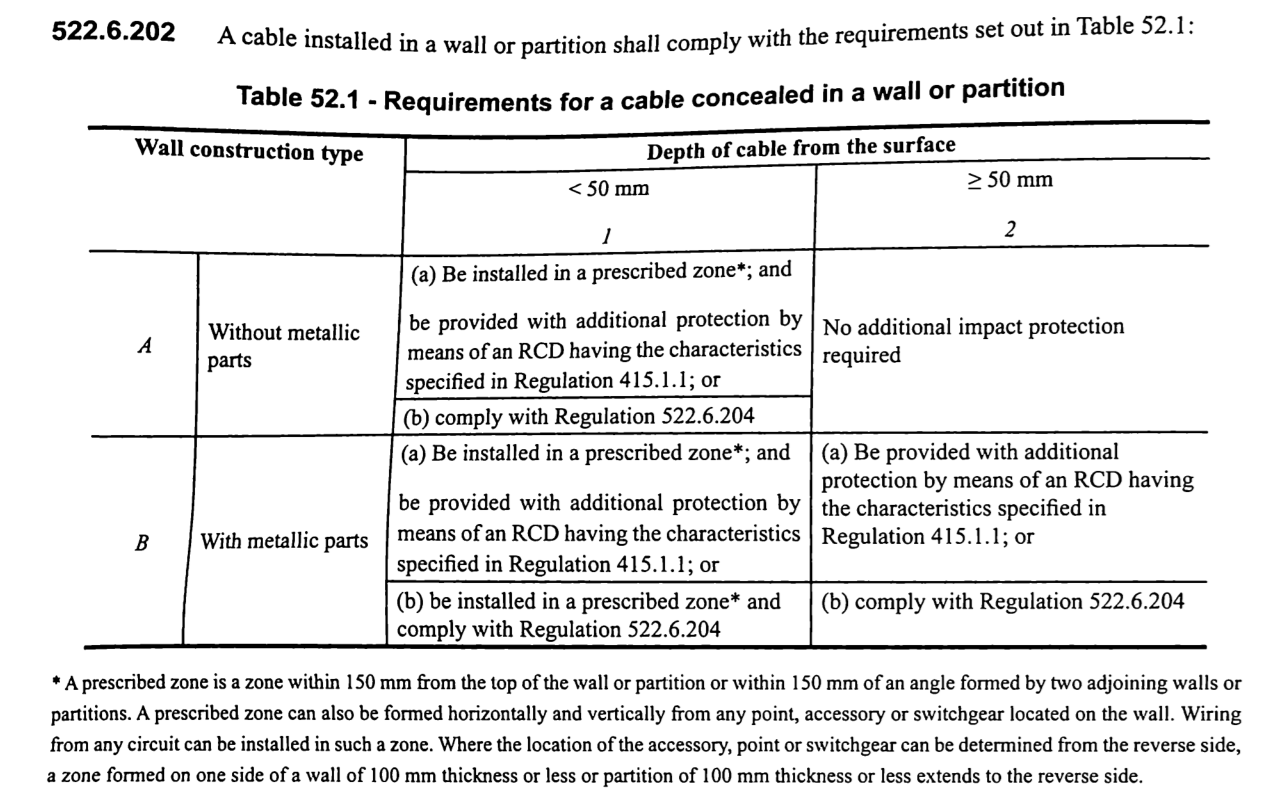

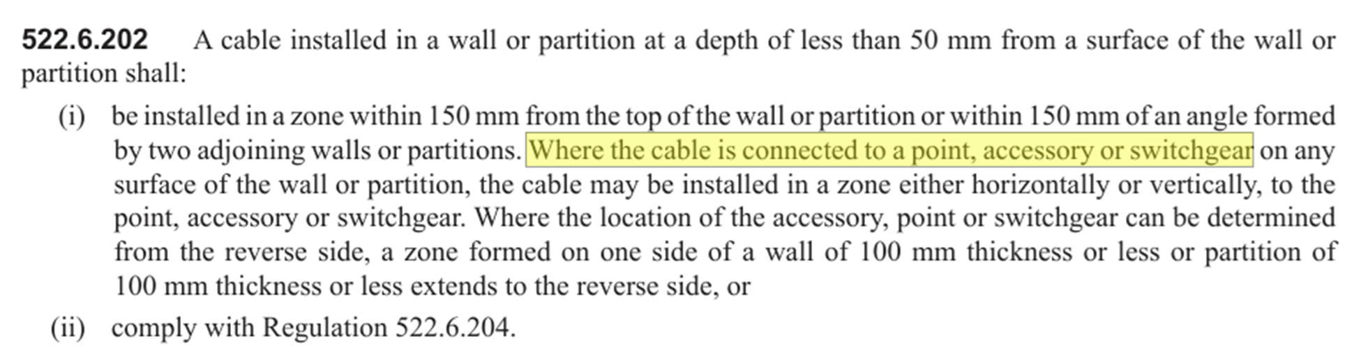

If people must argue over BS7671 regulations, at least argue over what is in the current edition.
522.6.202 has significantly changed in Amendment 4.
What point (no pun intended) are you making here?
That if
point (in wiring).
A termination of the fixed wiring intended for the connection of current-using equipment.
then a joint may not count as a termination.

I was going off the pre Amd 4 def. too.
There has been a lot of discussion around that reg and unknown to me, it has been updated to avoid confusion.
The opinion expressed to me by another IET helpline soul subsequently was that the spirit of the regulation has not changed, only the wording.
Occam's Razor.
If the wording did not match the spirit for decades then what people thought was the spirit was not.
