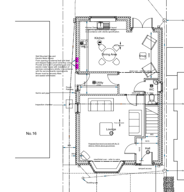

Ive just been reading the boiler manual and it says to have 600mm from the flue to any opening, the wall in this room is only around 600mm wide so obv that means a flue wont be far enough away. Are flues only allowed to exit a wall in a straight horizontal line or can you add angles so that i could pipe it so the vapour is at least 600mm from the door (ie add a vertical 90 to the flue and make it go further up the external wall)
if the flue can only go out horizontally then this sorts the fan issue out as the boiler will need to fitted elsewhere
Depends on your boiler. Intergas and Worcester permit horizontal out the wall then vertical up, no idea if others do but well worth checking before you buy.

id picked a combi and was looking through the manual, i havent bought one yet and after everyones advice i might just get a system boiler instead seeing as its a family house
Fair enough. You really need the heat loss calcs and the water pressure numbers before selecting your heat source and system design.
As you said the BTU or kw for each room and add on 3kw for a standard cylinder

the total BTU is anout 30k plus 3k for cylinder so 33k total. The water pressure will be on a 32mm pipe so they say they aim for 1.5 bar pressure and 1 litre per second flow
so what do you think will suit the design best? im tempted to go for combi to run 1 shower and have a cylinder for the main bathroom. I think thats the best of both worlds. Will the cylinder need a separate programmer to say a Hive or nest? would it be treated as a zone or something on one of those 2 controllers?

Pressure may be a bit low for simultaneous combi and unvented cylinder option but that would be my favourite (combi for shower, cylinder for the rest).
Yes ideally you'd have an individual zone for the cylinder. For a house your size you might want 2 heating zones so for control you'd need a 2 channel Hive for heating and another single channel Hive for hot water. Or Nest or whatever

pressure wise - id only see that as an issue with the combi powering the en suite shower wouldnt i?
i was wondering - with it being a new house with 100mm insulation in the cavity, should i go for 2 rads in the kitchen or 1? its quite a big space and i know how much of a pain a cold kitchen can be in the winter. What do you think?

Combi and unvented cylinder both rely on mains pressure to push water through to the taps. Your pressure sounds a bit low but if the flow (60 ltr/min) is as advertised you'll be fine, the combi will self-limit to 12 ltr/min leaving plenty of flow on the unvented.
2 rads would give a more even heat distribution at the cost of losing wall space. You can get underplinth heaters....
