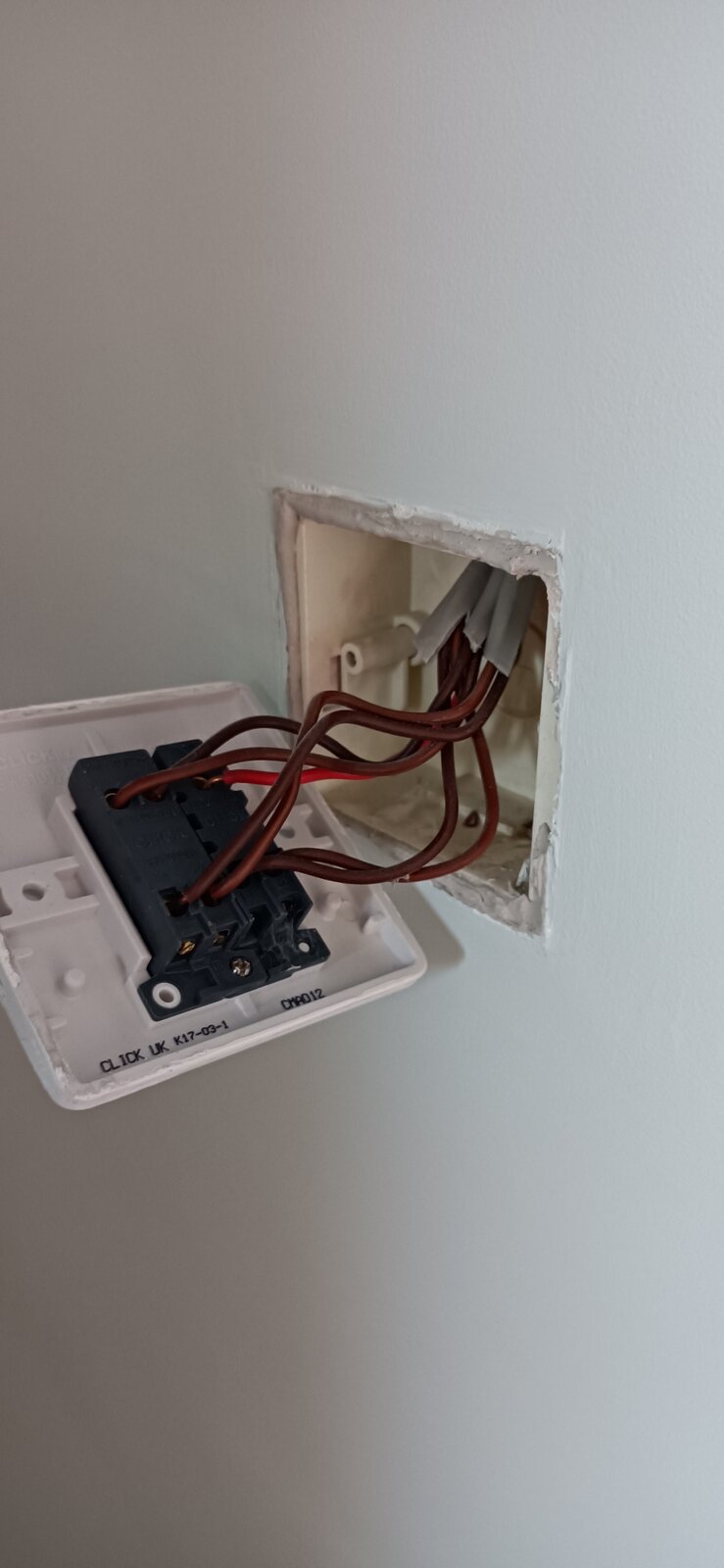

Hi everyone
I am updating the light switches and wall sockets in my house but I'm unsure how to go about replacing an existing light switch.
Existing wiring (I've added in L1 and L2 in green as the labelling is not visible from the angle I took the photo).
There are 2 switches, one to turn on/off hallway light upstairs (note: there is also one switch downstairs that also operates the same circuit), the other switch is to turn on/off the hallway light downstairs (note: there are two individual light switches downstairs that operate the same circuit).

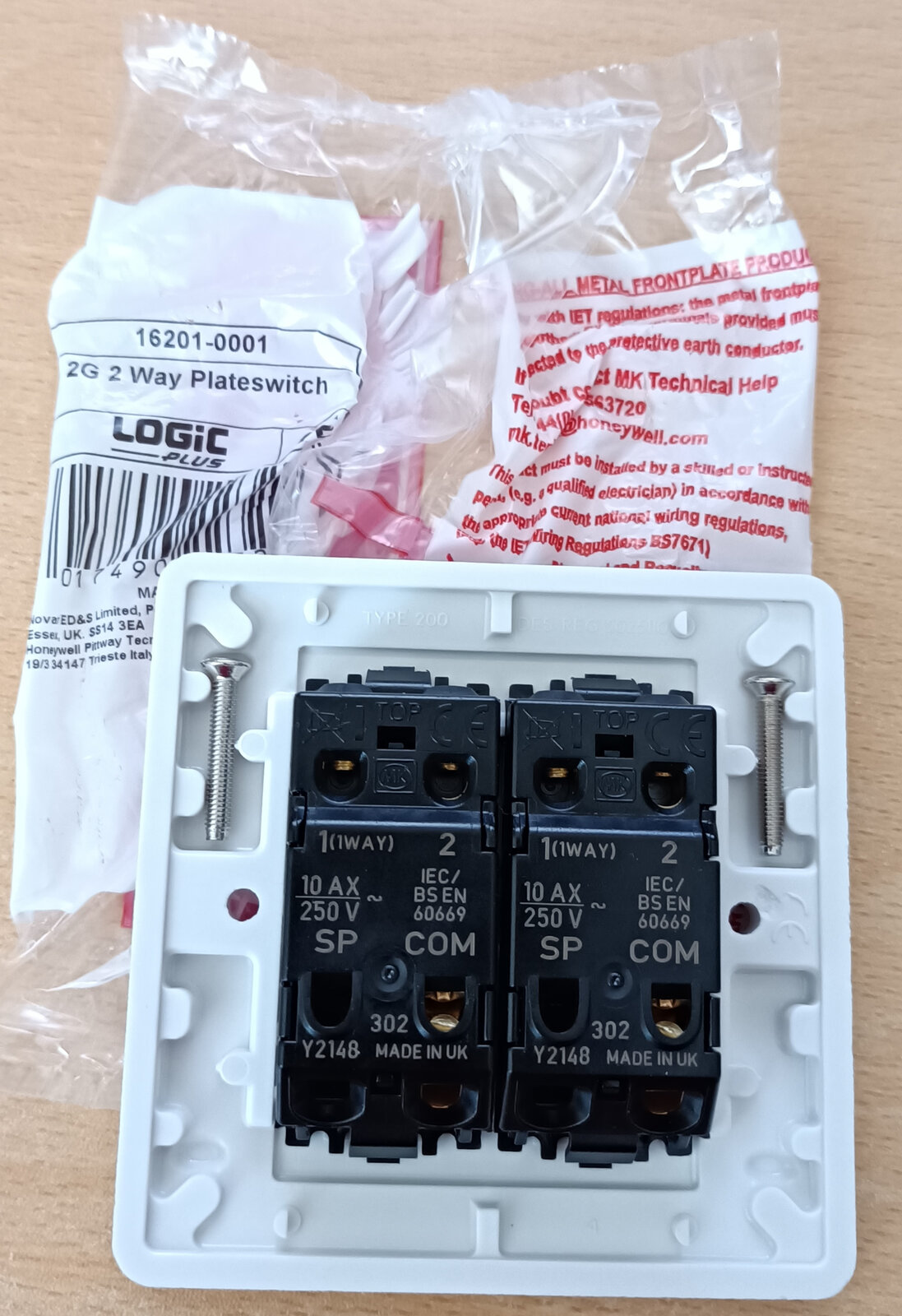

I've bought the following replacement switch from Screwfix. Is it possible to use this to replace the above switch or do I need a different one? Screwfix MK 10ax-2-gang-2-way-light-switch. Also, I have no idea how to wire the switch below if it can be used. Any advice welcome. Thank you. :)

You have the wrong switch. Your existing switch has an intermediate switch on one gang,and the other gang is a two way switch.
Your new one has both gangs that are two way switches.
Your best bet is probably to use MK Grid for this switch.
You will need an intermediate switch module, a 2 way switch module, a white 2 gang plate, and a metal yoke.
It will go with the rest of the MK stuff, but you will see a subtle difference.

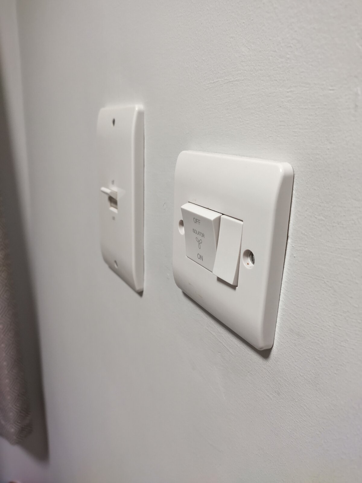

I used a Click Minigrid system for my en-suite. As you can see, the plate is a good match for the neighbouring MK Logic Plus 50A switch, but the modules are not like Logic Plus light switch rockers. In my case, it's not crucial, as the rocker on that MK switch is a different design to the lower-rated switches in the range.

When you have three switches controlling the same light, one of them needs to be an intermediate switch. Changing which one is the intermediate switch is likely to involve considerable rewiring.
Unfortunately to the best of my knowledge, multi-gang switches with intermediates are not sold by any major brand. So the only way to achieve a 2 gang switch with an intermediate switch and a regular switch is to use a modular range.
MK's modular range is known as "Grid plus", they offer it in most if not all of the same finishes as their regular ranges, but they do look slightly different from the regular switches. there is a "border" around each switch and the visible mounting screws are in a different place (on the 2 module plates they are top and bottom). Also they use a metal mounting grid which should be earthed.
To build a grid plus plate with a 2 way switch and an intermediate switch you will need the two switch modules, plus the plate and the grid.
https://www.screwfix.com/p/mk-grid-...witch-white-with-colour-matched-inserts/184jr
https://www.screwfix.com/p/mk-grid-...olour-matched-inserts/92060?_requestid=556409
https://www.screwfix.com/p/mk-grid-plus-2-module-grid-faceplate-white/84716
https://www.screwfix.com/p/mk-grid-plus-2-module-grid-plate/81450
Speaking of earthing the grid, your existing wiring looks bodge-tastic. Simply twisting wires together is not an acceptable way to join earth wires, it also seems very strange to me that there is a single red wire that does not appear to be part of a cable.
bit late now but scolmore do a 45A single gang switch which would have matched the smaller switch
