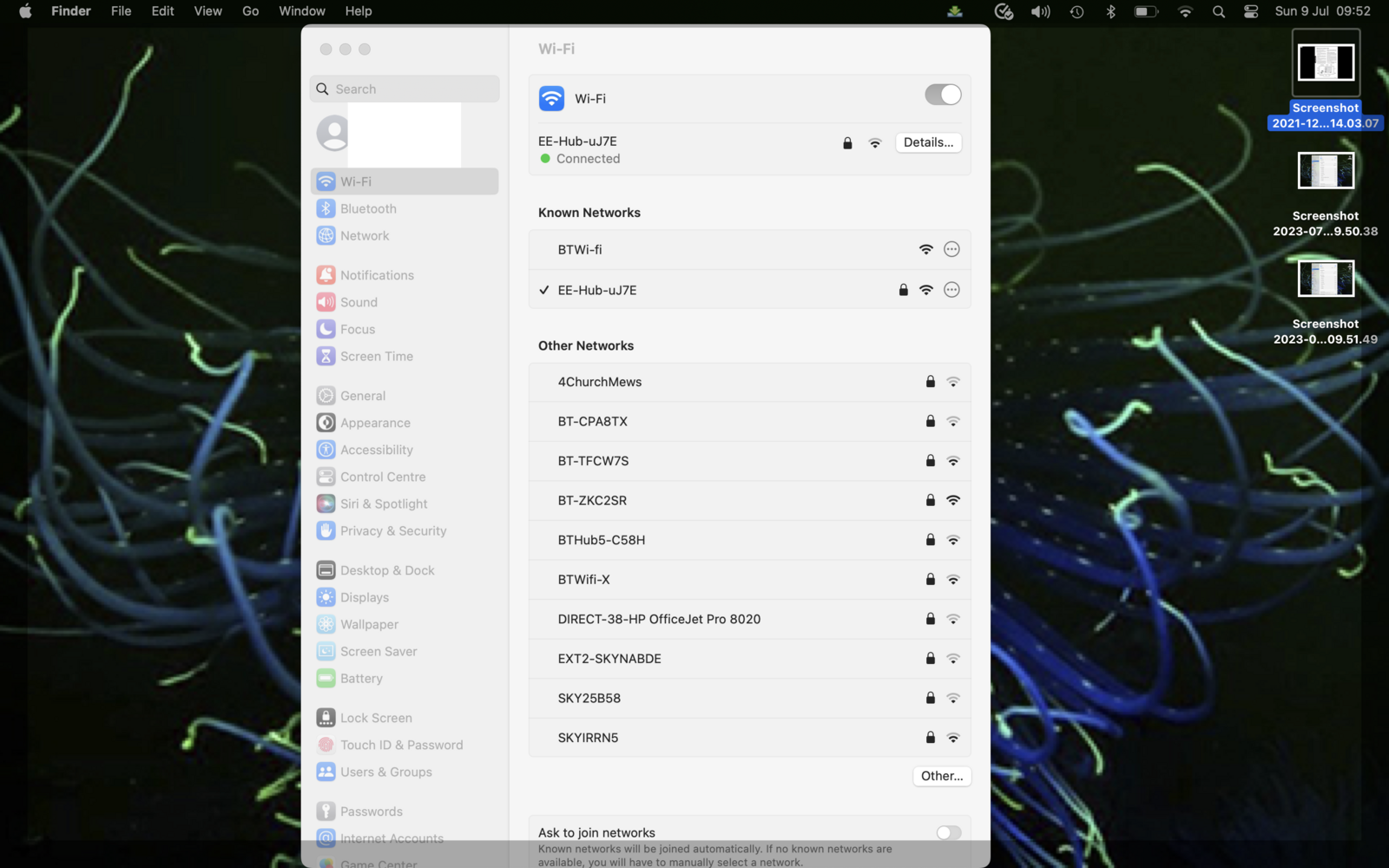

A final thought - in the screenshot you notice network 'BT-ZKCSR' - that is my new neighbours, When they had BB installed it effectively made my BB unusable as put that router with repeaters next to the adjoining wall. We could only use WiFi next to our router as their signal was that strong. Do think about your neighbours - WiFi coverage is not a competition but a shared wireless resource. If you can use a cabled network please do so.
When I was office bound my employers decided to switch from a cabled network (cause they had ran out of port and cable capacity) thinking it would be cheaper - it lasted less than a month due to the contention in the wireless network.

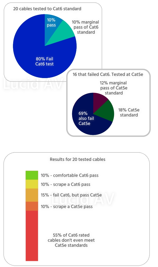

TBH, I wouldn't buy any of those long pre-made patch cable for what you want to do. You've no idea whether the finished cable actually performs to spec despite them all quoting an impressive-looking roster of standards: ISO/IEC 11801 & EN 50288 & TIA EIA-568-B.2-1 ETL/3P Verified.
There's a company in the US that I trust a lot. It's Blue Jeans Cables. They take cabling seriously and they test competitor products to see if they're up to standard. Very few companies do this. It's even rare with review sites. The equipment required to do it is very expensive; tens of thousands of Pounds.
They did such a test of 20 Cat6 cables. These were all cables that made the same standards claimed by the patch leads in your links. The results were shocking. 80% failed to meet Cat6 standard, and even more surprising was that 55% failed to meet just the Cat5e standard. That means the cable becomes an unseen bottleneck to network speed. LINK
Looking at the list of cable you were originally planning to buy, you were proposing to hang up to £550 worth of gear off a £30 random bit of Ethernet cable. Worse than that, there's a 90% chance that you'd be left wondering why any of the gear you install might fail to live up to the performance claims. The reason wouldn't be immediately apparent. After all, cable is cable. Right? Except it isn't, but no one has an easy means to test it, and it's often overlooked when things don't work as they should. So you'd spend all this money building an office, but when it comes to the crucial Zoom meeting the kingdom is lost for the want of a horseshoe nail.
Blue Jeans will supply to the UK. In the grand scheme of the overall budget, their cables are a drop in the ocean. You would have to run the stuff through trunking though before taking it outside.
