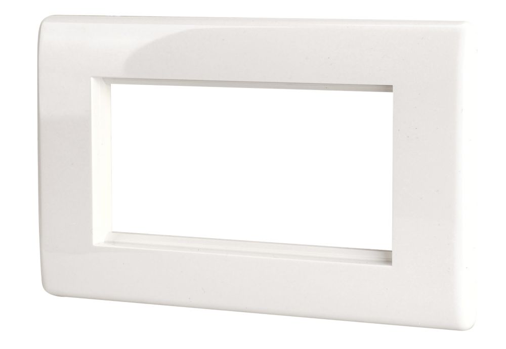

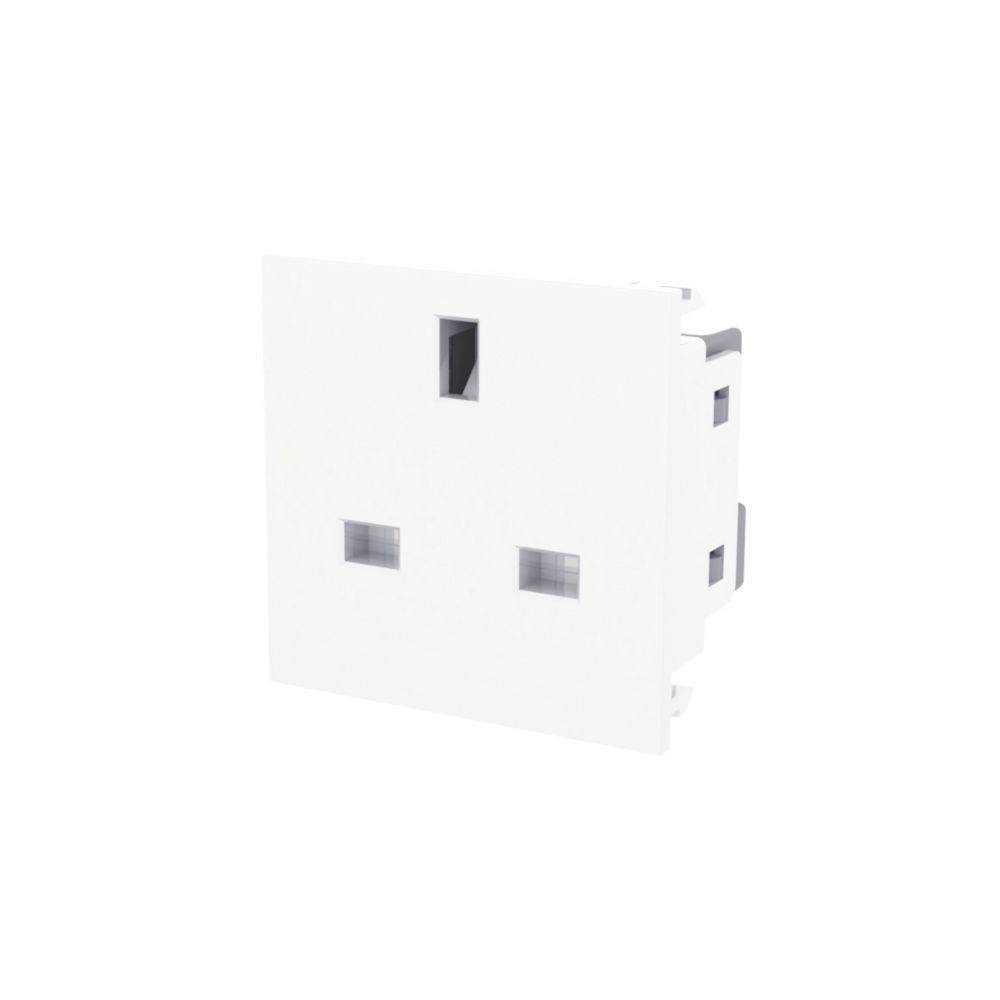

Screwfix do a grid socket so a double socket box has in essence two single sockets in a double socket face plate, so you can take two spurs from a ring without having more than 3 cables in one terminal, over 3 cables you can end up with one cable not being fully clamped so should be avoided.
Same grid socket would also allow a socket, a fuse and a switch in same double socket face plate, so you could have a socket and a fused connection unit in one double socket box.
Interesting. Thank you.
Do you have a link for this item? I can't seem to find it.

Ah, I think I understand what you mean.
Something like this?:
