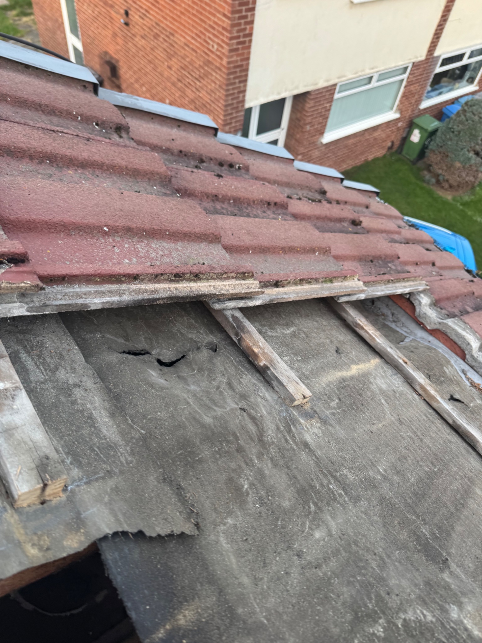

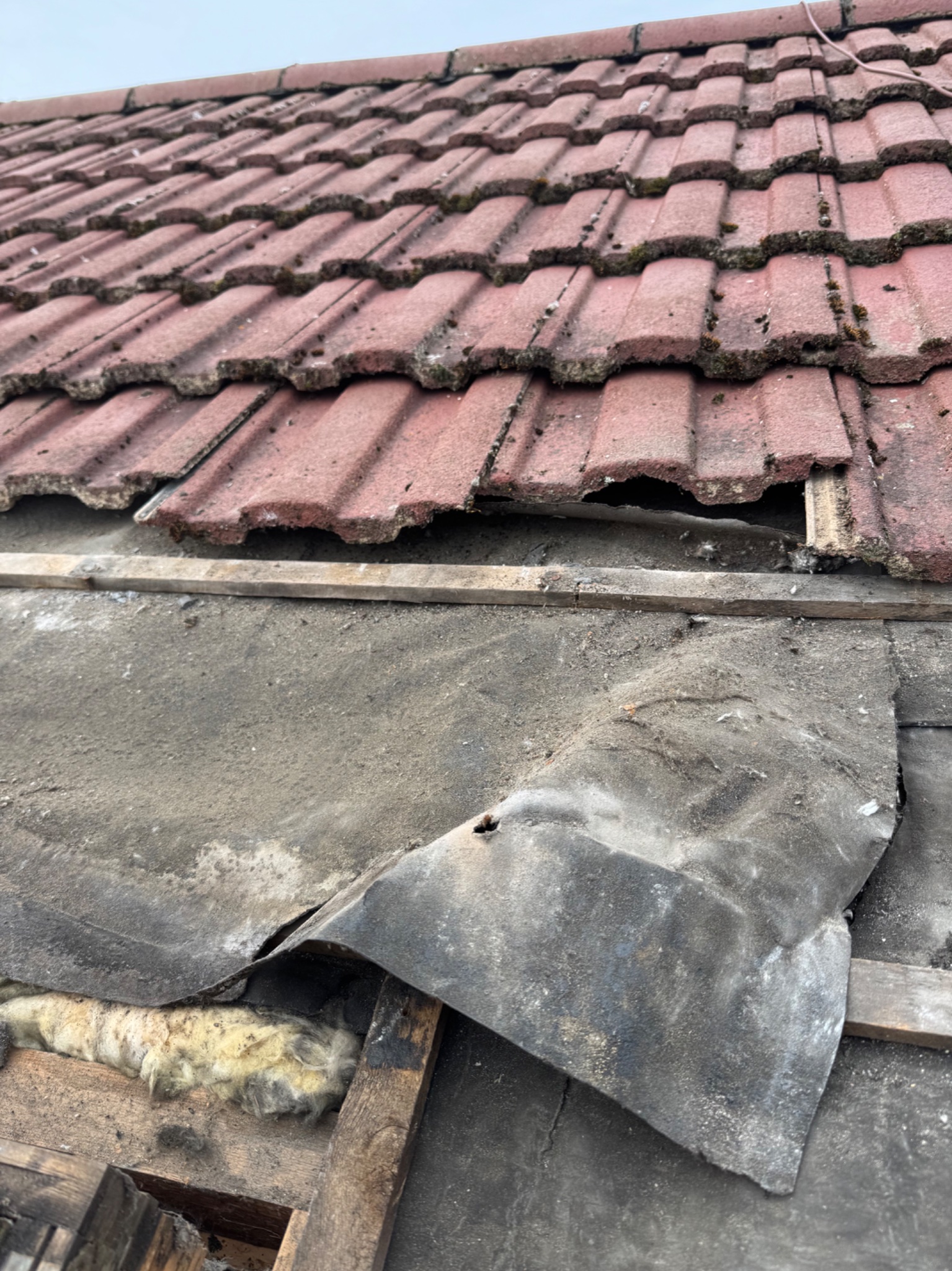

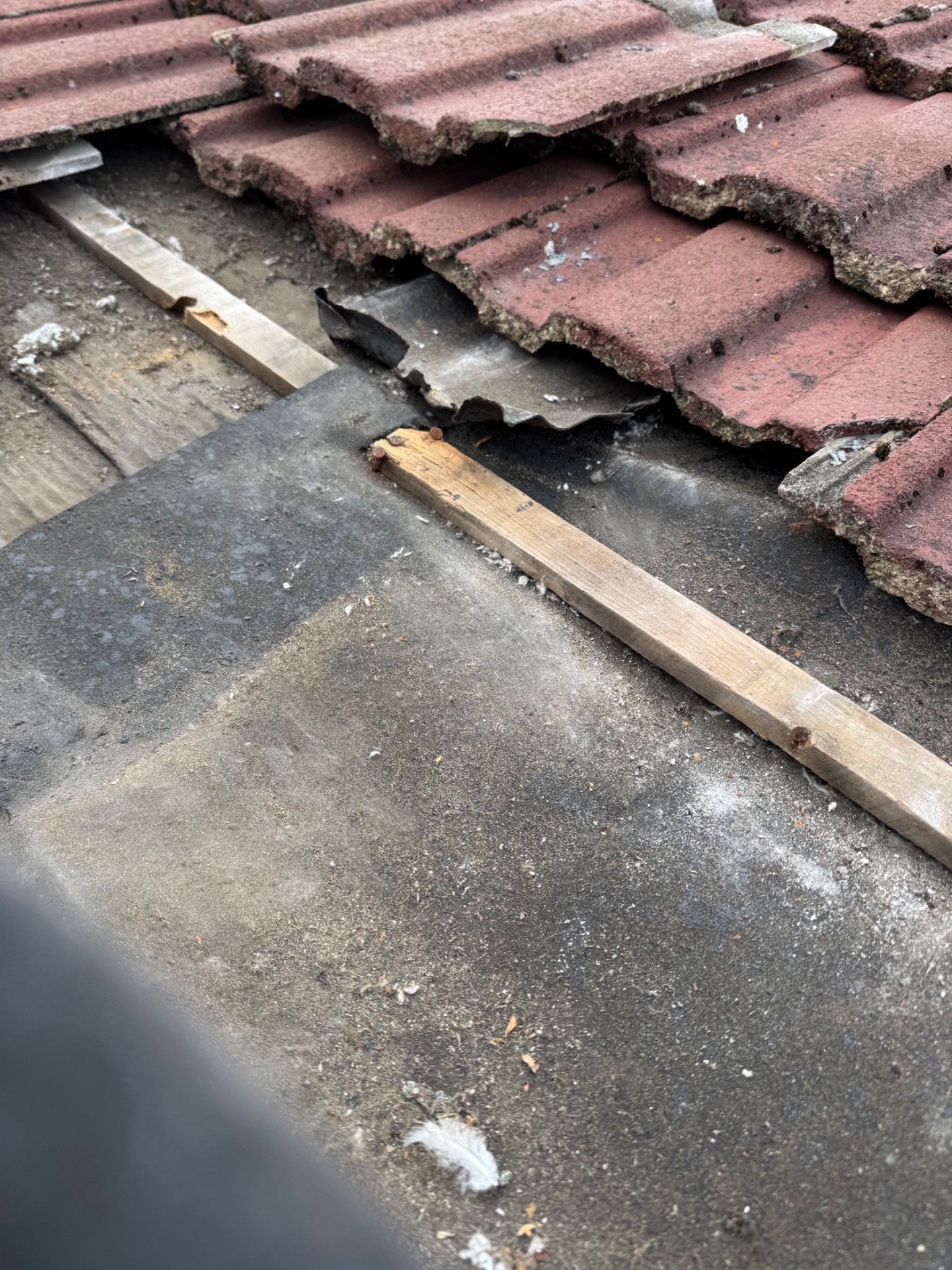

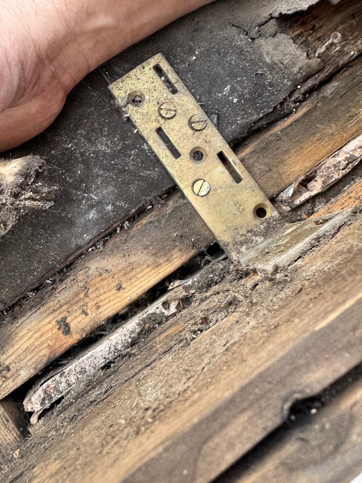

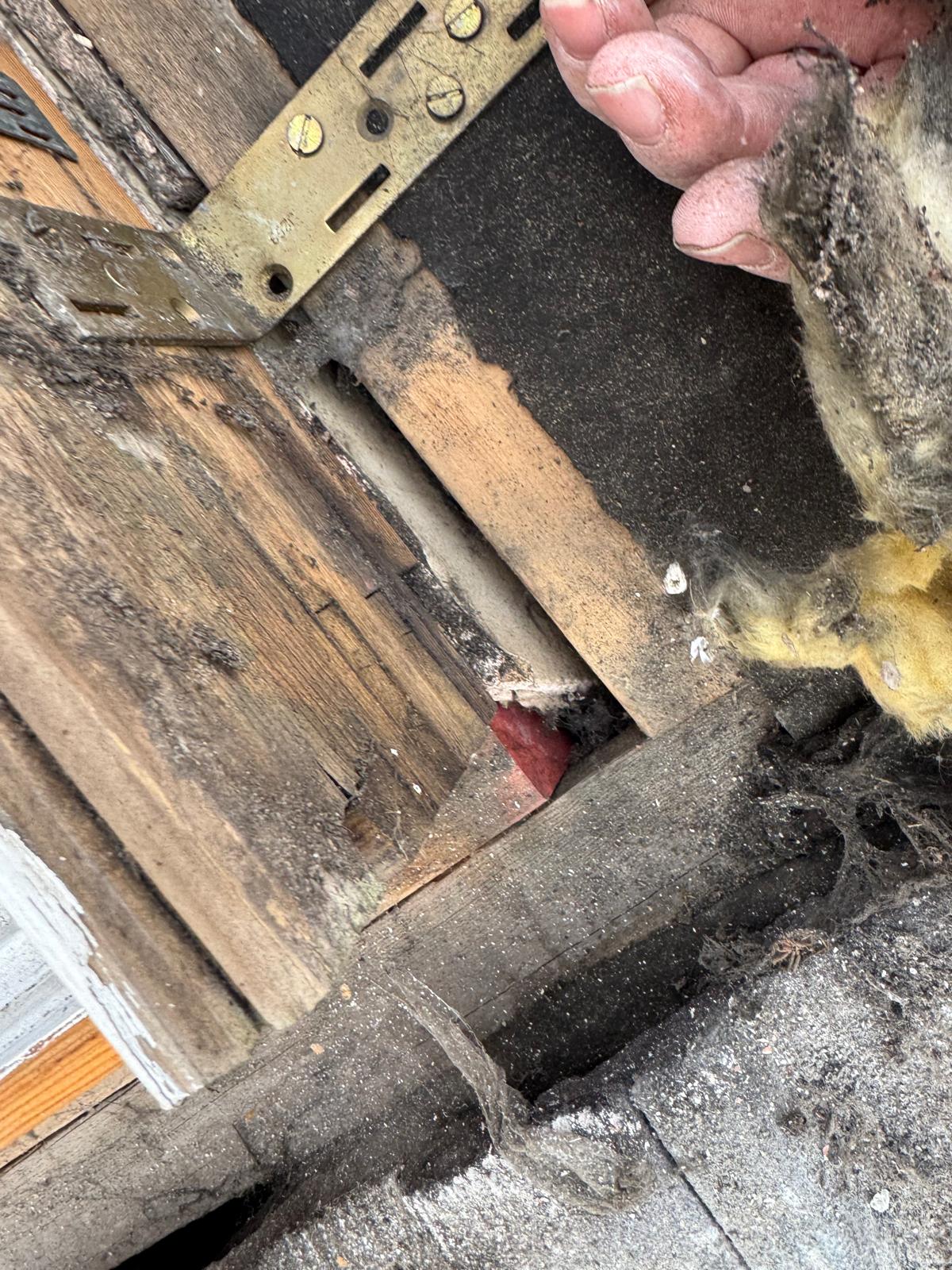

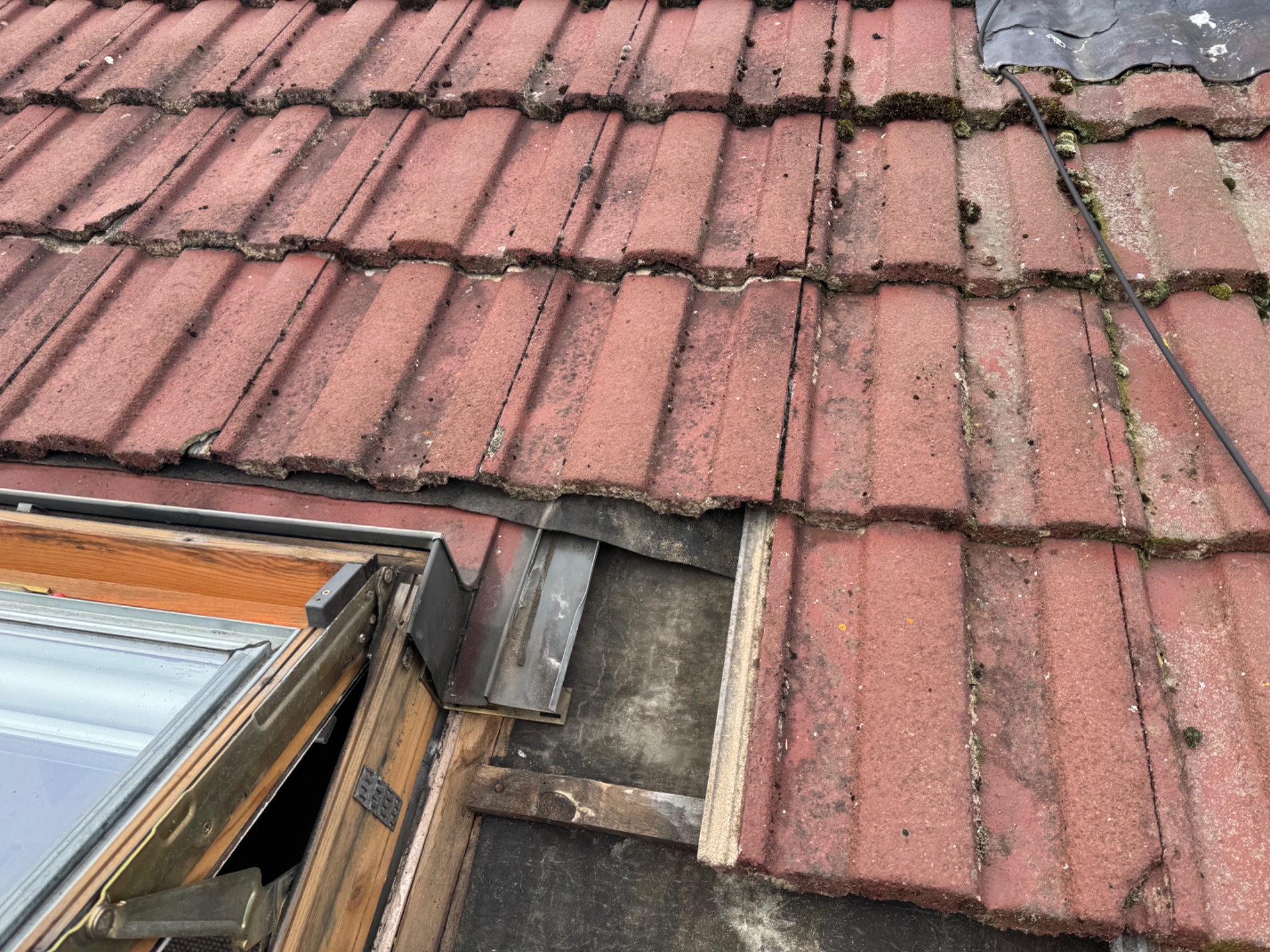

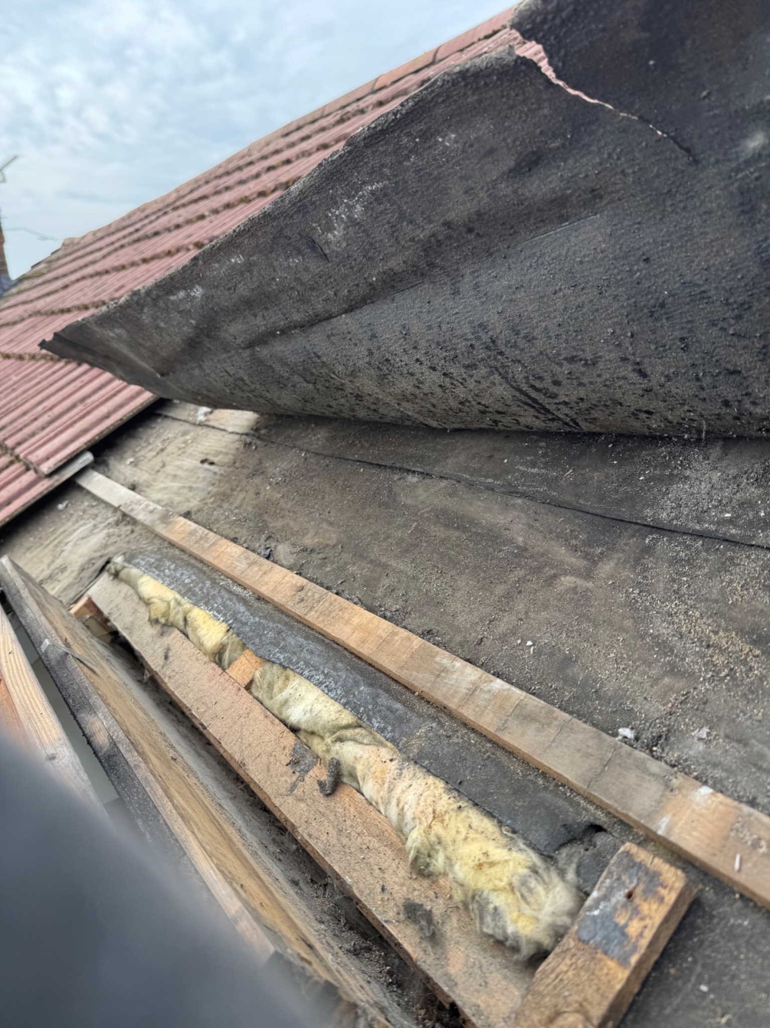

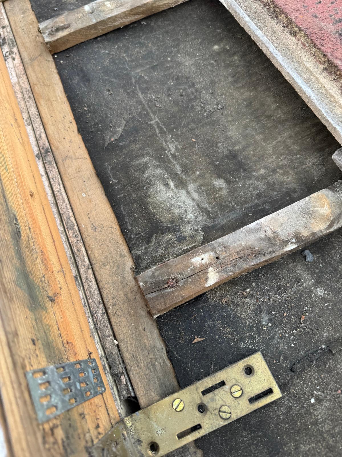

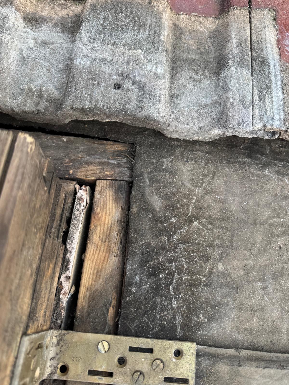

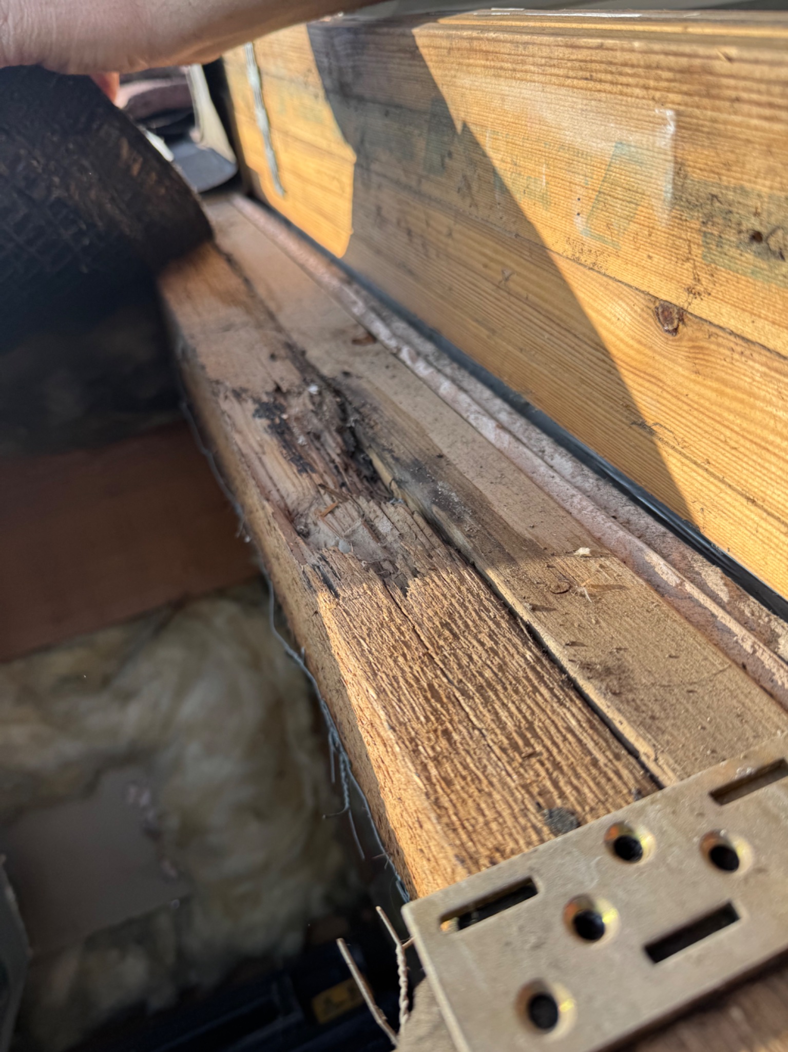

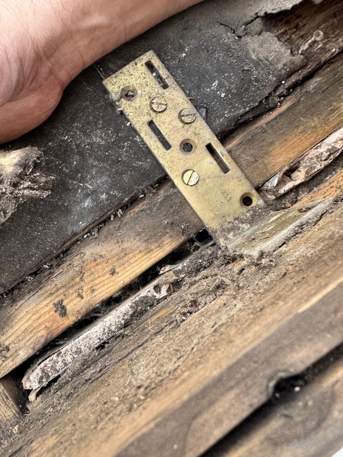

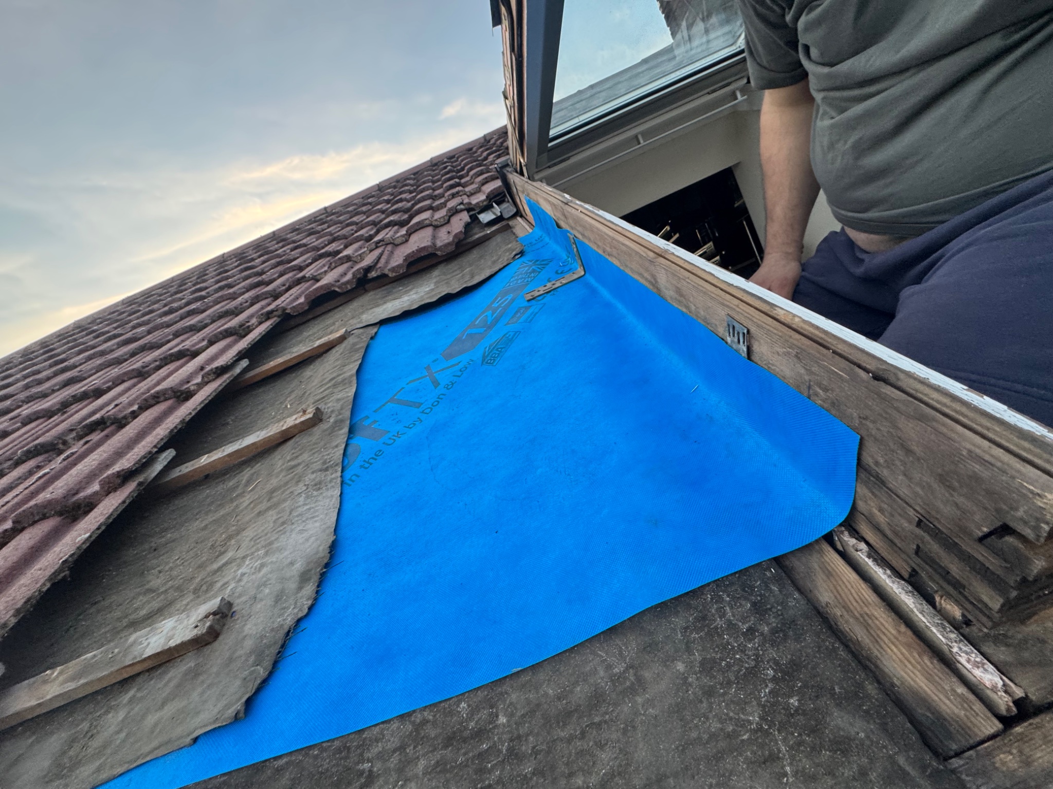

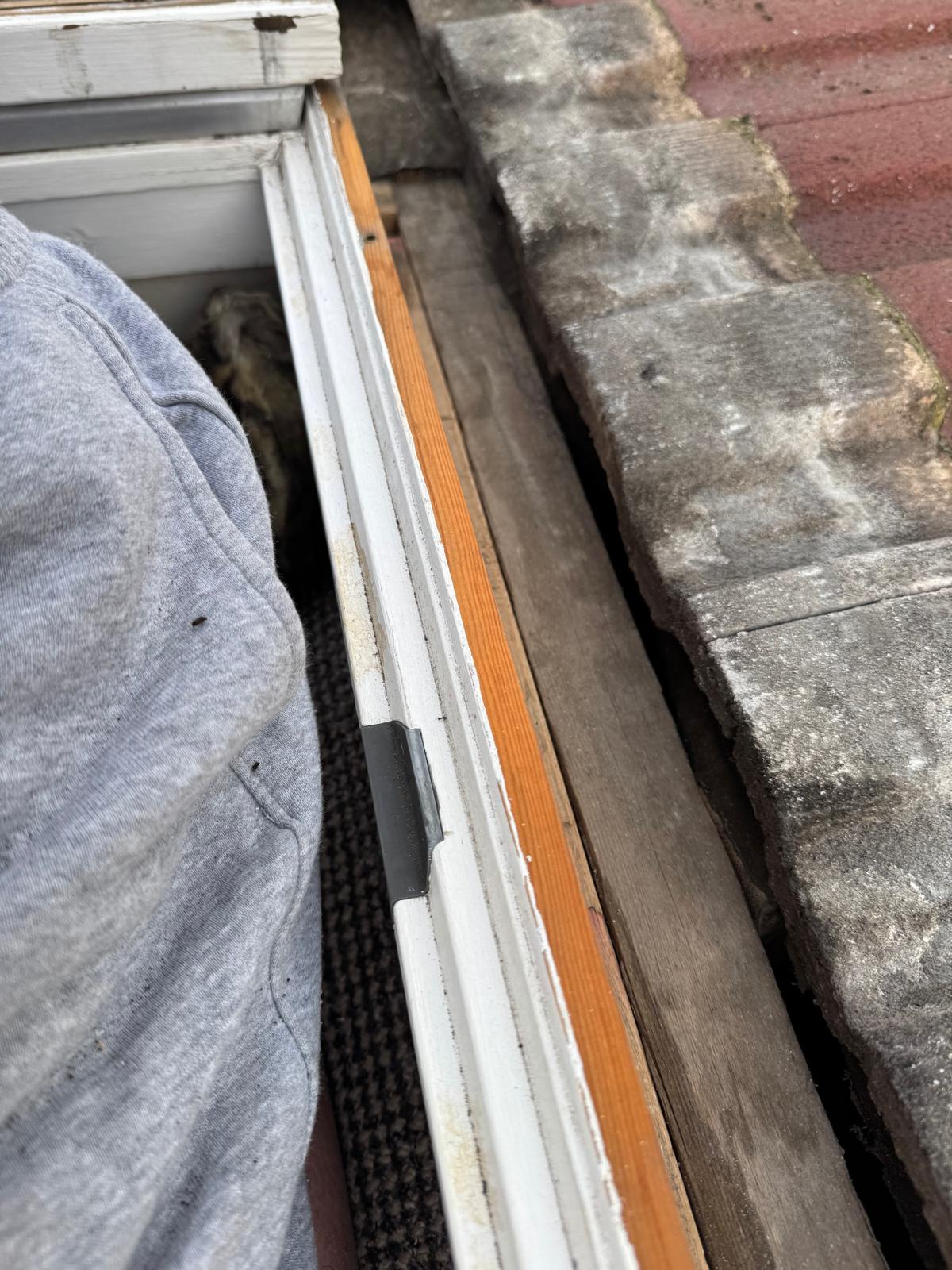

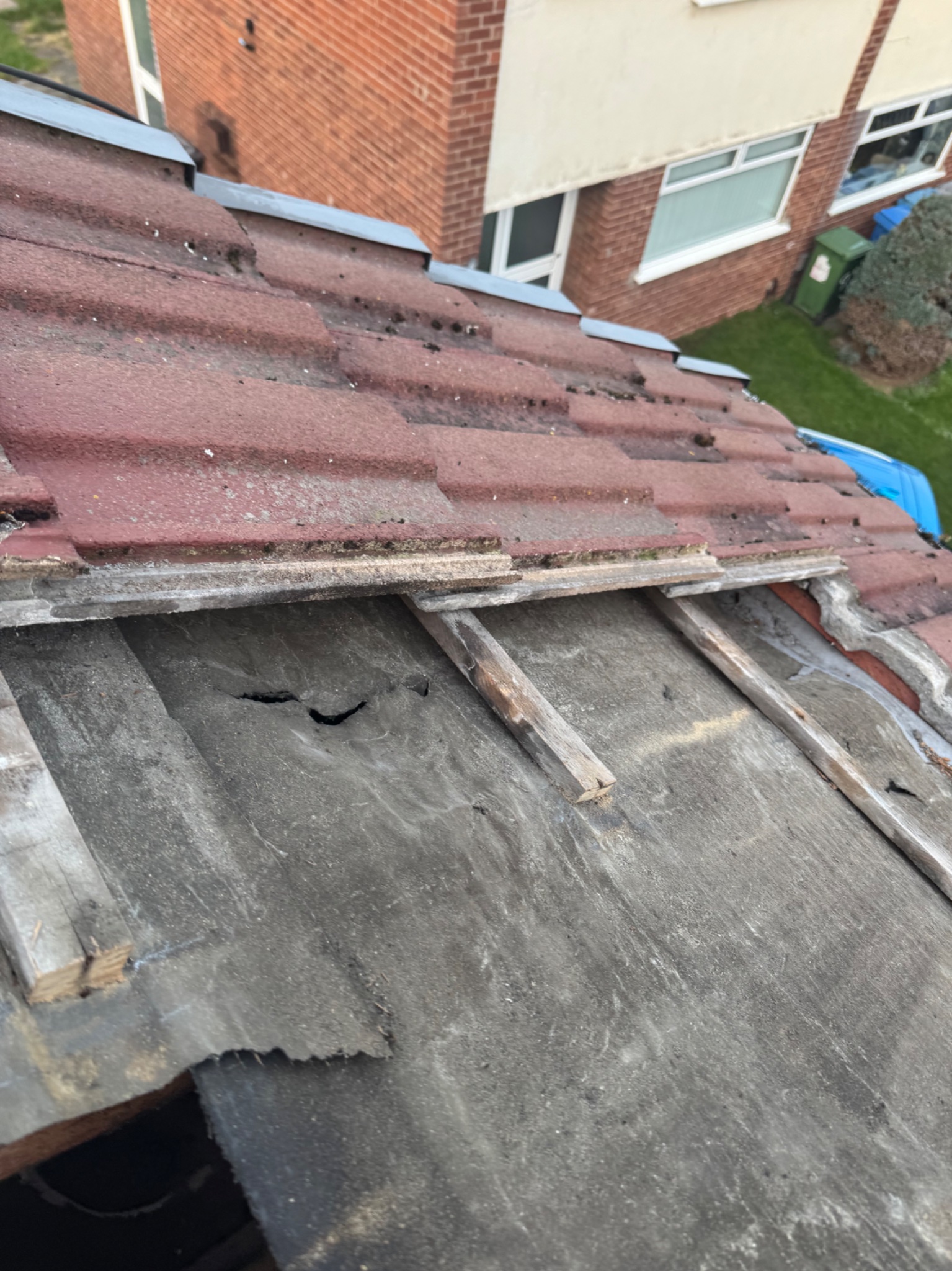

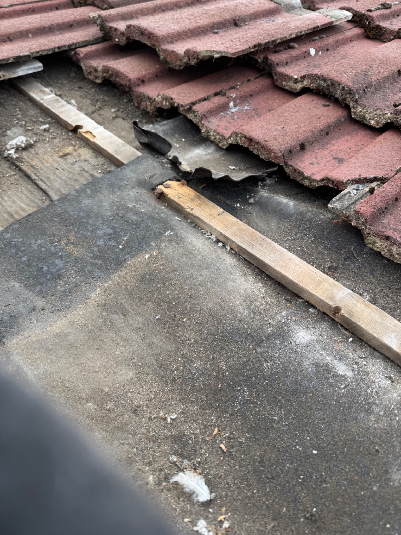

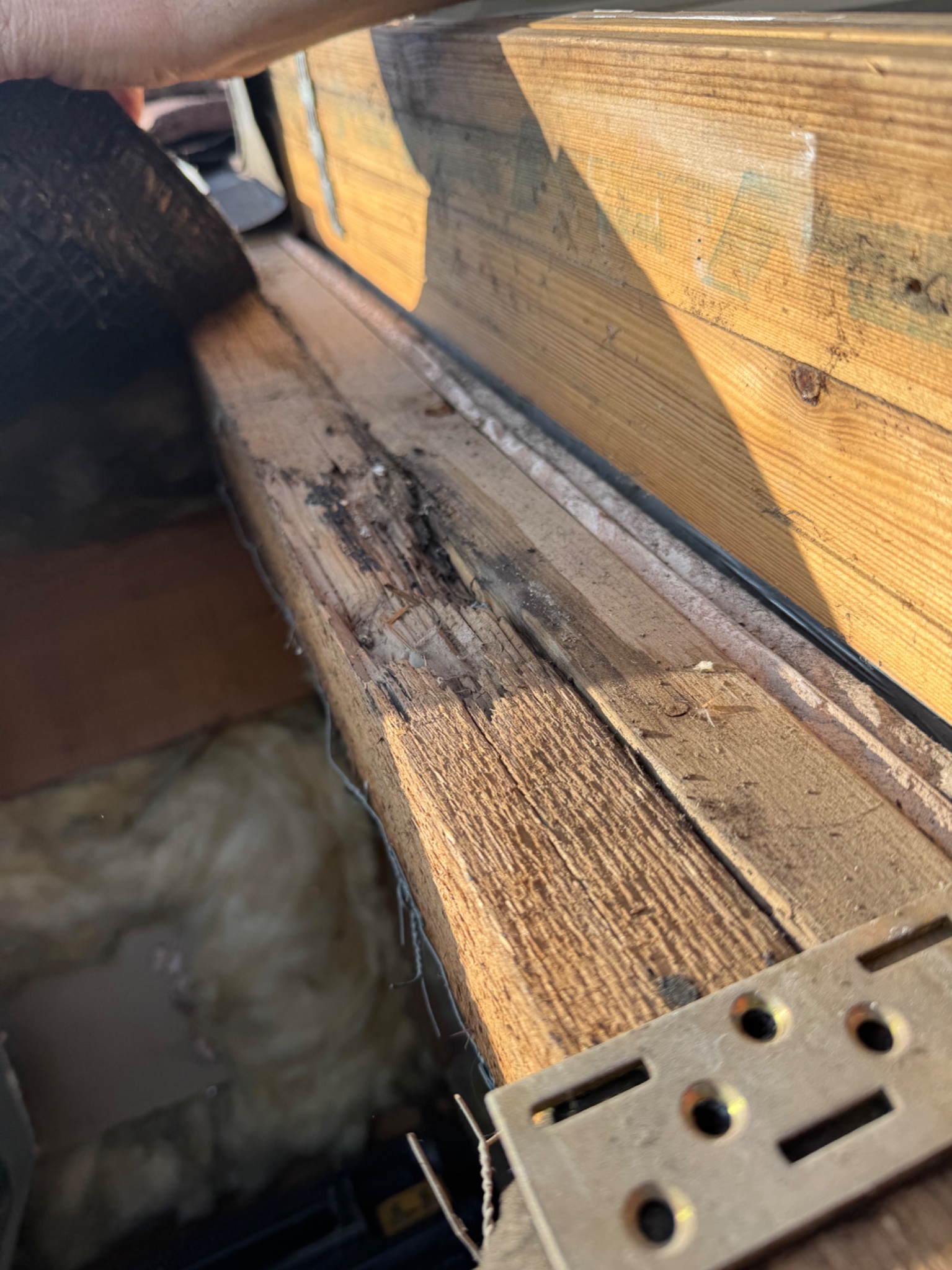

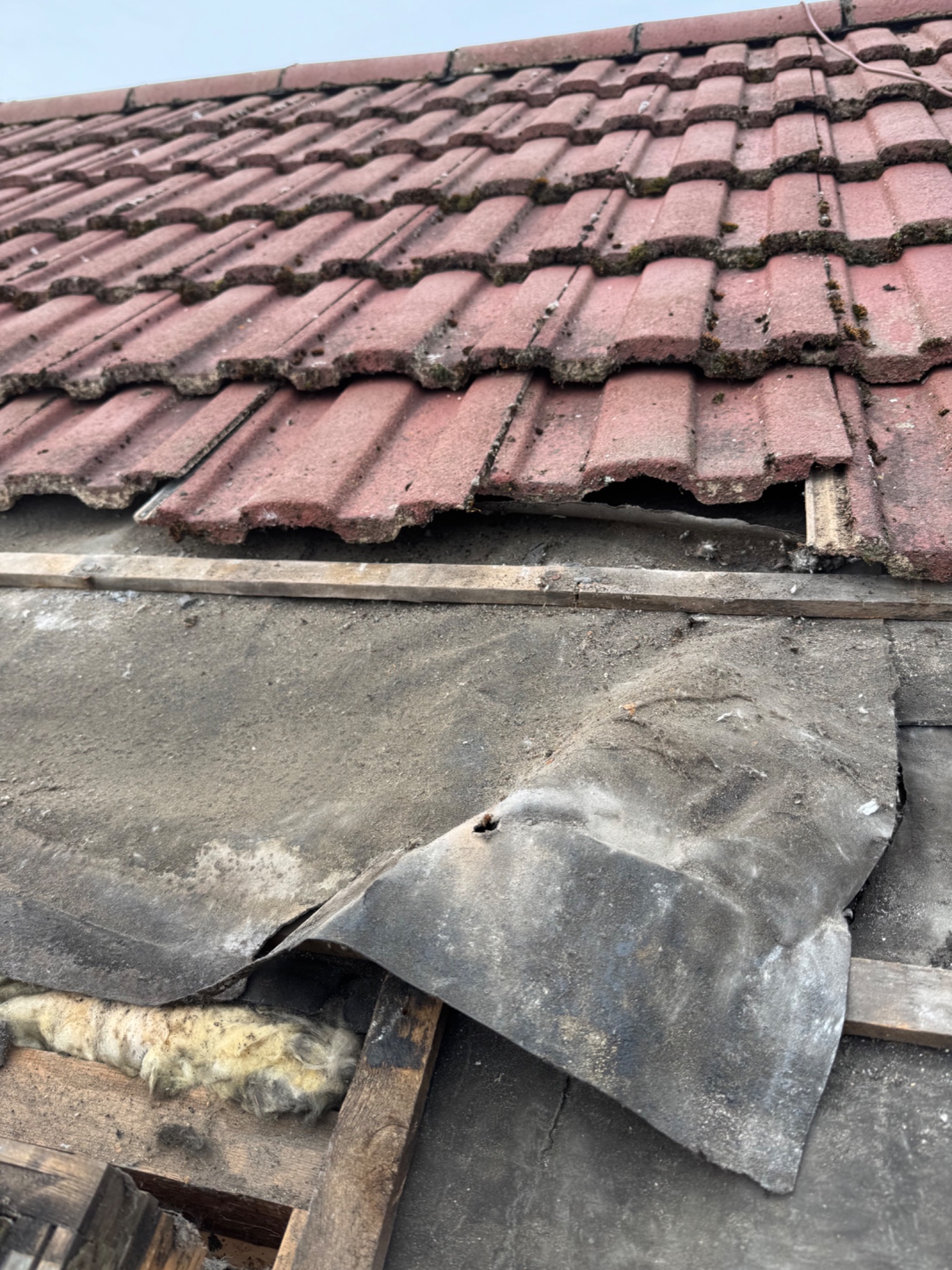

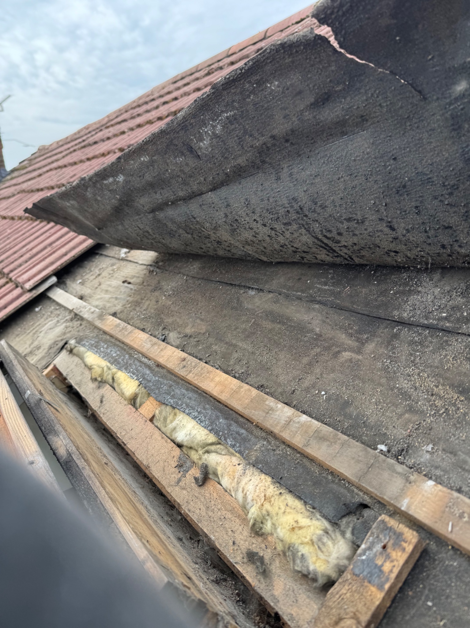

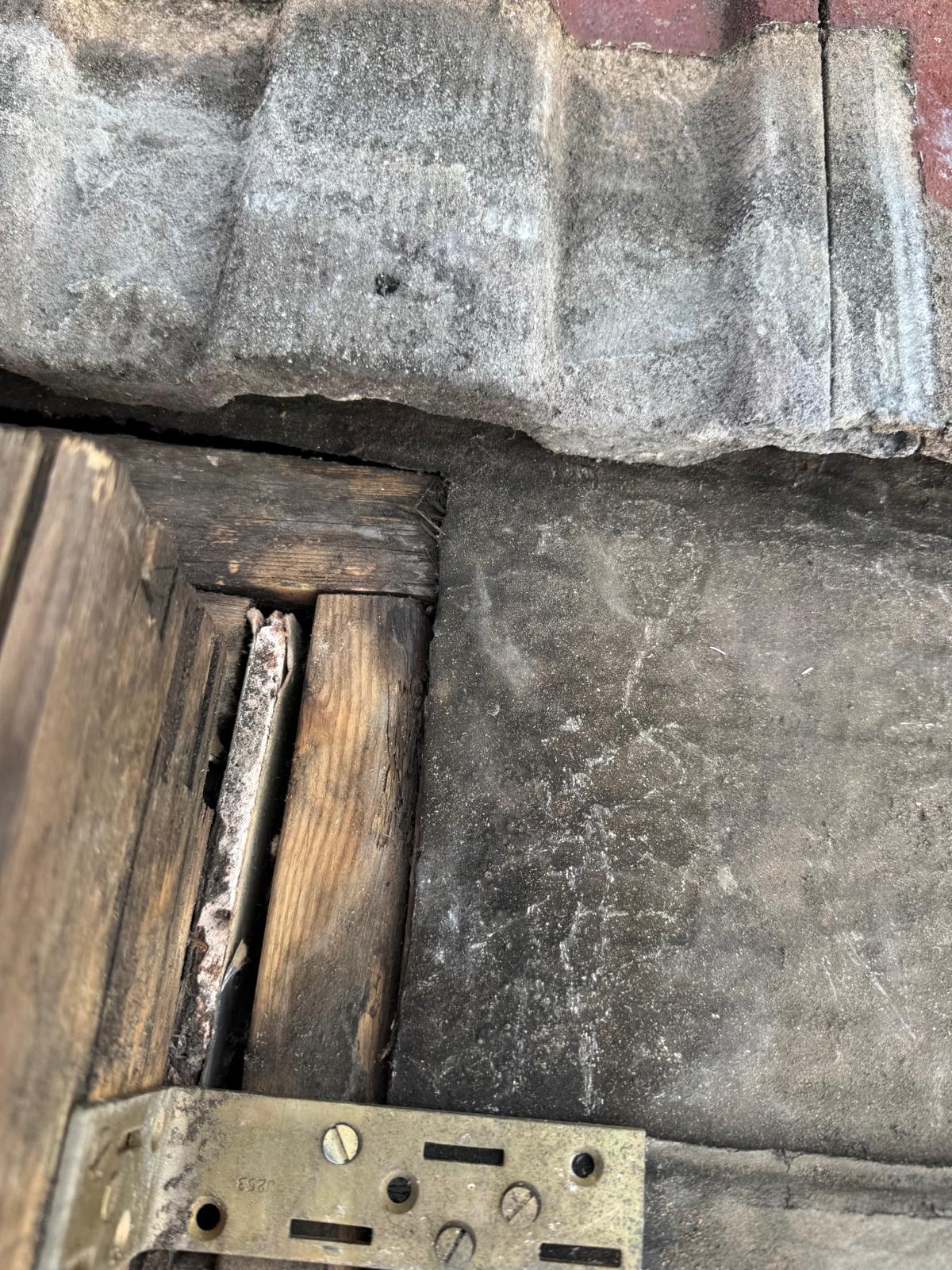

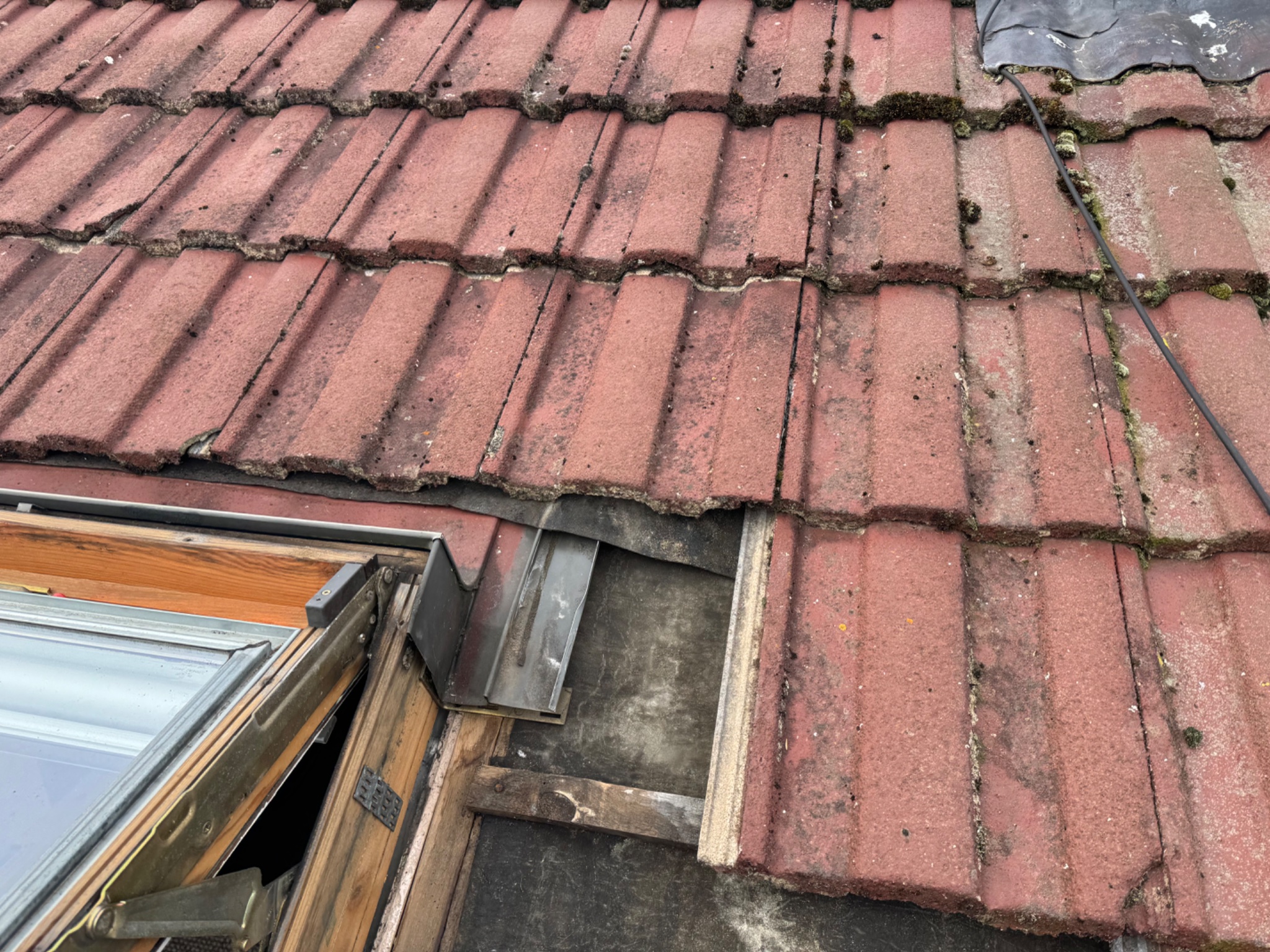

I've had water marks appearing around one of my attic windows; usually it's the gutters blocked with moss, but this time it isn't. When checking around, i found several batten sections rotted on one side, which prompted me to remove some tiles....and discover a few horros underneath!

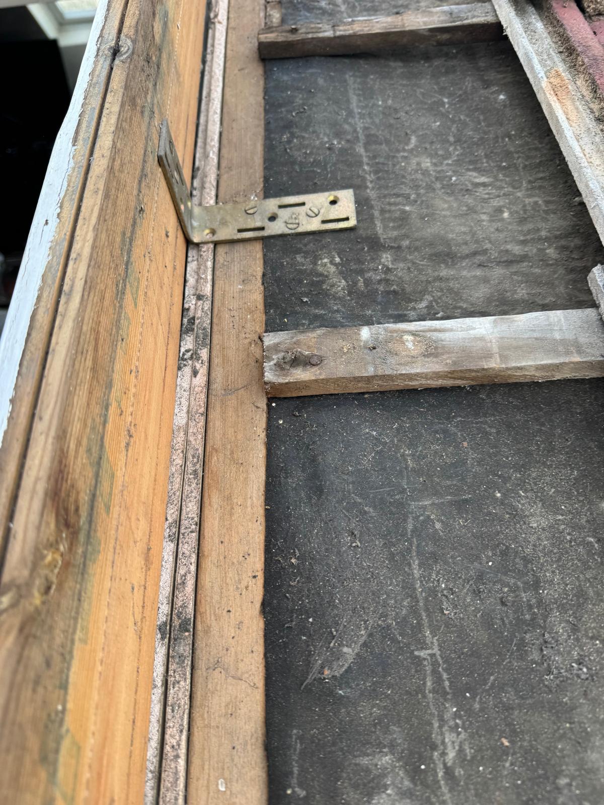

1. The felt is ripped in a number of places; and has been cut so it ends on the joists surrounding the velux window; it doesn't lap up the windo frame

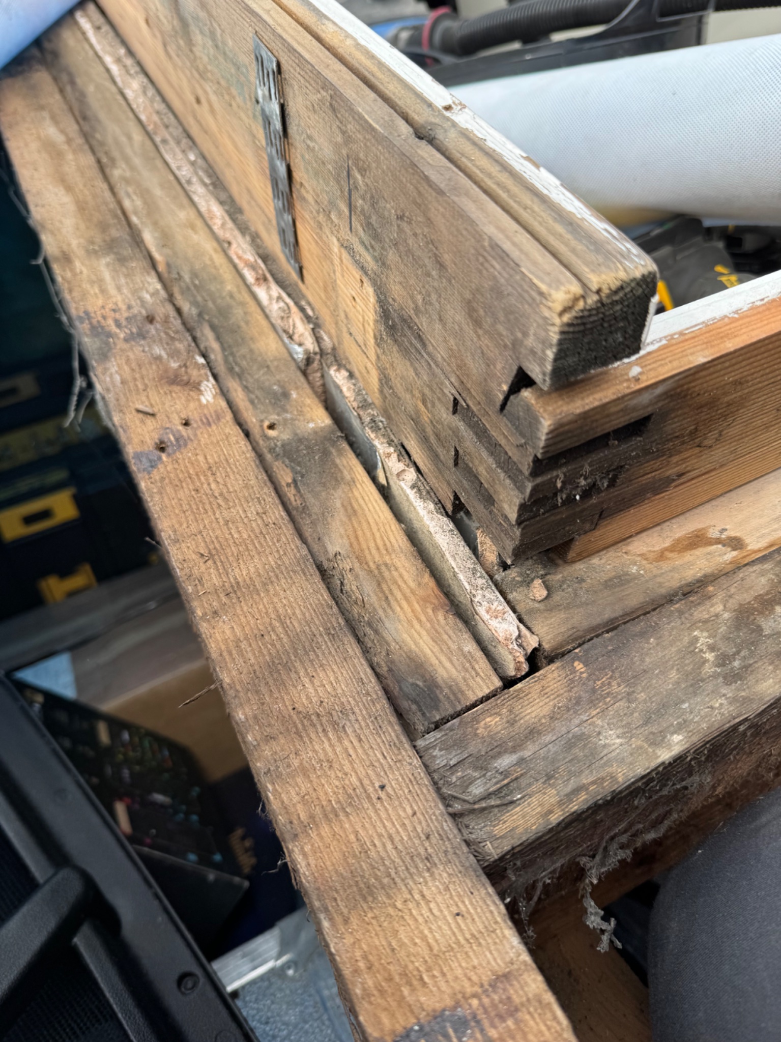

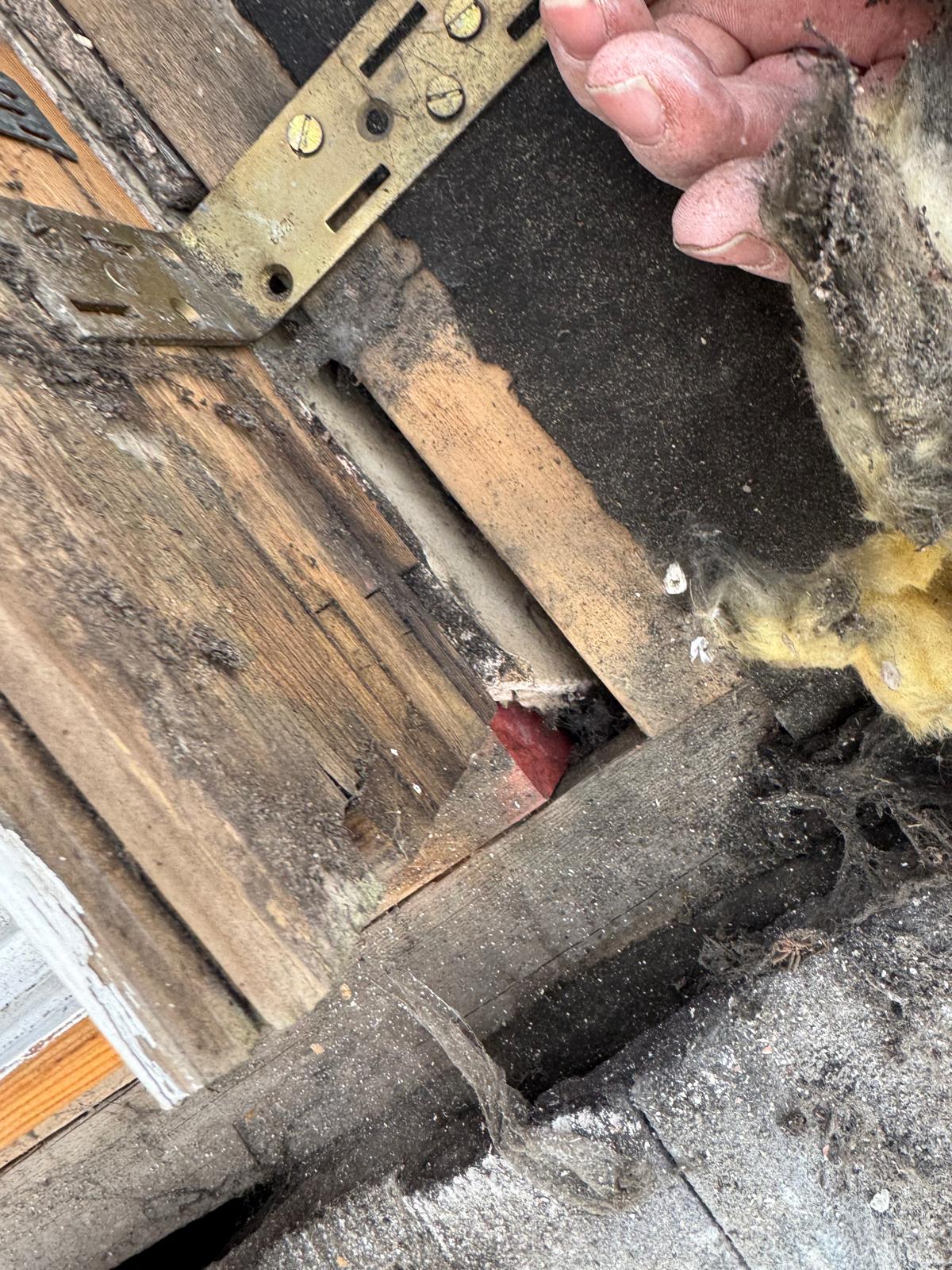

2. they have packed out the velux window with multiple sheets of plasterboard - which is can see from outside after removing the metal flashing cap - nothing in between!

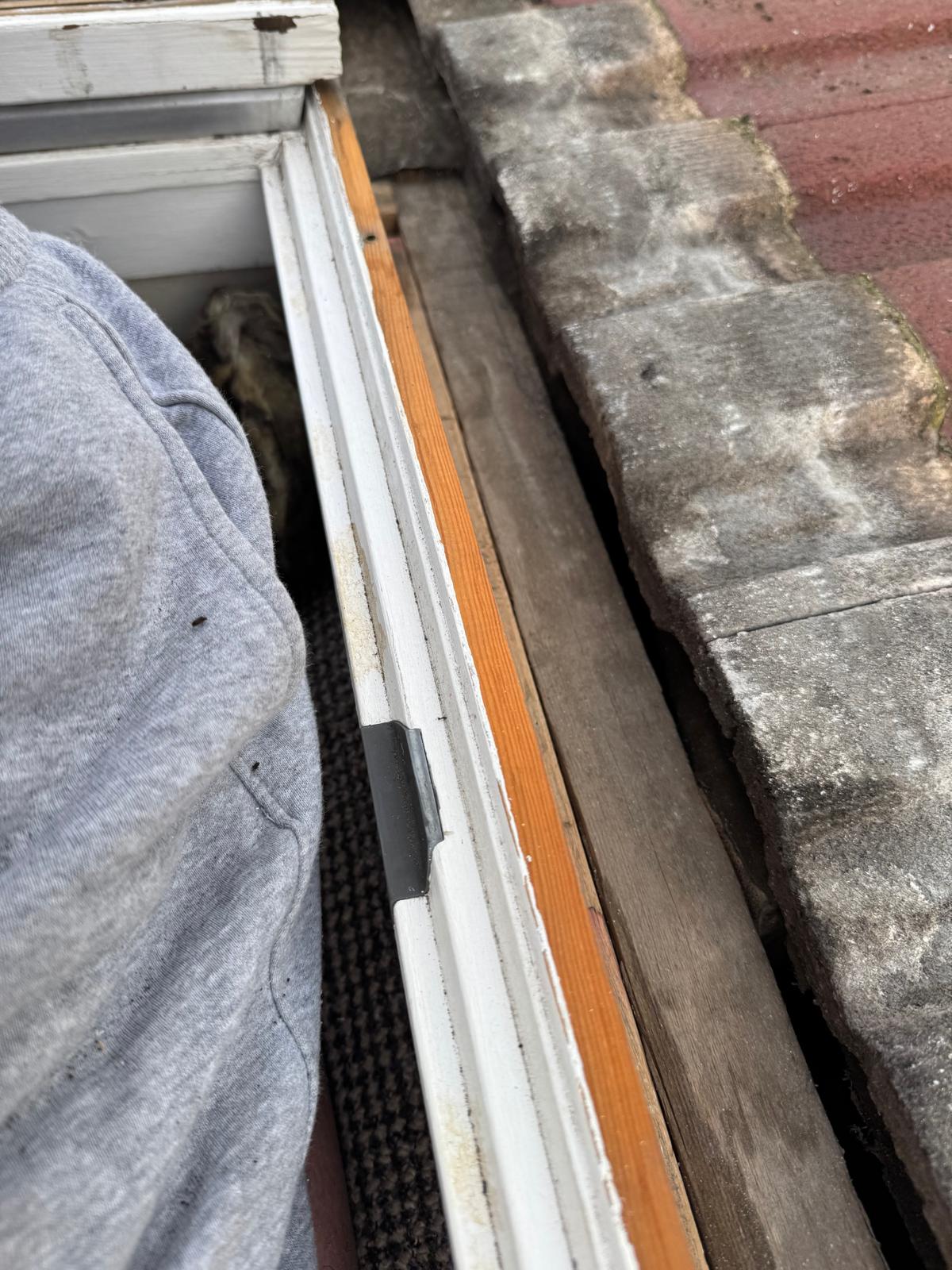

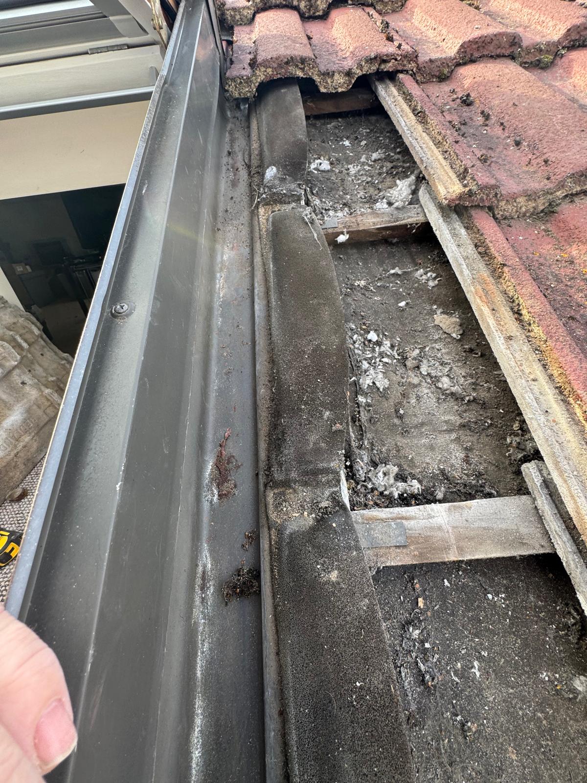

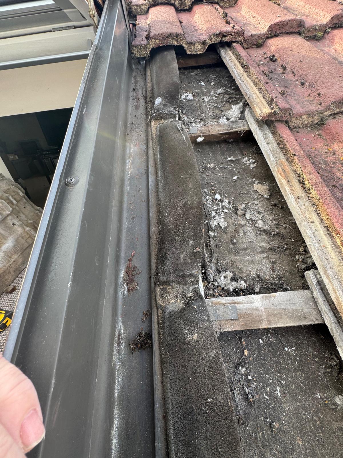

3. The metal channels on the left side have been badly bent and the outer lip completely flattened on install to try and get the tiles (which have been 'cut' by literally hammering bits off!) to sit flush. they don't and have just meant water has run down the sides and onto the bare wood underneath (and the cause of most of the damp marks inside!)

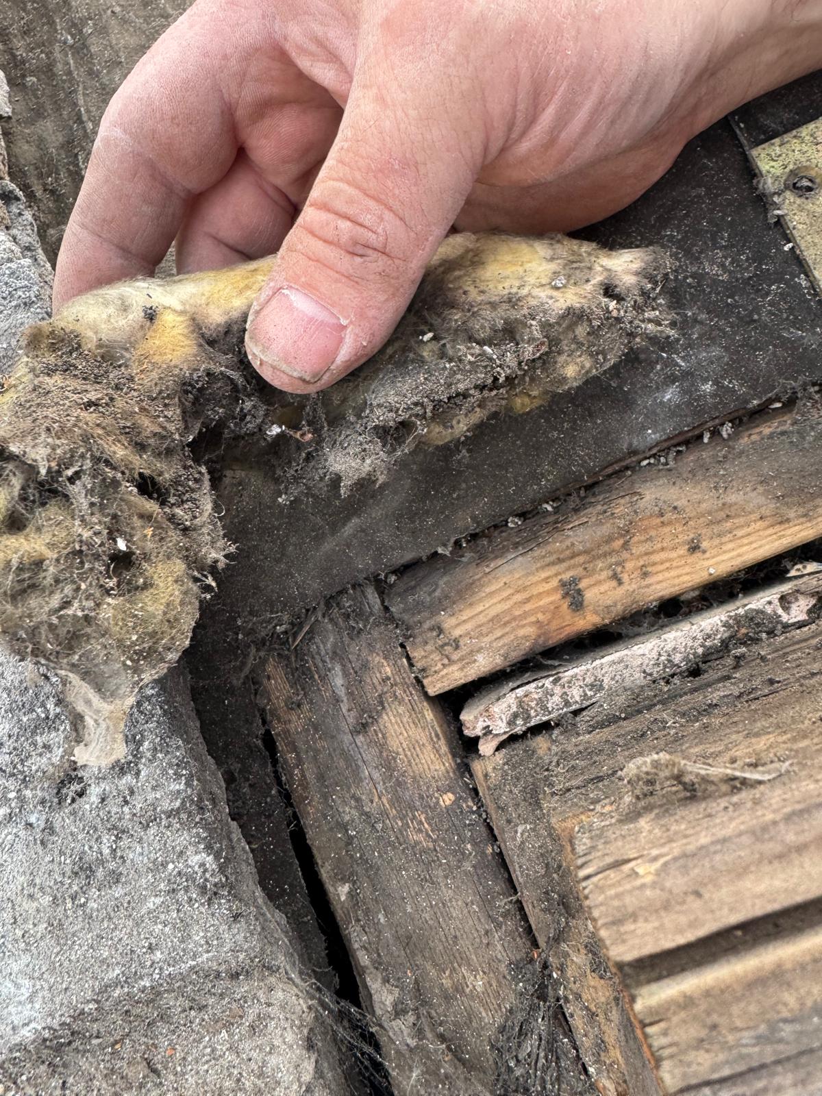

4. the felt has been cut below the nearest horigzonal joist under the window, meaning i can see into the attic and any water going under the apron goes inside the roof (and starting to turn the wood black ...thankfully not rotted like the tile battens! There also appears to be no additional batten above the lower tile batten as seems to be fitted on newer flashing installs.

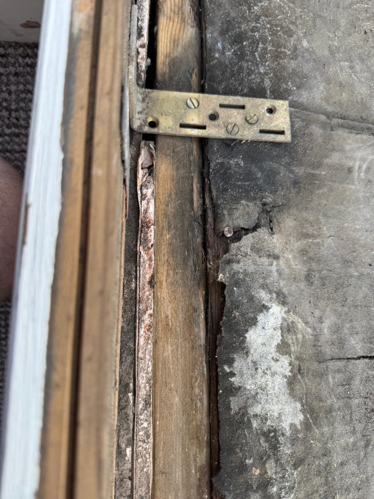

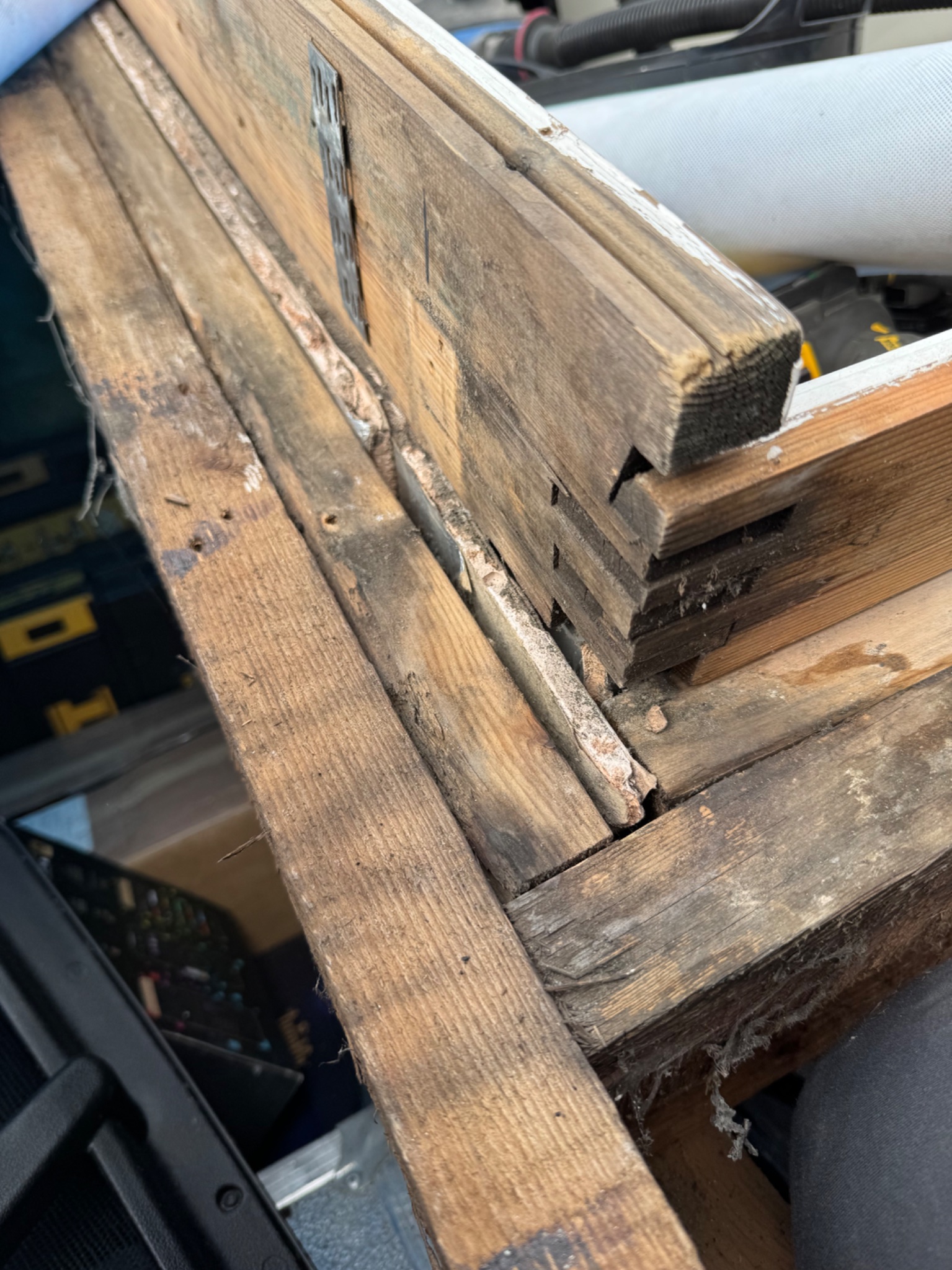

The window is ancient (GHL-2, so pre 91!). I've already retrofitted the 308 glass and fitting kit, and uprated the lift springs, which work great; but from what i understand, any newer (308/MK08) flashing kits will require adjustment of the window frame height (normally inwards) - which frankly isn't worth doing as i plan to replace it completely in 18 months or so (new job depending). I plan to patch the felt with some new membrane in the worst sections and flashband the side joinst and under/overlap above and below; but i can't find any info for how the fitting was meant to be on these ancient windows for flashing - i'm thinking of turning it up the sides of the window frame and stapling in place, but i'm not sure if there should be a batten below the window, or how to seal effectively.
Could anyone provide me with any advice on best approach?

Most roofers or pro's would look at that and run a mile. The felt will be brittle, the nails corroded, the battens shot. Not only that, you have an ancient roof light with damaged flashings and slotted screws no less!
Fit a (same size) new, Keyite or Velux window and start renovating the batten and felt locally from the bottom up.

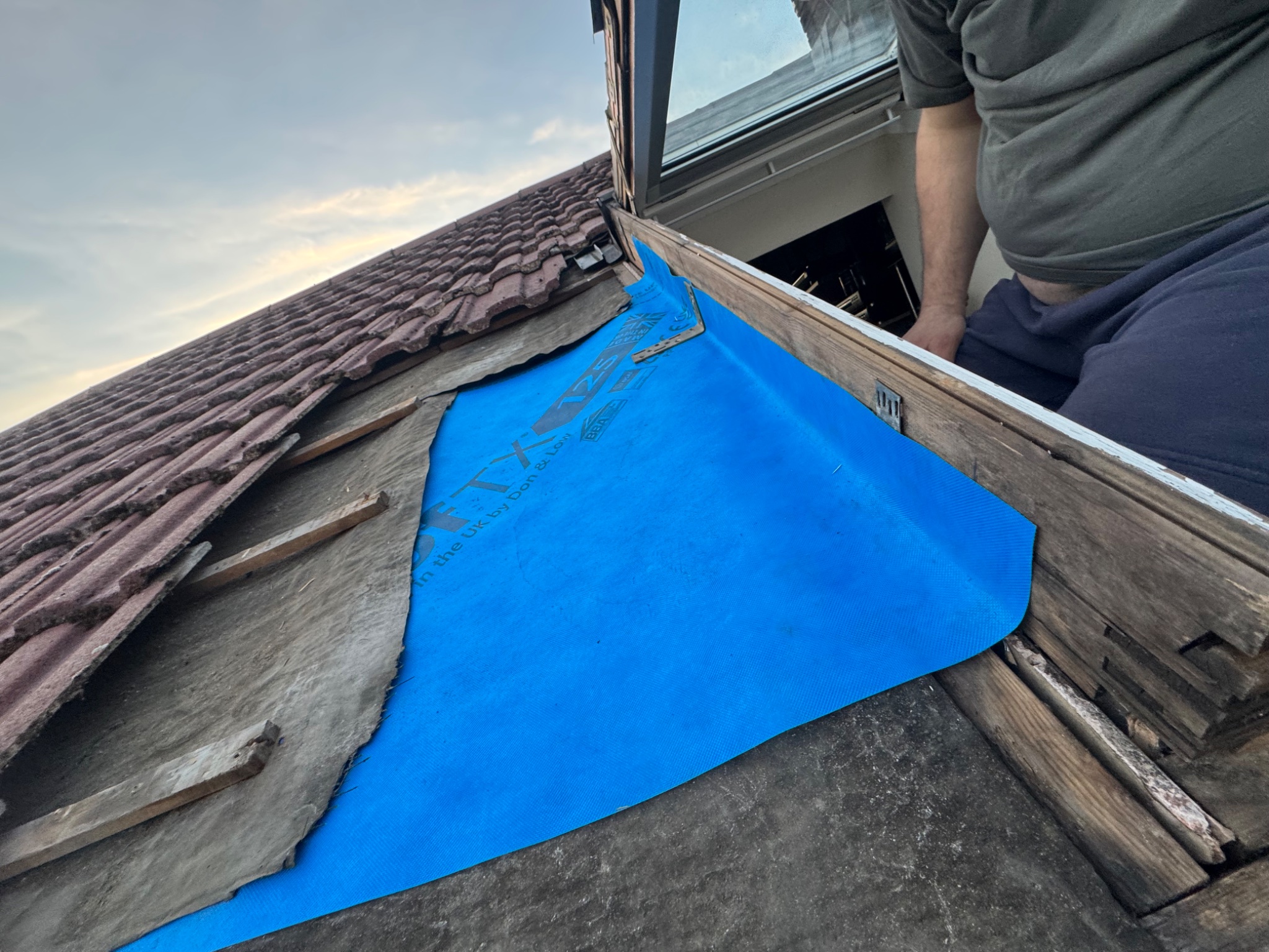

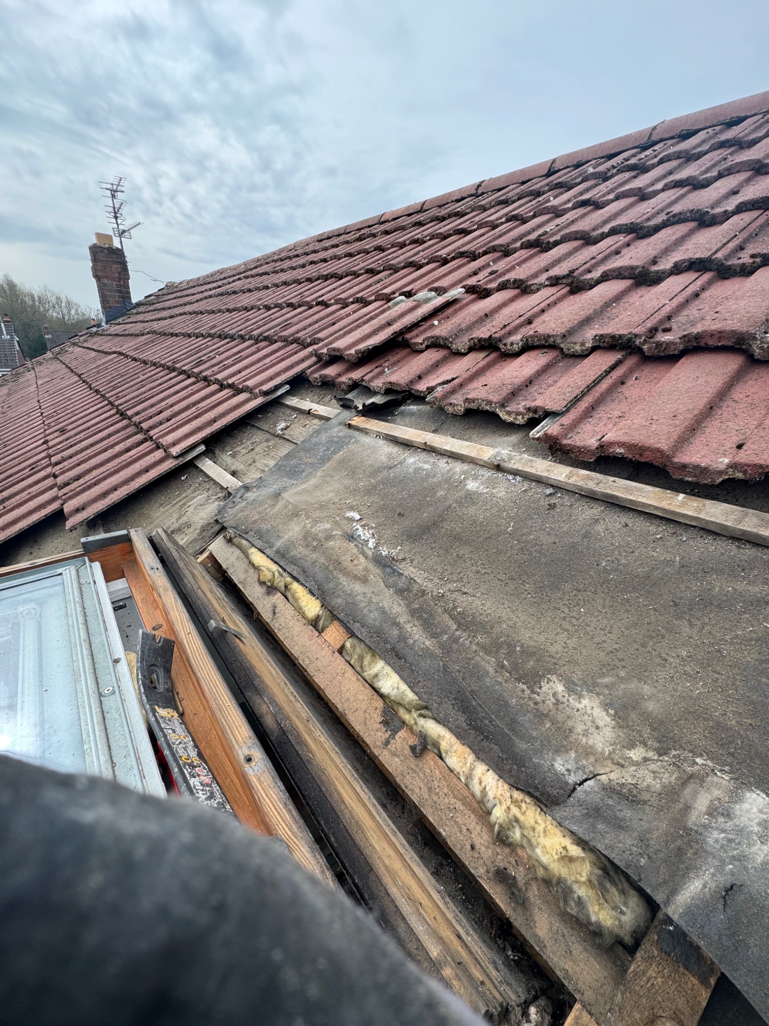

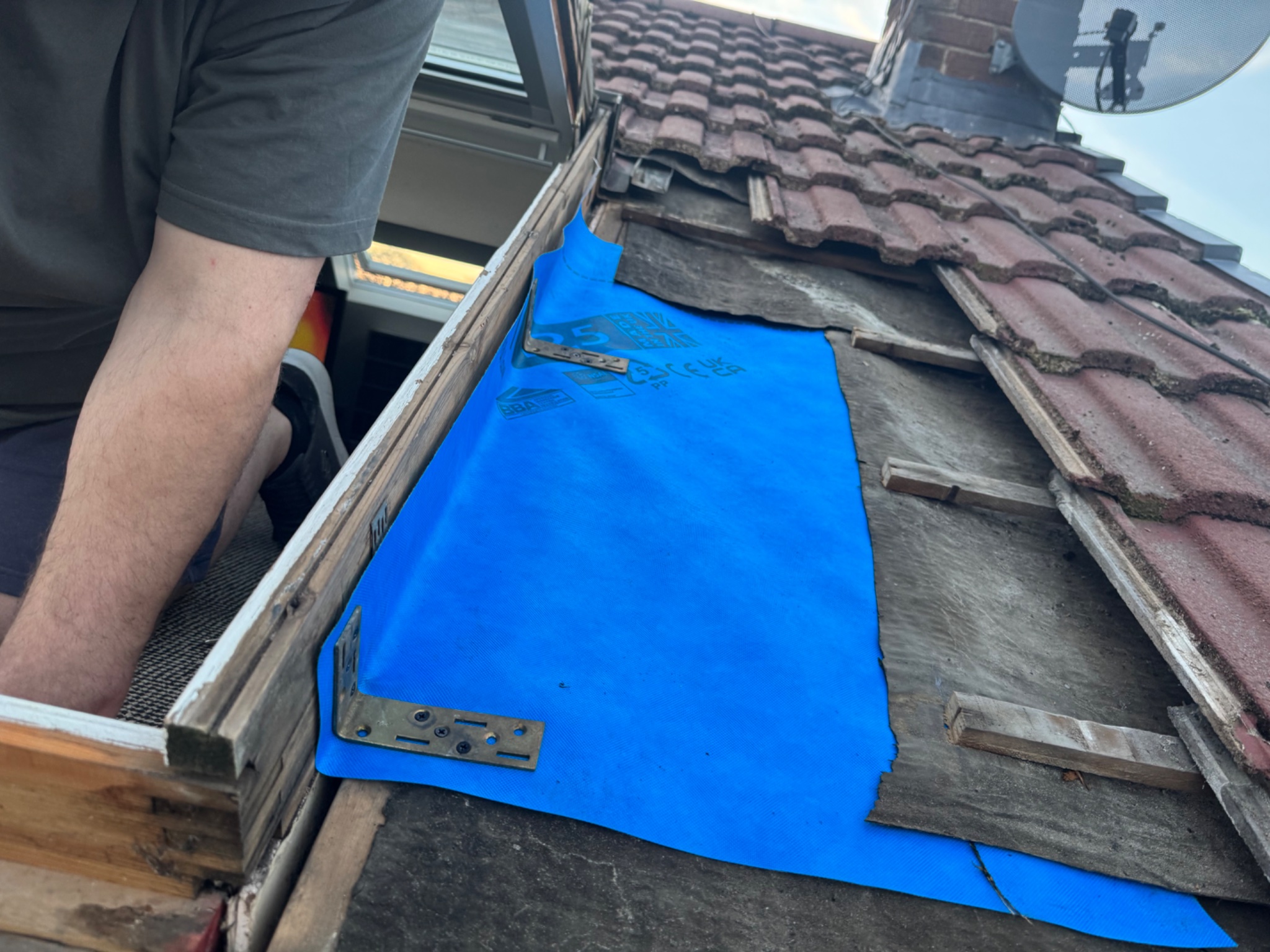

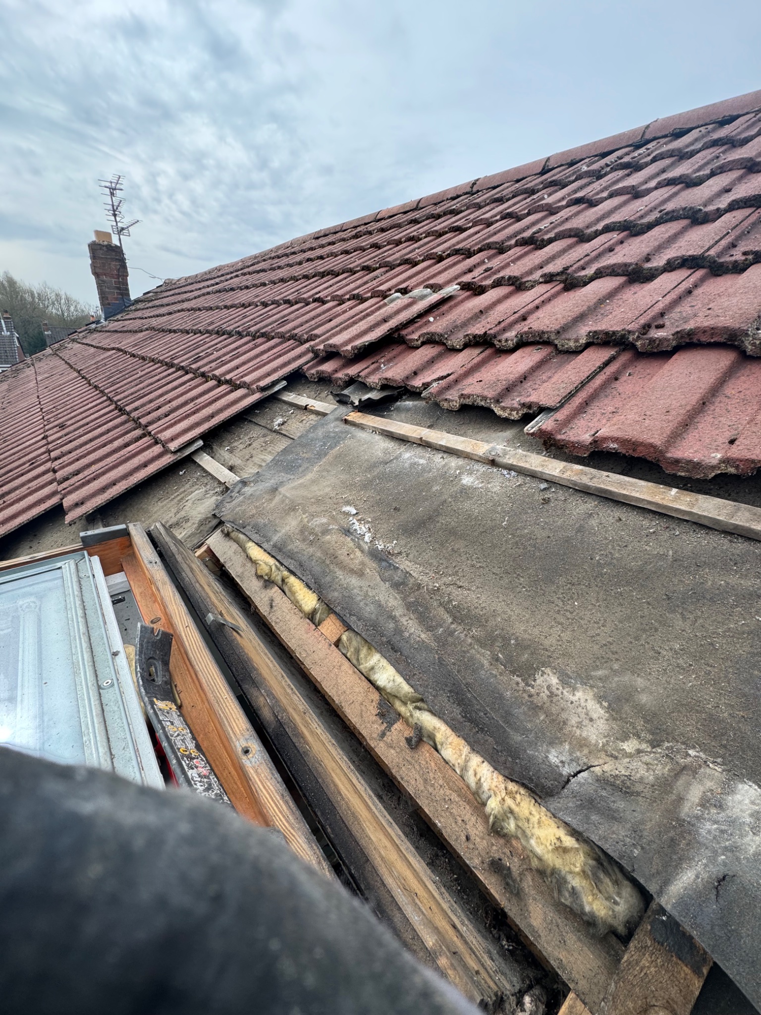

I’ve done some more work and it’s turned into a bigger job, some horrendous botched work underneath. The tiles! I’ve decided to replace the areas of damaged felt while I’m out there, I still am not sure if there is something wrong about the flashing kit on there as the side sections don’t really match the top profile.
If I get the bfx collar, is it worth getting the edw flashing kit as well and using that? I’ve read new windows site 17-40mm lower than older ones, could I pack out the new flashing or would I have to lower the window a bit?
I can source the full kit locally tomorrow am, so can hopefully finish job tomorrow before the rain!
Attached some current disaster photos….

You will need a replacement flashing kit, as your window is old. If you use a new flashing kit, you will need to lower the frame 25mm.
Hmm lowering might be difficult as it only just clears the seat now (steel beam
Runs perpendicular to it). Is there any way I can raise the flashing instead?
I’ve managed to straighten out all the flattened panels of the original flashing kit, and have the replacement foam already. But I can’t find an install guide for the old flashing kit as I know it’s not been done properly, and want to make sure it goes on right this time!
Start at the bottom and work your way up.
Reference a new flashing kit brochure.
Fit the bottom course of tiles and the bottom flashing apron.
Fit the side flashings and foam and ensure they lap OVER the bottom tray.
Fit the top flashing ensuring it laps onto and OVER the side flashings.
Fit tiles.

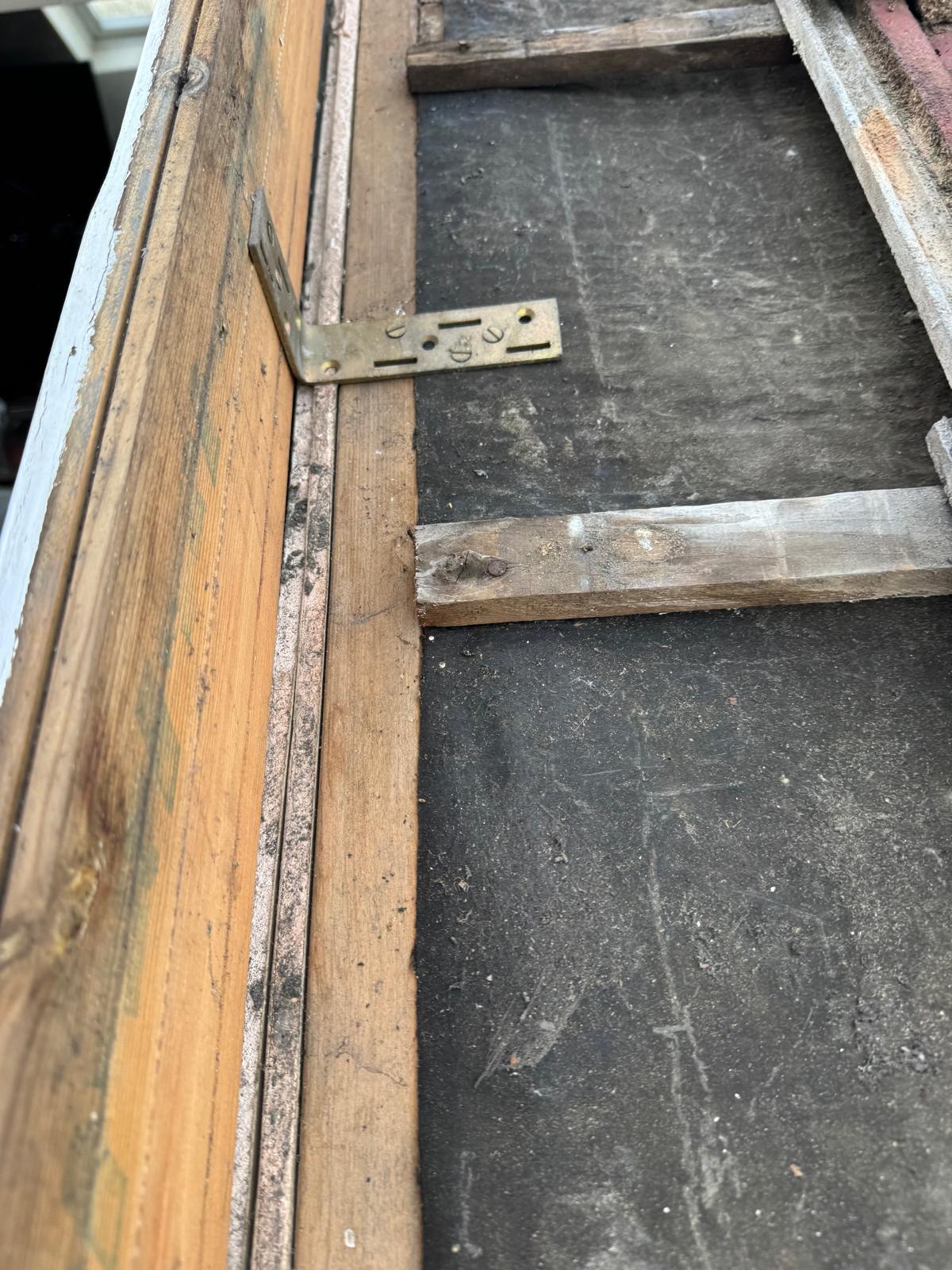

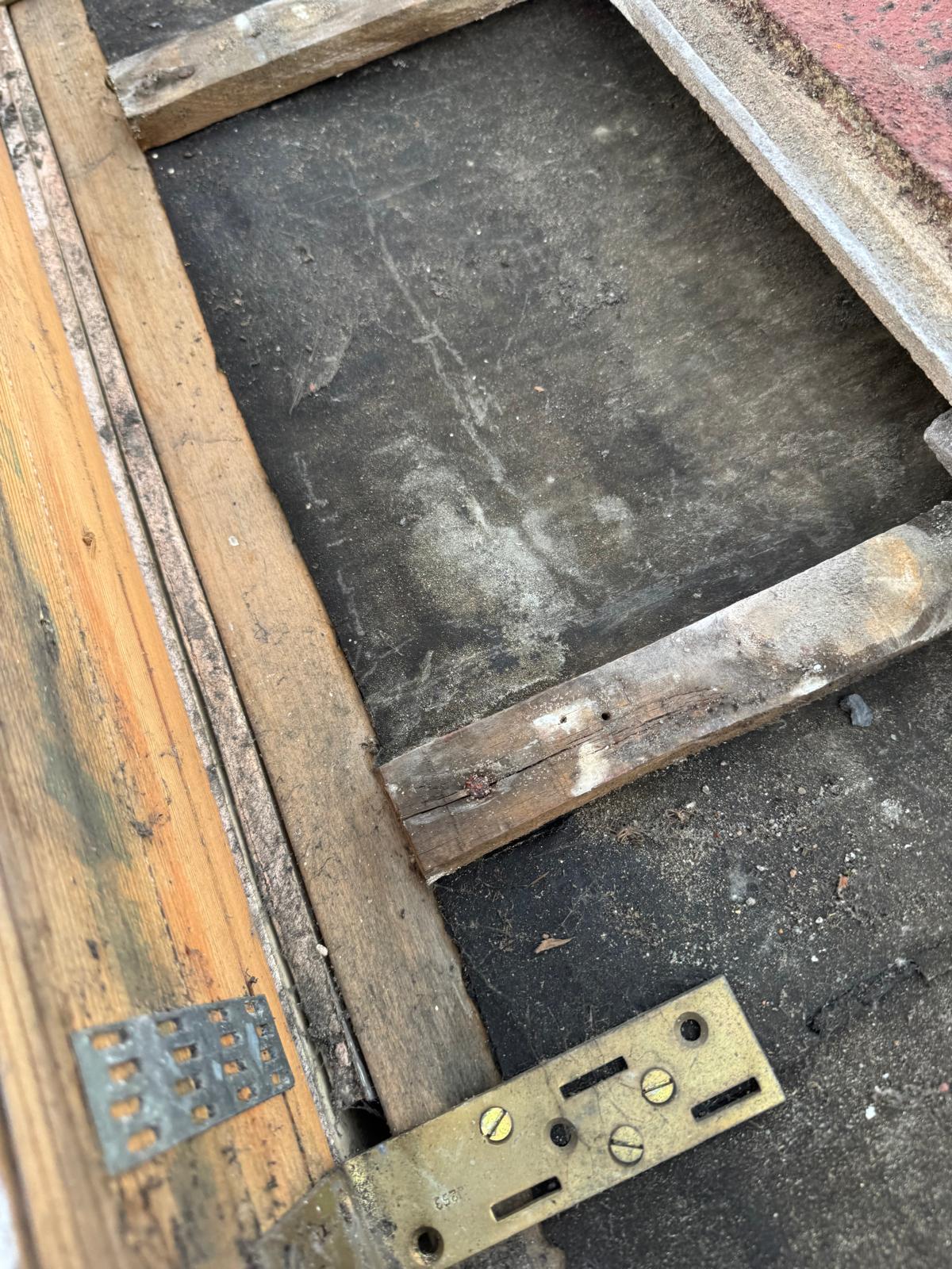

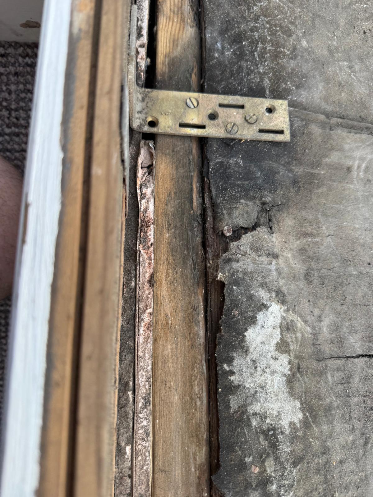

Thanks for the info, I wanted to check if I needed to add battens above and below the window like the newer ones as it currently doesn’t have them
The top and bottom battens are purely for the fixing brackets on the newer windows.
