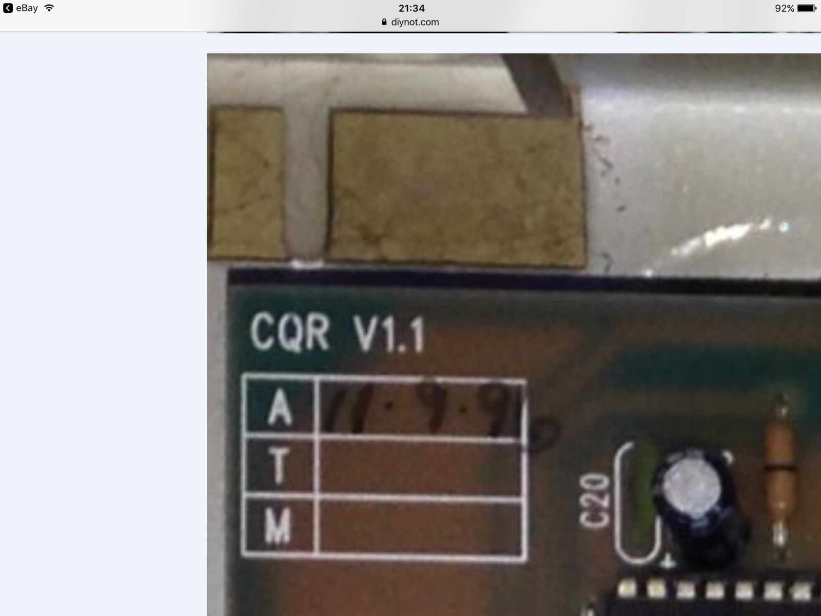

Its old and I suspect many wont support it as they don't have the history, but local alarm companies need to be contacted to find out what options and prices they will offer if any.
Because of the the age of the system he may be better ...replacing the battery every 5 years , testing all the zones once a year or sooner, testing the bell every 3 months amd if any issues contact a local installer to repair ....
Well if he cant find anyone to take it on, he may well have to do the tests and then look at replacing the system if one or more parts fail.
is he really going to test the bell that regularly?

okay, home insurance specs are not based just on the alarm panel, but how it is installed.
The insurance may have very specific criteria ie installed to a certain grade and that would have to be certified and maintained to keep it certified or bells only. A system can be installed to a certain grade, but would usually require certification from an NSI or SSAIB company.
So if someone places a grade 1 contact on a grade 3 system, then system becomes grade 1.
A Texecom Premier Elite would be capable of what may be required along with the appropriate sensors and bell box.
Remember that the existing devices will not be graded .If you do require the system to insurance approved then all equipment would need to be replaced for a graded system.
If graded system is not required then just swap control panel,but I would also change the bell box.
Just get a basic service done , I can't see the point in replacing the system if your moving ! What it may cost you for a graded system upgrade is not going to offset your insurance savings

Alarm battery last replaced 2016 - Tamper switch was bypassed - without telling us. Metal case earthing wire - was disconnected and hanging loose. No walk through test was done. Bell would go off as soon as you enter the house (delay was not programmed in).
Cost for basically doing the absolute minimum - and leaving us with an alarm bell that would instantly go off when we walked through the door - £90 + VAT.

Your photo shows that the incoming earth is connected to the block as well as the earth connected to your transformer.
You stated that the alarm was serviced 5 years ago ?
You say battery was replaced 2016 ?
Who changed the battery if last serviced 5 years ago ?
that's my thoughts ..but it may have just had a battery change and not a service , think the earth may be the panel lid earth ( spade connector may have come off )
